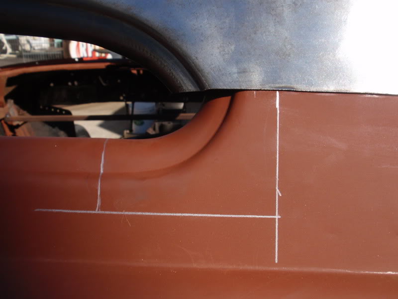

  10. Which area are you concerned about? Send me a pic.
  11. this area.....
  12. You can see how I overcame this in my pics. I lengthened the top. I've studied this and it is about as easy as anything else. Align the center post first. This area will still be out of alignment. Then lengthen the rear section, sliding the top back until the arch of the window opening is lined up. The beautiful sculpted part will still be off but is easily "worked" to align. I heated mine with a torch and hammered the bottom line until it met the upper line. That may be visible in the pics, I'll check. I didn't have to split the rounded part of the top at the rear, it lined up pretty good. Then you can go to the front section. Fun heh???

  13. "I heated mine with a torch and hammered the bottom line until it met the upper line."
    That's the missing piece of the puzzle.
