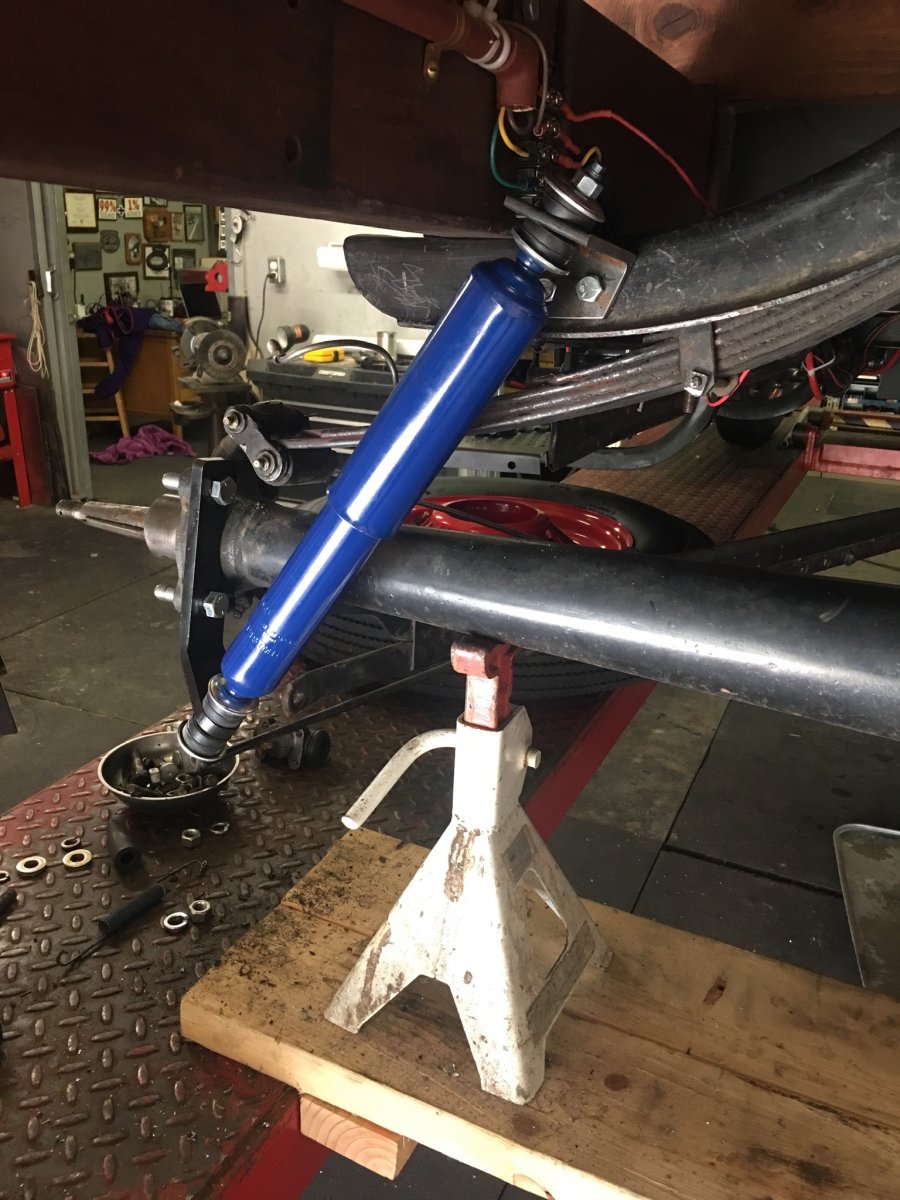

    Finishing a brake job and installing tube shocks B154593A-199E-46A2-995D-591A930BDCD9.jpeg

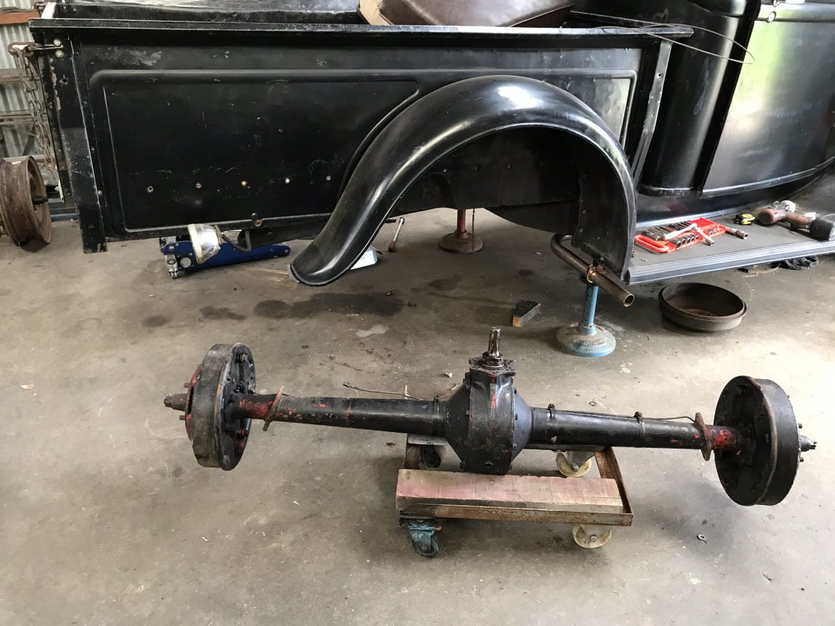

    60D0C3E6-FF41-45B3-8D21-55B04309EB62.jpeg F750AAEA-932B-4CAA-859C-5E8E3B018331.jpeg Swapped in a 35/36 rear with 3.54 gears into the banger 32 today. Relatively straight forward , used 35/36 radius rods shortened about 15” . Used a 35/36 spring with scallops ground at spring perch points to mimic the 32 spring curve with teflon lined spring pack , as these were already in the spring. Juice brakes all fitted OK. Park brake worked great also.
    The original 32 rear had dodgy welded spring hangers , probably from some one cutting them off to fit in a lathe as it had new bearing races on the axle ends. They looked like an accident waiting to happen.
    Think I will need a 17 or 18 count speedo turtle .
    The rear sits approx 1” lower , but the axle moved only 1/4” forward , but visually looks more unfortunately. Though the spring rate feels great and still 4”of travel so able to carry a decent load.
    Nothing is painted fancy as this is how the 32 looks ,used and fun ,ready to haul.

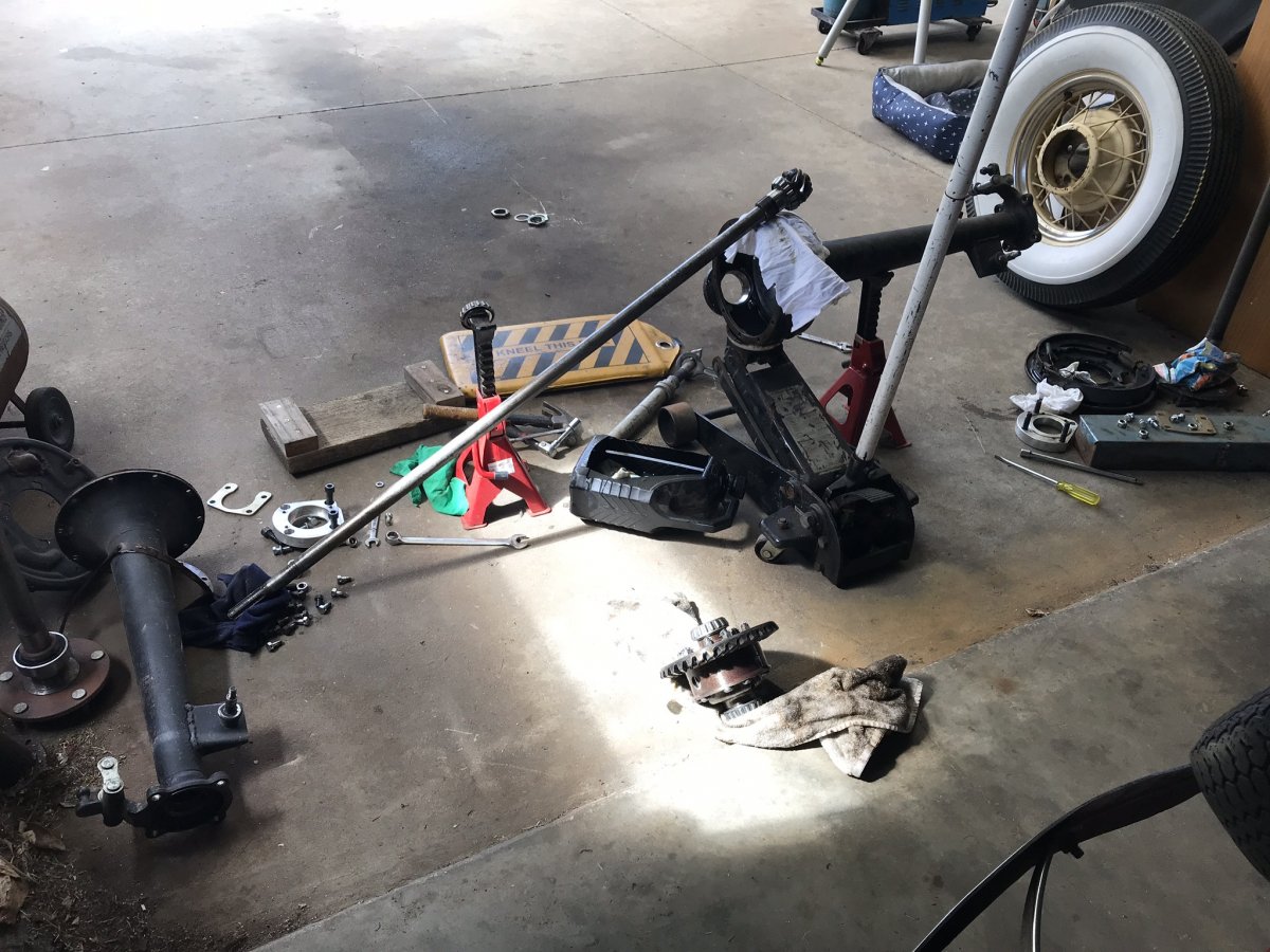

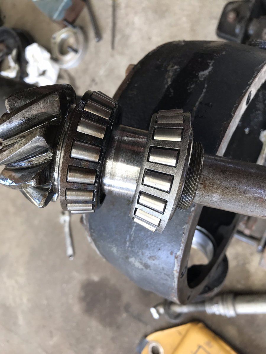

    Posted this in the “what did you do today “thread but thought I’d post it here too,,We dismantled the A diff from our coupe ,,it has a Hot Rod Works centre and axle conversion,,and I am goingto make a solid spacer to go between the pinion bearings so preload is solidly set ,,it will be a bit of muckingaround but may strengthen things a bit wasn’t totally happy with my carrier preload so I can redo and be sure ,,,we are running a 3.0 mercruiser so it will have a little more sting ,,my local diff guy recommended this spacer ,,,still closed drive connected to a late 3 speed all synchro top loader with a t150 Jeep shift,,

    how does that spacer affect the races in the diff ? how does it affect pre-load ?...……… steve
  23. RoddyB34
    Joined: Oct 13, 2009
    Posts: 542
    RoddyB34
    Hi Steve ,I presume the spacer will do the job like a crush washer does in a late model diff when collapses down to achieve desired preload and support for their pinion bearings ,,the high powered guys use a solid spacer and shims between bearings to avoid crush washer collapses ,,what are your thoughts maybe I’m overthinking this ,,
  24. V4F
    Joined: Aug 8, 2008
    Posts: 4,127
    V4F
    from middle ca.
    looks like a one time set . I presume you use shims . really cool idea ………. I still have the "A" diff , so I use inch pounds for preload ……..
