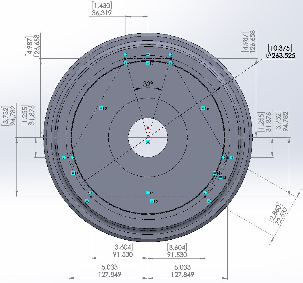

    Pressure plate has a 6 bolt pattern divided up into 3 groups of 2 with a 2.860” center to center. Sorry I cannot find the PCD .

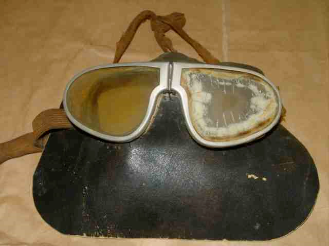

    Just found my mask......

  4. I posted the drill pattern on the fordbarn a while back. Here is the link. https://www.fordbarn.com/forum/showthread.php?p=1269146#post1269146

  6. Had our quality technician at work measure it in our (metric, but still...) 3D-measuring machine, so I'm pretty sure of the accuracy of the holes in the pressure plate. But despite spending 1,5 hour friday trying to adjust the measurements, and converting them to imperial, I kept getting at least one hole off the PCD. Only by a little, but enough to annoy me...
    Based on the referred post on Ford Barn, it should be 10,375". :) Thanks for the first measurement, @97.
    Thanks a bunch, @62pan! This was exactly, what I was searching for! You just saved my day! :-D
    So, in the spirit of helping out, here is a screen shot with both [imperial] and metric dimensions: clutch diagram bolt_dual.JPG

    After seeing the drill pattern from 62 Pan I realised that the information I had was incorrect... the distance is in fact 2.860. ( Not 2.830) . Just shows how things can go wrong .
    I lifted that info directly from the website of one of the big suppliers yesterday...and now I cannot find which one, although I suspect it may well have been Speedway...my apology for putting you out .
    One would think that critical information like this would be checked and verified before a large international business listed it on their primary advertising platform? I have corrected my post so that the error does not compound in the future.

    jim , what were these used for ?

    An old friend raced the prewar IMCA fairground series..... This was his face mask.

    very cool jimski , thanks
