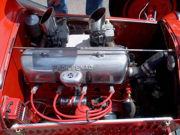

  15. OOOOOOH! November banger porn... and it's only the second day of the month!

    That Frontenac is too cool, just had to wipe the drool off the keyboard! A guy I work with asked me if I wanted a Model A short his dad had built. Free for the taking. He thinks it still runs. I will be going after it! Will post a pic or two when I pic it up.
