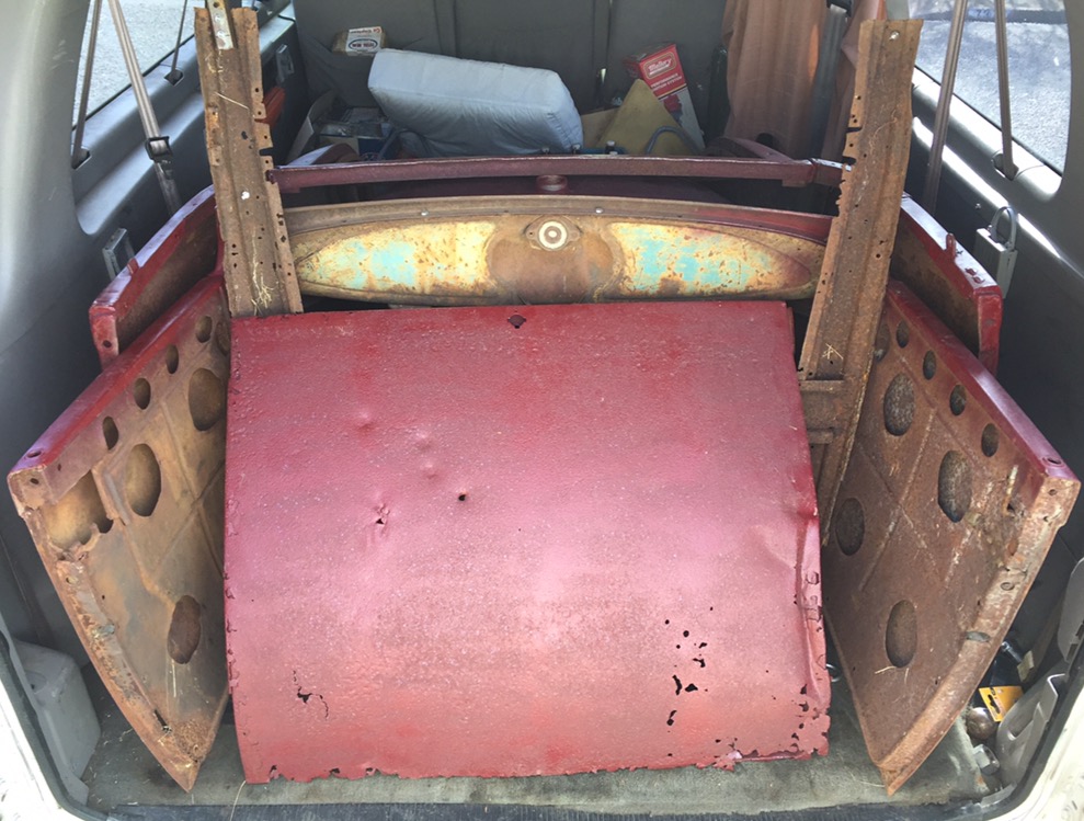

  1. I'm in the process of turning this:
    into something more like this:
    Yes that's the same body, and it is BEAT up!
    I've never ground-up built a hotrod by myself before, though I've finished builds and had a (large) hand in some complete builds done by a local rod shop.
    This body is wasted, and bringing it back is going to really challenge my sheetmetal skills (which are mostly non-existent).

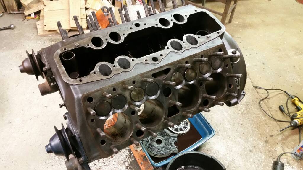

    Also, I'm building my first flathead V8 for this little roadster at the same time. It should be a fun little AV8 when all is said and done. Perhaps I'll post more pics as I go...

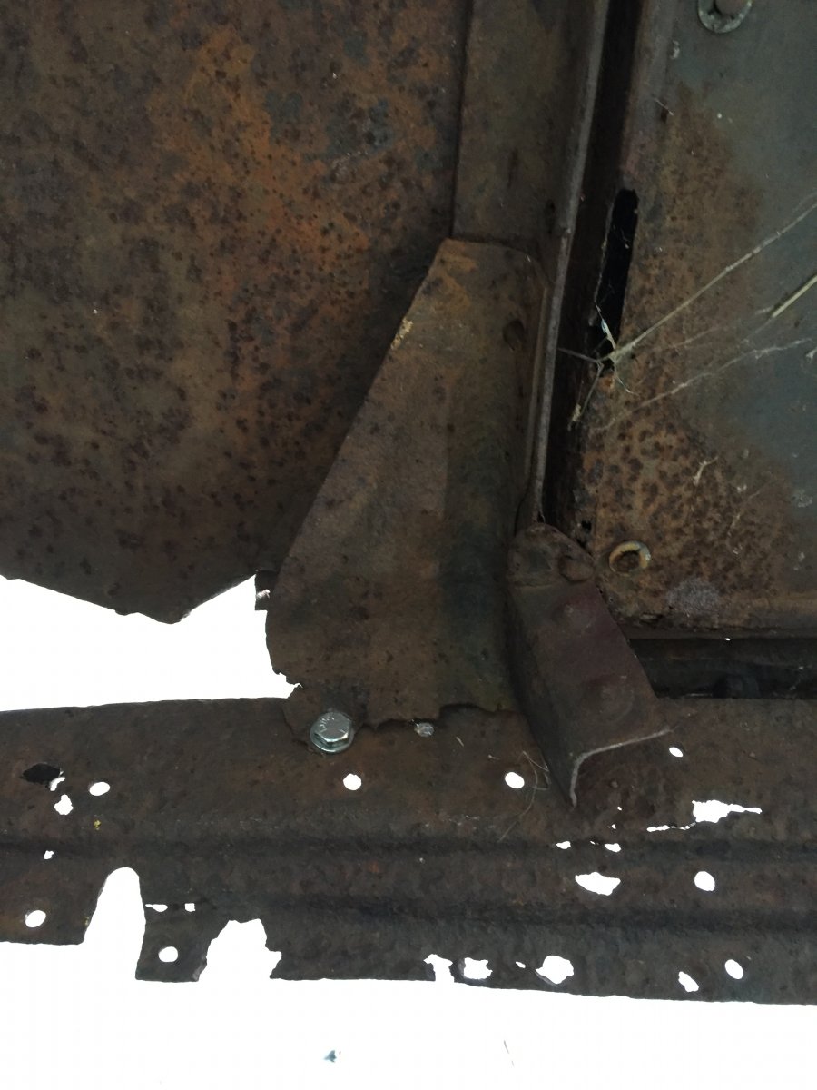

    Casey...the sub rails stacked in first pic look pretty substantial. Sand blast 'em and use some of that Argon on the extra holes. Do 'em right there on the bench, one at a time.
    Follow a couple of threads on the '28-9 roadster bodies during patching AND attaching to sub rails.
    Slow, careful cutting and matching up of patch panels (and misc. 'strips' of A-K 20 gauge steel) will match up nicer than you thought. Butt weld, careful tacks. You knew that...
    Just 'doing it' takes some bravery, only just at first. The whole car looks dismal, but it's like...eating an elephant. True.
    I'd love that project...Typical California guy's street A-V8, 1942-1946...
  6. You've got to get some light behind those subrails to see how shot they are, but they're replaceable. I agree with your sentiment that is, I'll learn as I go...

    Second glance tells the story... I have some T sub rails that are like that...good 'patterns'.

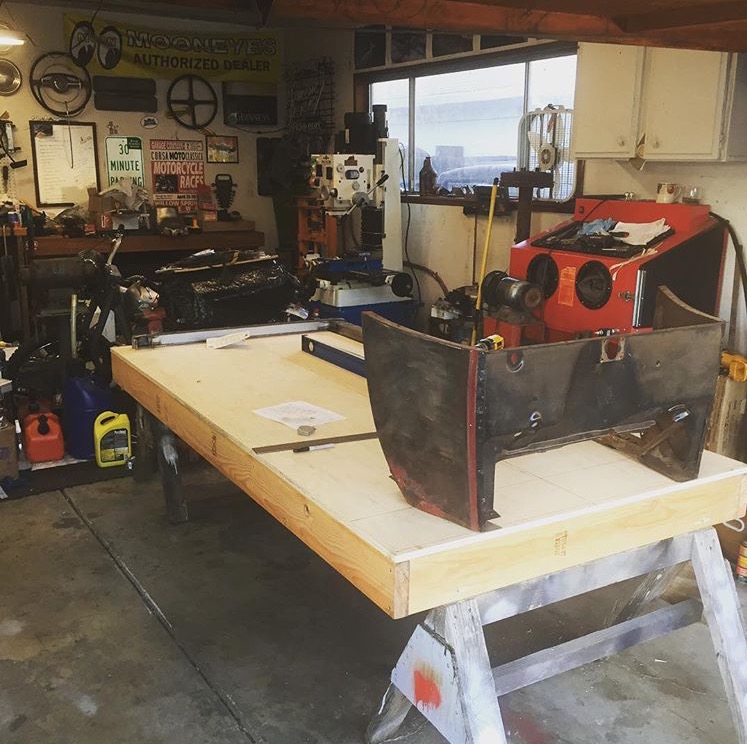

    On my day off I built a really nice table to lay the body out on. I used a 3/4" sheet of hardwood ply on a 2x6 frame so it's square, flat, and sturdy. I figure once I plot out the body mount locations, I can anchor the subrails to the table, and if I'm diligent in moving my tacks around, I can get the body built without much movement/warpage.

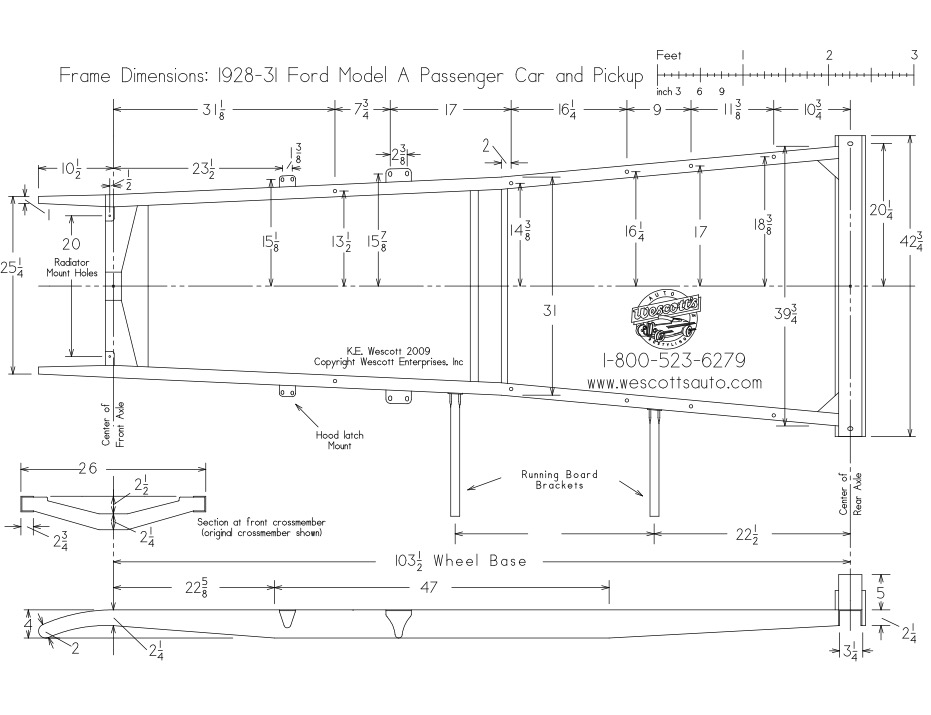

    Using Wescott's blueprints, I plotted out the first 6 body mount holes and set my cowl up on the table. Not even close! I decided to dig a little further, and so I went and measured both of the Model A frames I could get to out in my yard, and found every dimension on both frames to be off +/- an inch from the blueprint...so I guess they're more of a suggestion.
    I ended up painstakingly measuring the frame that's going to eventually live under this body, and the next free evening I get I'd like to get out there to plot out the correct holes on my table and start laying out my subrails.

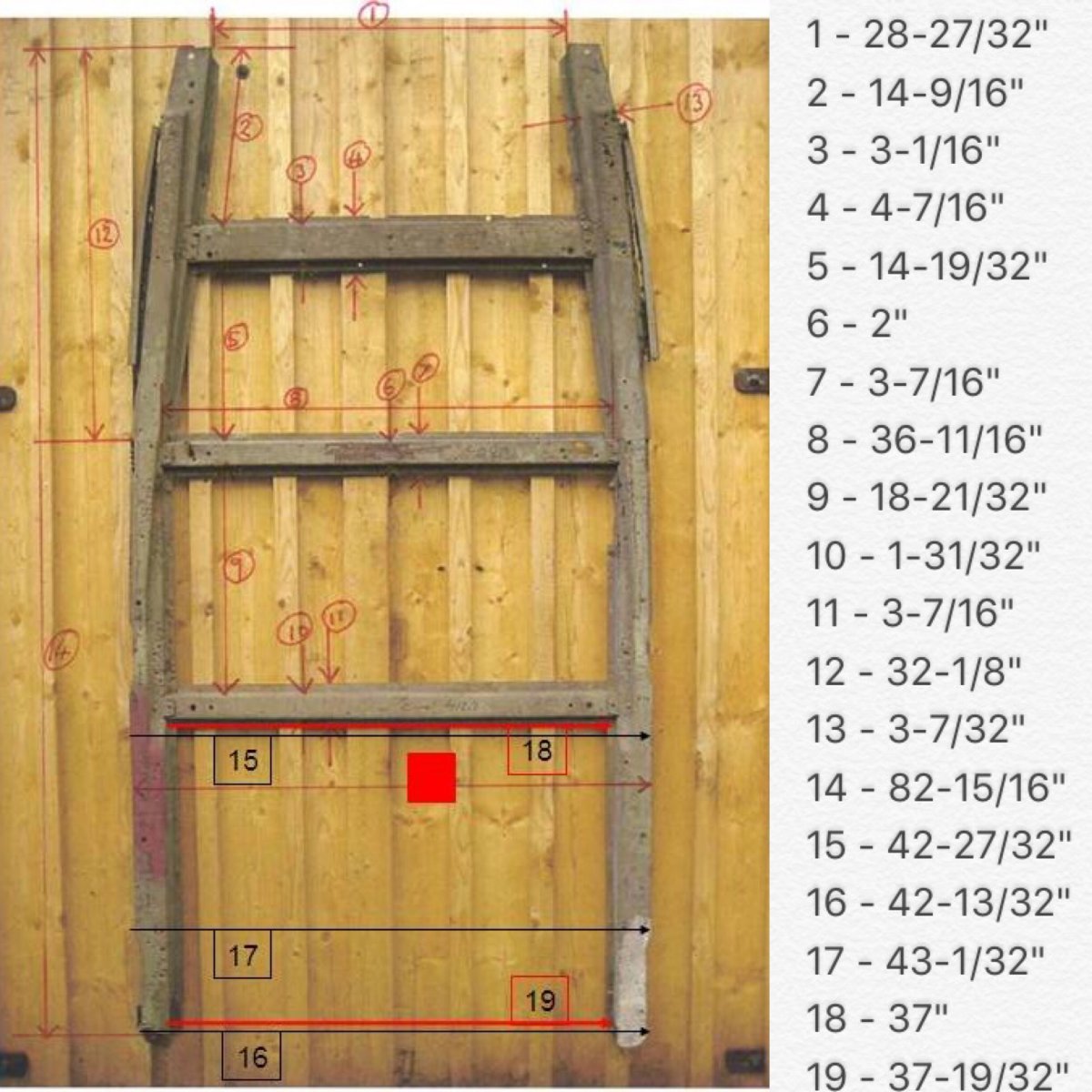

    In the interest of hopefully making this thread useful to any who'd find it, I'm also including this image, pirated from another HAMB thread by @Brendan1959 and @Flatred53, and updated by yours truly to fractional measurements. I have NOT compared any of these measurements to what's left of my own subrails, yet, but will post my findings when I do. Hopefully between two A frames, one blueprint, this photo, and a wasted pair of subrails I can figure out where, approximately, things should go as I lay out this body...
    Wish me luck, HAMB-fans!
  24. Not all body types use the same mount holes in the frame, four door bodies use some holes, pick-up body use other holes, roadsters may use another set of holes. I would guess that the frames are drilled to accept any body but may not be. Wish I could be of more help and able to tell you what holes should line up but I'm at work now and don't have the book with me.
    48fordnut and crazycasey like this.

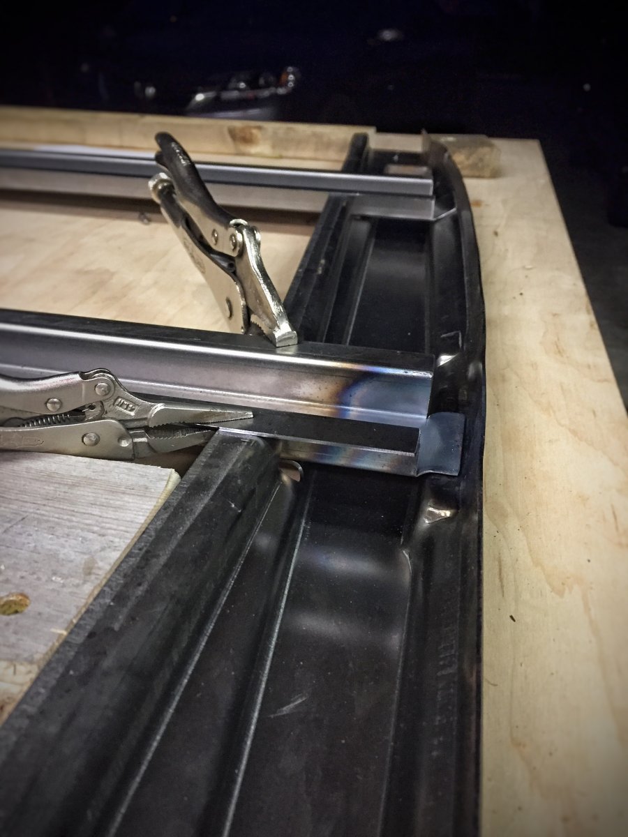

    One of the biggest hurdles was going about just how I was going to get the subframe assembled and square without really having a whole lot to go off of. Studying the subrail picture I posted earlier, and the remnants of my mangled subrails, I came up with some more "correct" numbers, and I will post those when I can update the image, but, basically, using my centerline, I screwed 2x4's to my "body jig" table to set the rails up against, and then locked the rails in tight with some strategically placed 2x4's along the outside.
    Once I had the rails situated, I flipped them over (guess what, they're not exactly mirror images of each other), locked them back into the "jig", and went about cutting and shaping the cross rails to the subrails.
    Tomorrow (hopefully), I can flip everything back over, lock it down, and set the cross rails in place final final. When I get that done, I'll fix the graphic and post all my measurements...and hopefully when it comes time to hang all my body panels they'll actually be right!
