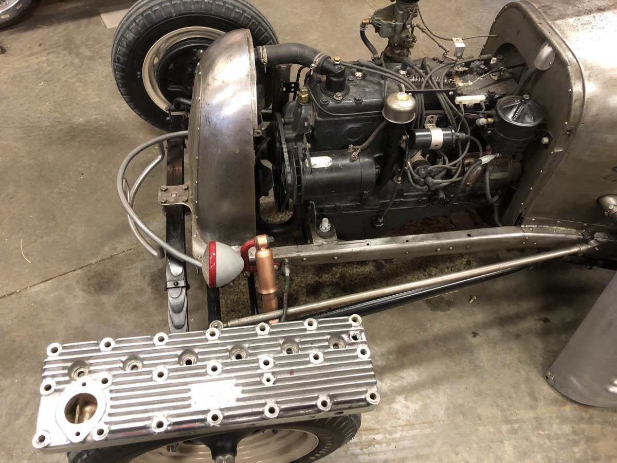

    Man I love flatheads was freshening my 8ba up yesterday for all the vintage drag events coming up. Hope my new bigger flatty will be done for summer though.

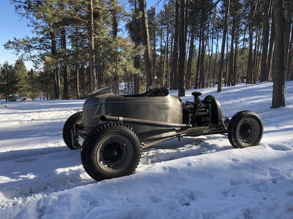

    There more than one flathead! FBB67923-A3F6-4110-BDCC-6FD0953E46F6.jpeg B1DD398C-1635-4153-8C63-3C051F96B7E2.jpeg
