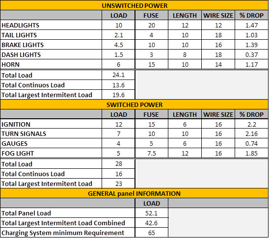

  4. I've been slowly tackling the electrical.
    From learning and doing all the calculations, loads, fuse voltage drop, etc to learning how to properly crimp/solder terminals.
    Anyone attempting to do electrical should read this thread, https://www.jalopyjournal.com/forum/threads/wiring-101.843579/
    Some great advice in there!
    I might be running a bare bone system but it feels good to learn and know that it will work

    I am waiting for one more wire and the fuse panel will be done.
    I crimped every connection, added a drop of solder over the connection and heat shrink tube every wire to make sure if doesn't come undone.

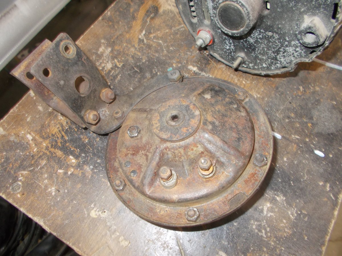

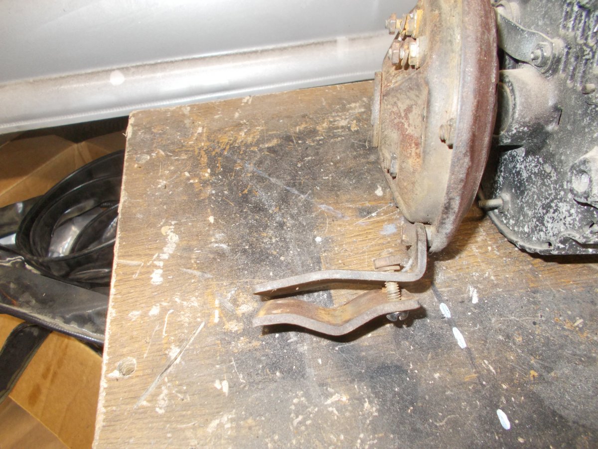

    helped a buddy sell a '32 tudor… gave me a box of stuff... had this horn...
    gonna look great on my sportster...
    thanks for the pic...think I will mount it where your light is... go dice go !

  20. That's a nice looking horn. Any idea what car it came from?
    I still haven't found one for my roadster, or a place to put one....maybe when the car swap meets open up again.
    I have vintage 12 volt siren that I am tempted to put on the back somewhere bolted to the frame and out of sight....it is loud...

    I thought it was from a bike... vintage bike guy says if a Harley or Indian would have the name stamped into the flat washer on the back... he thinks it is a '20s mopar… cool by me...
