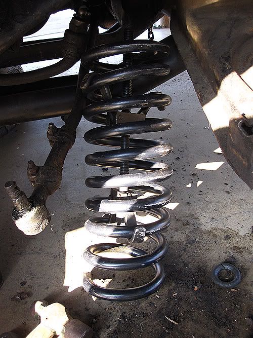

    here are the photos i took. the idea of taking it to a shop is sticking in my head quite well actually. i'd appreciate any feedback as to whether or not i should just have them use a hydraulic compressor and strapping it up for me, then putting them in place?

    I have rather serous doubts that you will be able to compress the 18 inch tall springs enough to be able to even get them in place to be able to put the thing back together.
    12/13 you would have a battle on your hands but it might be possible. I had a lot of springs in and out over the years I did front end work and just don't see this as being one those things that you will be able to make work. If you do get it together you most likely won't have any suspension travel and the suspension will be topped out all the time.

    i have that same spring compressor. i like it because it feels like it grabs pretty good. lube the threads. i avoid impact just because i like to take it slow and watch and listen. it makes that crazy nervous feeling last longer, but it feels safer.
    with that spring compressor, i usually take the sliding clamps off, send the long bolt down the shock bolt hole with a couple grade 8 washers. put the spring into the upper pocket. then, use only the threaded clamps and tighten the spring up into the upper pocket. using only the threaded clamps and shock bolt hole, i'm able grab a lot more spring and get more compression travel.

    Drop the bolt (from your spring compressor) down through the top where the shock would normally bolt up.
    Install spring into top hat and hook the bottom (or the lowest coil you can grab) of the spring with the threaded thingy with the hooks on it. Use common sense here, one hook is longer than the other.
    Tighten bolt to compress spring to hold it in place. When you tighten this you are pulling the spring up against your frame, if need be make sure it is clocked correctly to line up in your frame and/or your control arm.
    Tie a floor jack to your frame rail with a chain and place floor jack under control arm and raise jack until it touches control arm. At this point, if you haven't already, make sure that your car is well supported on appropriate jack stands and maybe some extra wheels and tires under the car as well as a fail safe. Remember hope for the best and plan for the worst.
    Keep tightening the spring compressor until you can bolt everything together while keeping the control arm up near the spring with your floor jack. This minimizes the chances fo spring flying out into space if your compressor comes apart and the chain keeps the car from launching off of the floor jack if the compressor comes apart. You can use the floor jack to help it along as needed.
    Sometimes it takes a couple of guys to help. They can keep an eye on things while you are concentrating. In extreme instance we have used 2 and sometimes three prybars to push the spring into pocket on the control arm, extra hands really help here.

    After looking at what he took out, I'd think that the set he took out had been cut down some so I'm probably going to have to back up a few paces on that one.
    I'd do it pretty close to what Dontliftoshift said in his post above. Pull the spring up into the pocket and then jack the A frame up to it.
    I hope the car has the engine in it because you really need the weight of that engine pushing down to help things along.

    IF this has a shock in center of spring, remove lower arm, use allthread and/or internal spring compressor to compress spring into frame then install lower arm, (I hate seeing coil springs tweaked espcially when they bow and aim towards your crotch). The lower arm method has worked for me well and for years, leave the balljoint end attached if desired, then all you need is floorjack with chain wrapped around frame and floorjack to act as press to compress the remainer of spring height, if not a center shock assembly still use the floorjack and chain but be careful. Again, I have never had a spring "haul ass" using this method of removing lower "A" frame.

    i should probably update this thread guys. i got the coil in there without using an impact gun or anything.
    i did however cut a coil and a half off the new larger one. so i can compress it as much as possible. and i got it in there by myself and a lot of cussing and sweating and a lot of praying lol.
    only problem is, part of the arms on the coil compressor are still stuck in there :(
    please tell me i can get them out somehow without taking it out again.
    just one arm is wedged between the coil and the lower a-arm.
    and just one arm is stuck on one of the upper coils buts hard to reach. ive been hammering away at it but no luck, i was tired after i got it in there.
    either way, its in there, and the other side better be easier.

    Second sides always go easier :)
    Are your ball joints secured and spring extended to try to get tool out?
    Jack car up by frame until wheel is off ground or a-arms hang to get full extension while installed to try to get tool out.
    If that's not enough, and you have full weight in car... Block frame up high, put floor jack under lower a-arm, jack up just a bit to relieve pressure from bj, disconnect ball joint, slowly and carefully lower a-arm to extend spring further (but not so much the angle won't seat spring). This will give you more extension to get tool out. reverse procedure.
    If that doesn't work, cut the tool out?
