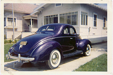

    Funny, when I bought my '39, I started thinking about colours, I was thinking either Purple or '59 Buick Lido Lavender(pretty much metallic pink), but I couldn't visualize the Lido lavender, so I was pretty much set on a purple something like this.
    Then I saw this...
    So, I aint gonna call it Pink, Its Lido Lavender DAMMIT!:D
    Black is for total wusses..."Oooooh, I'm scared to pick a colour, ooooh, I'm so chicken..."
    Same colour in sunlight...uh-huh, yup, its PINK...
