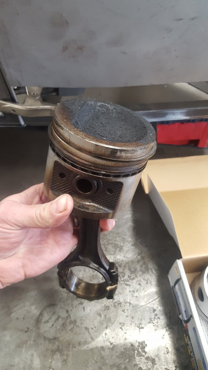

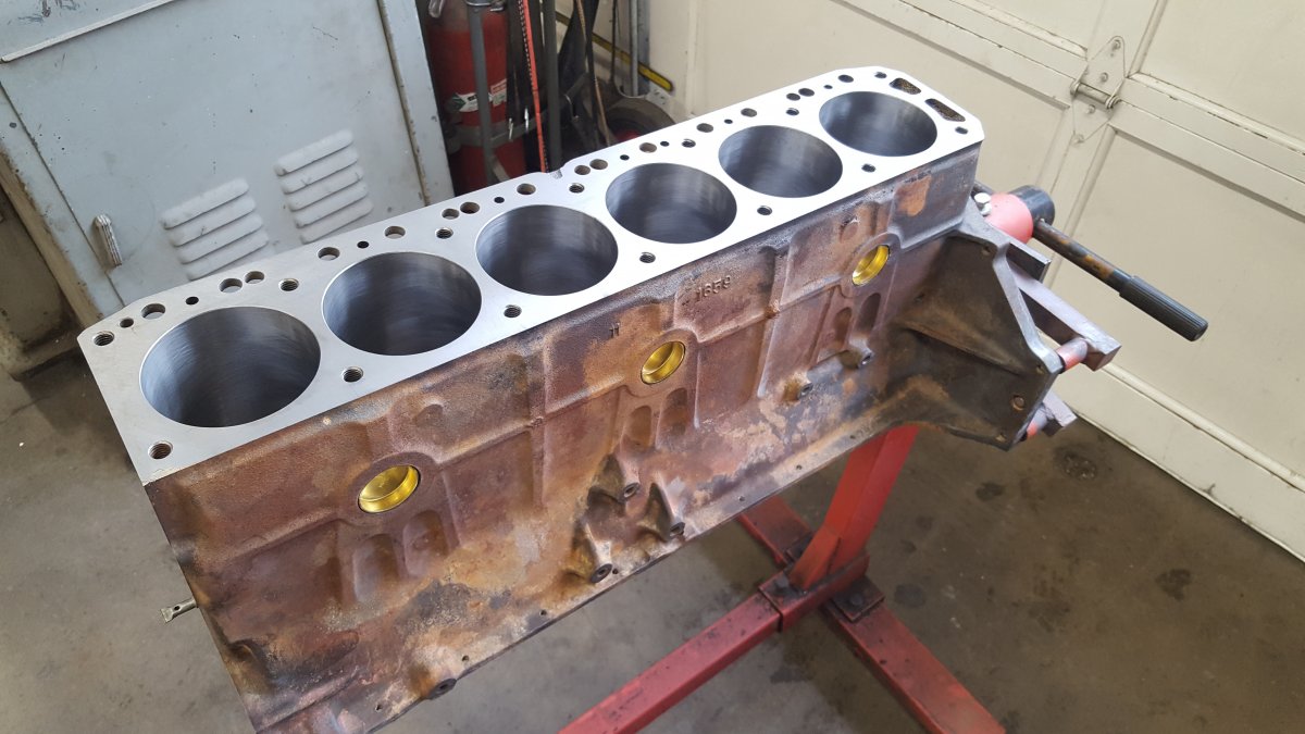

    Long time no post, guess we took a bit of a Hiatus but we're back on it now. Plans have changed on the 292 for the first dragster, one of the guys hooked up with an old Roundy round racer that used to run 292 s, he donated us a set of flat top pistons and rods as well as some other valve train parts.

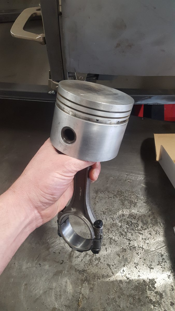

    Here is the new setup as we got it back from the machine shop where Fred at K & F performed a little bit of work to the wrist pins, Recon the rods, and installed ARP Rod bolts. Not sure of the Piston manufacturer Fred says they are a forged piston although not the highest quality. Good enough for who it's for. Also the connecting rods seem to be a chromoly unit.
    Another Stroke of Luck the new motor happen to have a steel crank that was at 10 10, and is in wonderful condition. Just required a little bit of Polish work. Fred decked the block Square to the crank line and set the Pistons .005" below the deck surface. We still need to CC the heads after we get the bigger valves put in, but initial calculations are putting us somewhere close to 12 to 1 compression ratio.

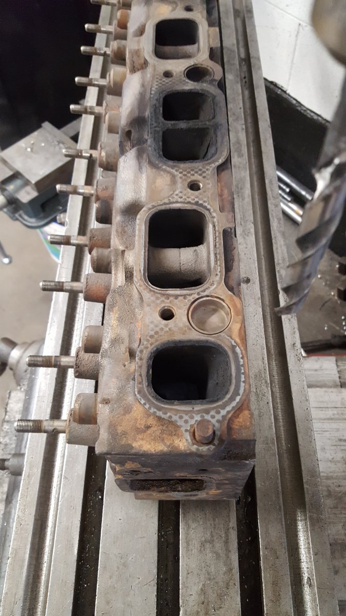

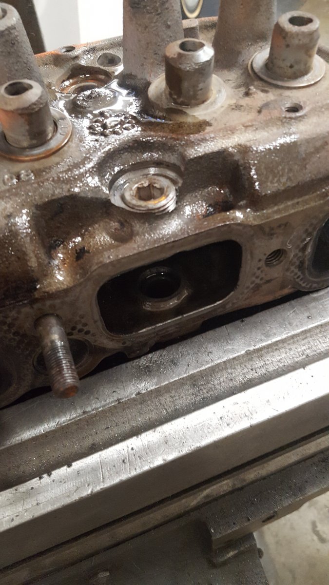

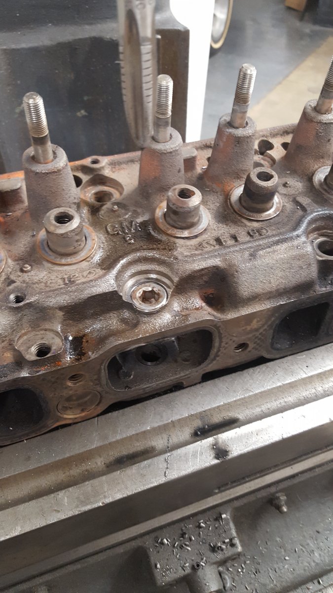

    Next we turned our attention to the head off the new 292, setting it up in the mill to remove the head bolt tubes out of the intake runners
    Starting to fit the lump ports
    Threaded the valve cover side for half inch pipe plugs where the head bolts used to go through.

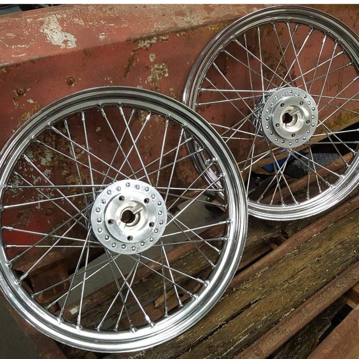

    Dad and I machine. Up a second set of Harley wheels for the second dragster just like we did for the frameless model a build thread we have going. If someone has an extra set of model A spindles with bearings and races we could sure use them. Screenshot_20180119-135802.jpg

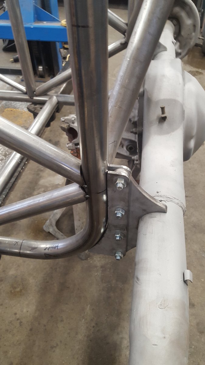

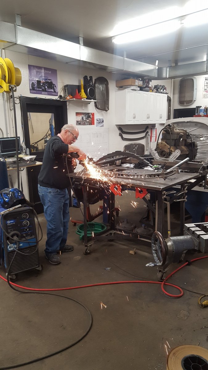

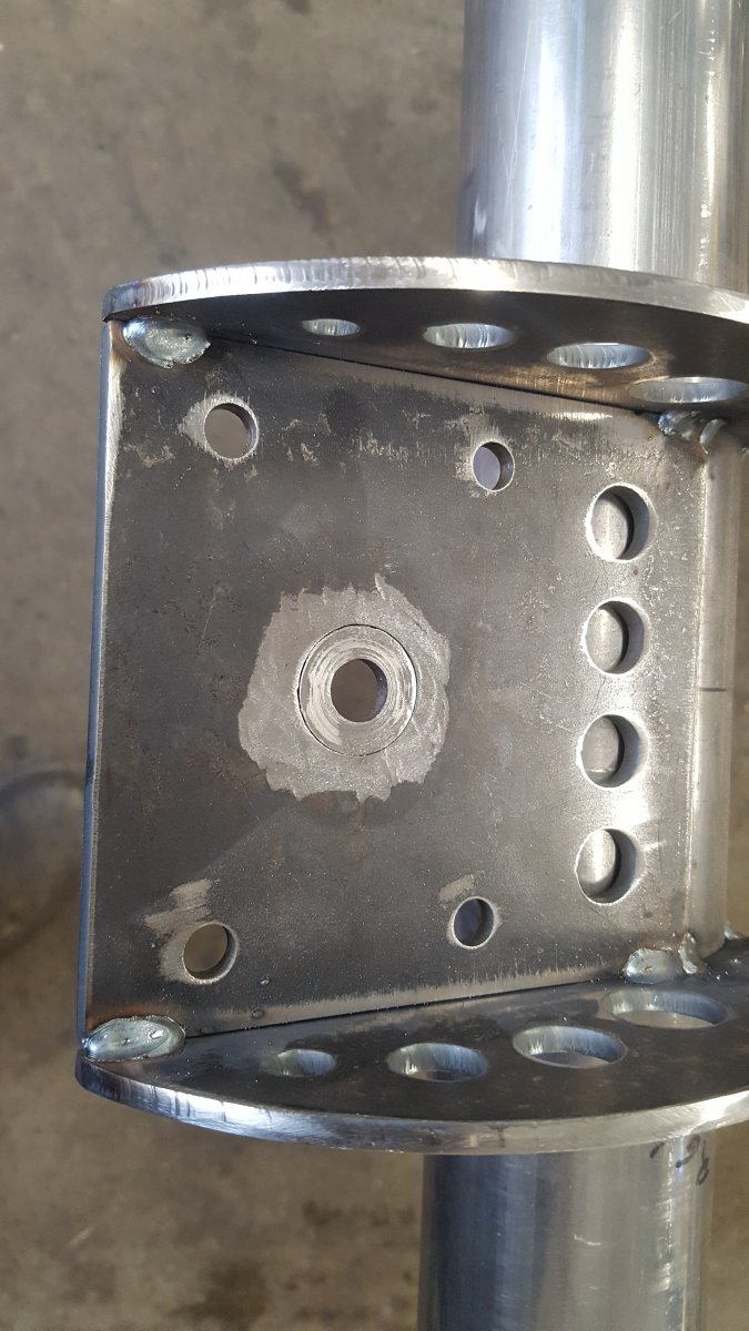

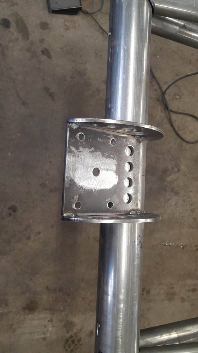

    Not sure how many beers we had last year when we tacked on the front spring mount but the center bolt hole was cut out to 1" ID....????
    Spun up a spacer on the lathe.
    Burned it in with the tig,
    Blended like it never happened.
    Wayne looking for the weight advantage....(might have been just blending the forging line)

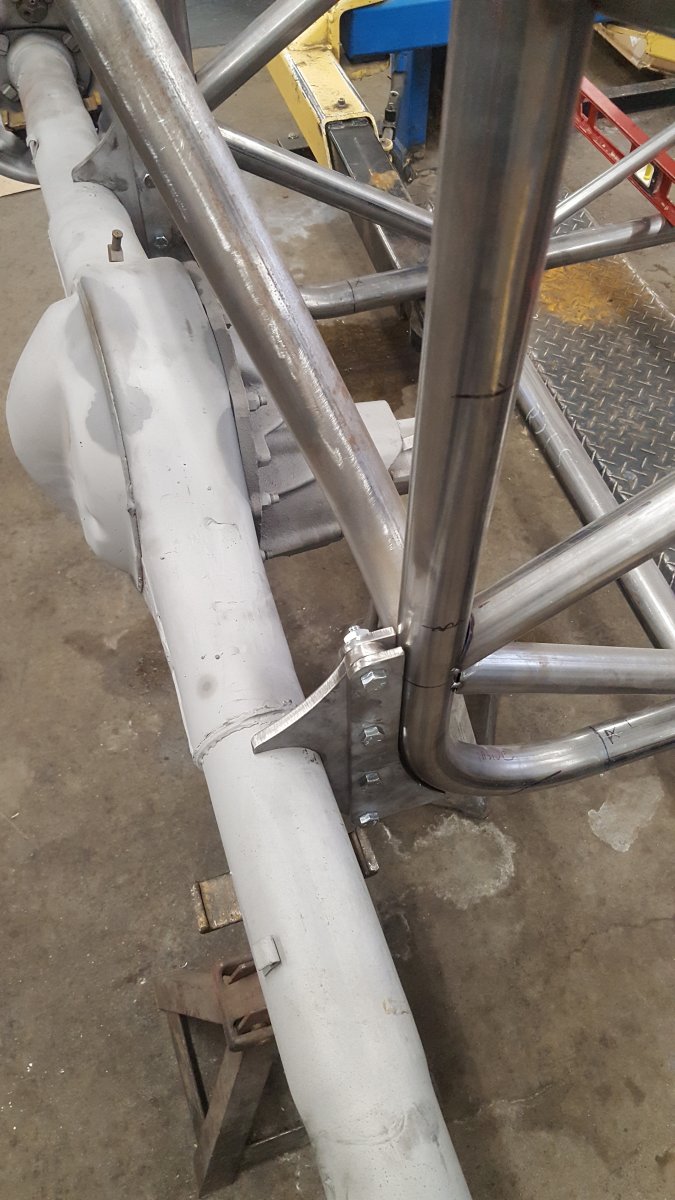

    Then we jumped on some rear axle brackets. kind of fun this year as you just hit the go button and the plasma bed cuts one out, no design time.

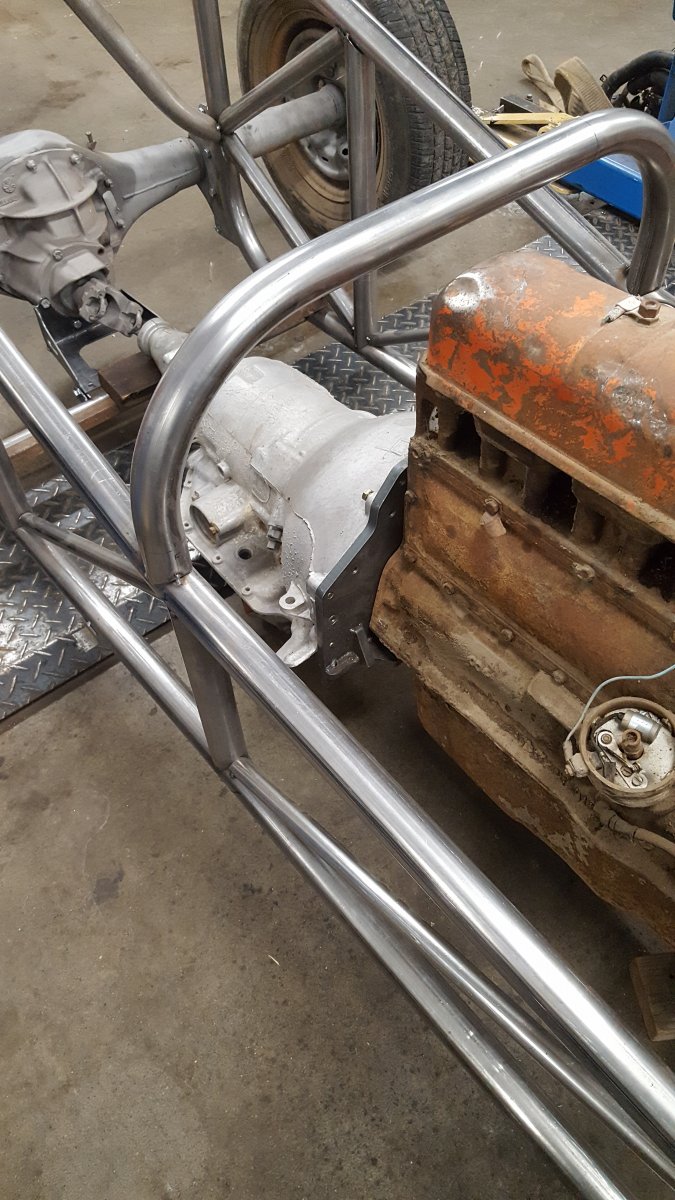

    Next step we installed the adapter with the hydramatic transmission. Then off to a little mock-up. We will need the drive shaft completed this week in order to set the motor.
    20180220_203949.jpg 20180220_193812.jpg 20180220_193806.jpg 20180220_193819.jpg
  24. 1-SHOT
    Joined: Sep 23, 2014
    Posts: 2,702
    1-SHOT
    from Denton
    Looks like all you need is a long slip yoke and a U joint.
  25. Old6rodder
    Joined: Jun 20, 2006
    Posts: 2,546
    Old6rodder
    from SoCal
    1. HA/GR owners group
    Beat me to it. :rolleyes:
    Perhaps consider moving the rear end and engine toward each other just enough to bring the U-joint ears together?

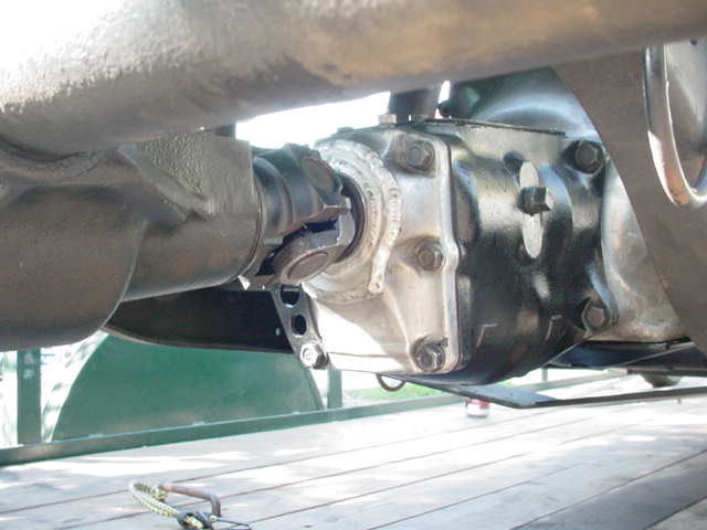

  26. rottenleonard
    Joined: Nov 7, 2008
    Posts: 1,994
    rottenleonard
    Close what we are going to use is the center part of one these jet boat couplers. download (1).jpeg
  27. Old6rodder
    Posts: 2,546
    Old6rodder
    from SoCal
    Nice. I'm using a flanged ear set like that on the right to adapt a B&T to a Spicer on a street bucket I'm (re)doing.
