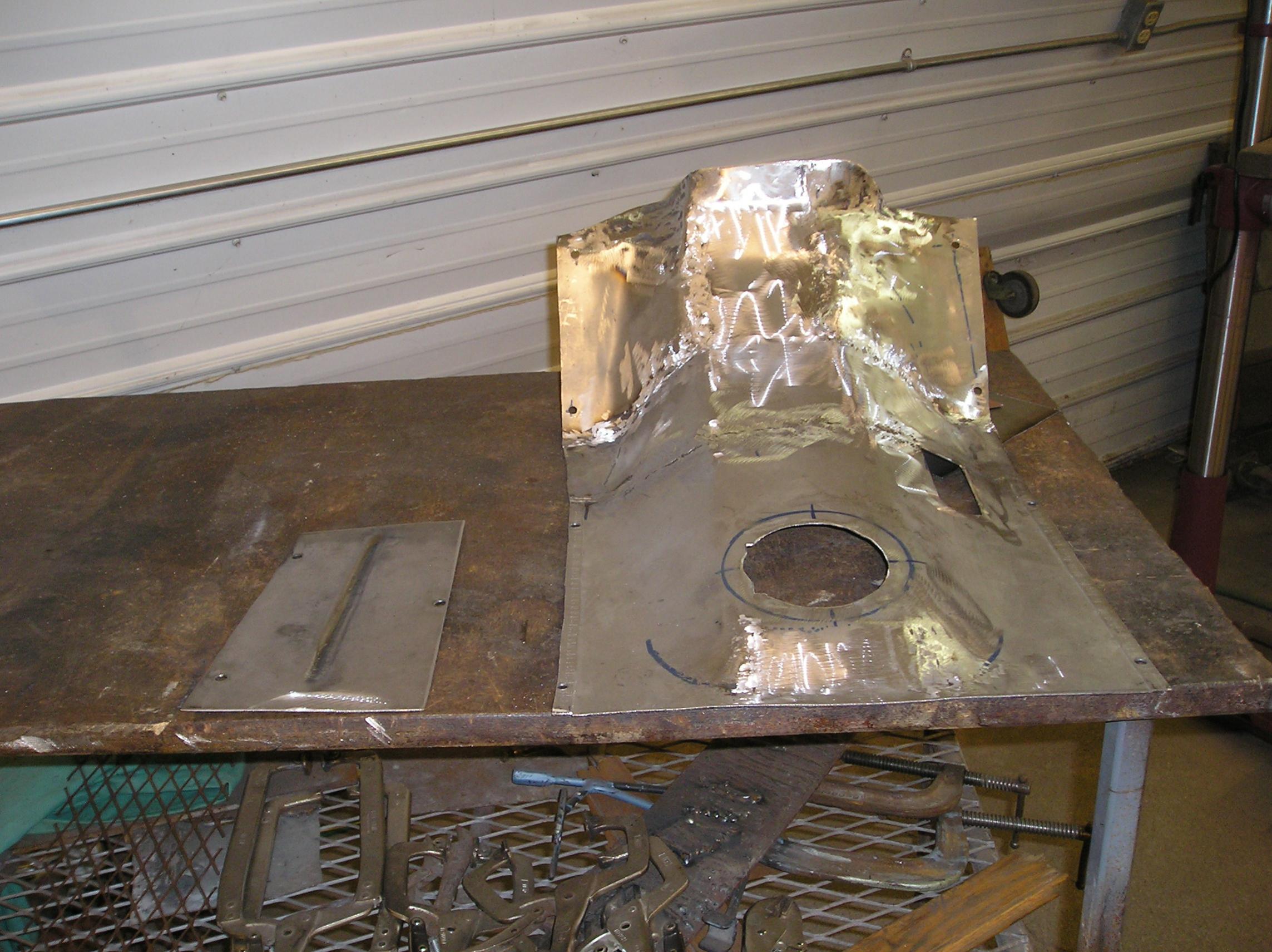

    I Built a transmission hump and it actually turned out pretty nice, considering who built it, lol. The next time I start thinking I'm a good metal worker I will just think about this simple hump project, that should bring me back to reality, lol.

    Thanks Chopt top, the hump will look perfect under carpet, lol.

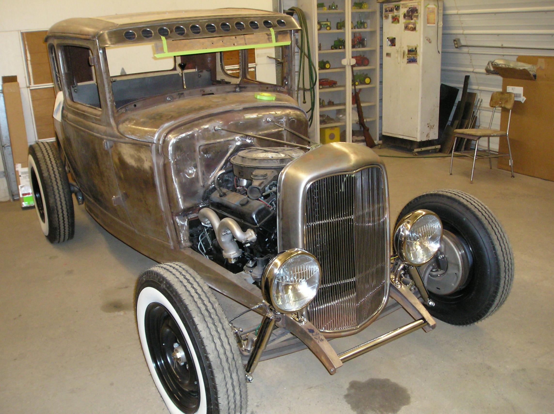

    Made some 3/8 rods to hold the radiator, and lowered the grill shell an inch and a half, looks better that way.
    I put a little light on the situation, or should I say some big lights on the situation.

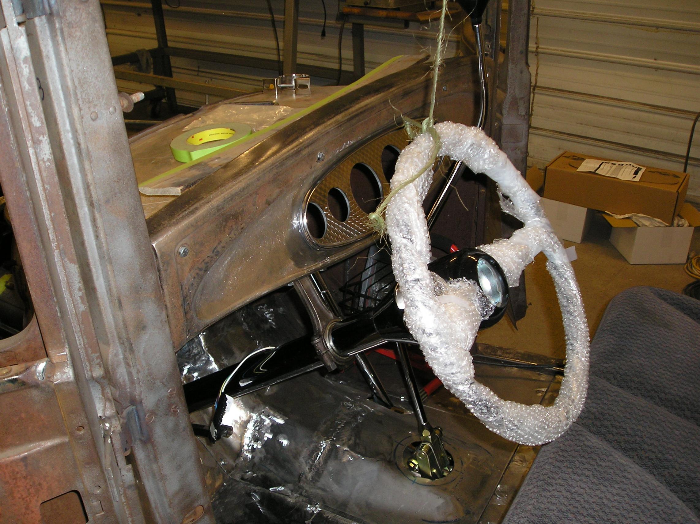

    Thanks, did a little work to my dash. I found that a 283 connecting rod with a 2 inch crank is the perfect fit for my 2 inch column .
    I decided to put in a column with a self canceling turn signal because it might be too loud in the car to hear the little clicking noise:p

    Thanks, I finished the steering column mounting by bolting a piece of sheet metal to the floor with a hole in it and a nice wide metal tab. Then I just put a hose clamp around the tab and column and it's nice and tight. very easy to remove the column too.

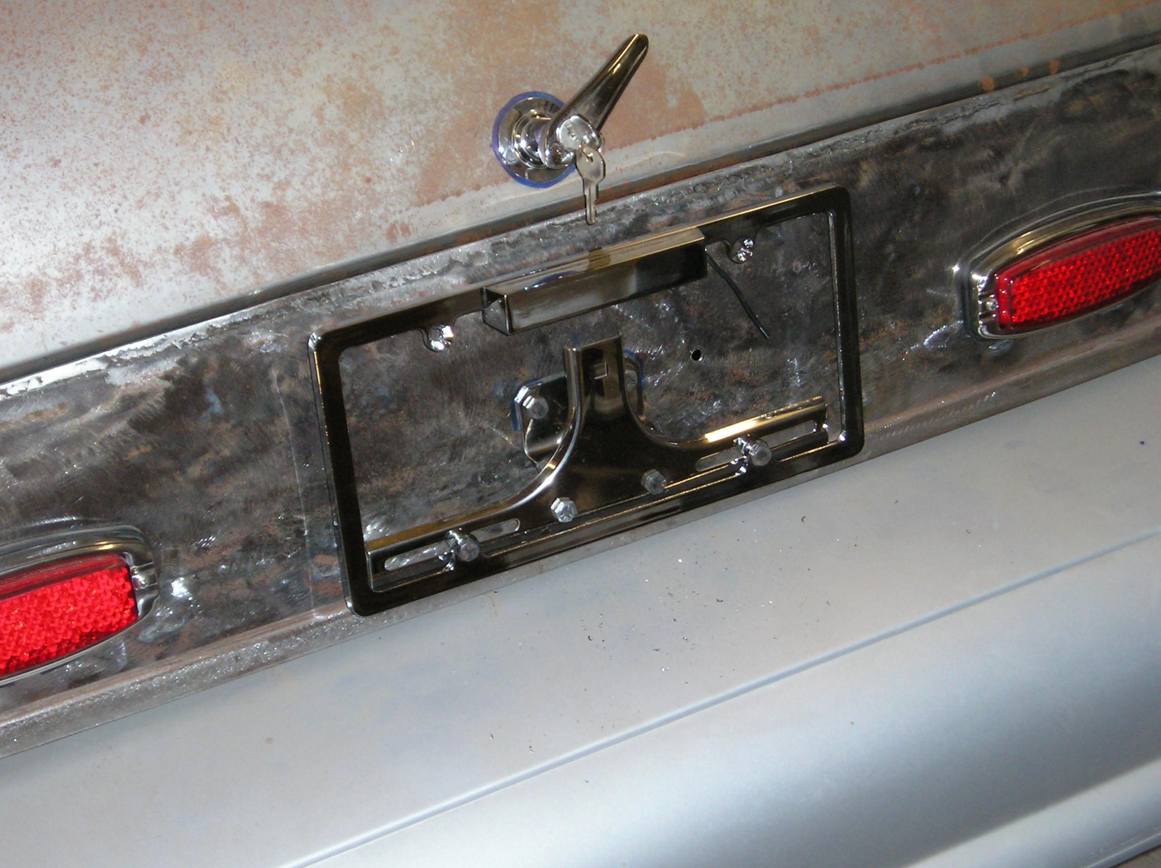

    Thanks, did a couple small things today. I put headlight wires into conduit, kind of cleans up the front end .
    I also got the license plate mount altered and put on, makin progress.
    I will get some chrome bolts when I do final assembly on the plate frame too.

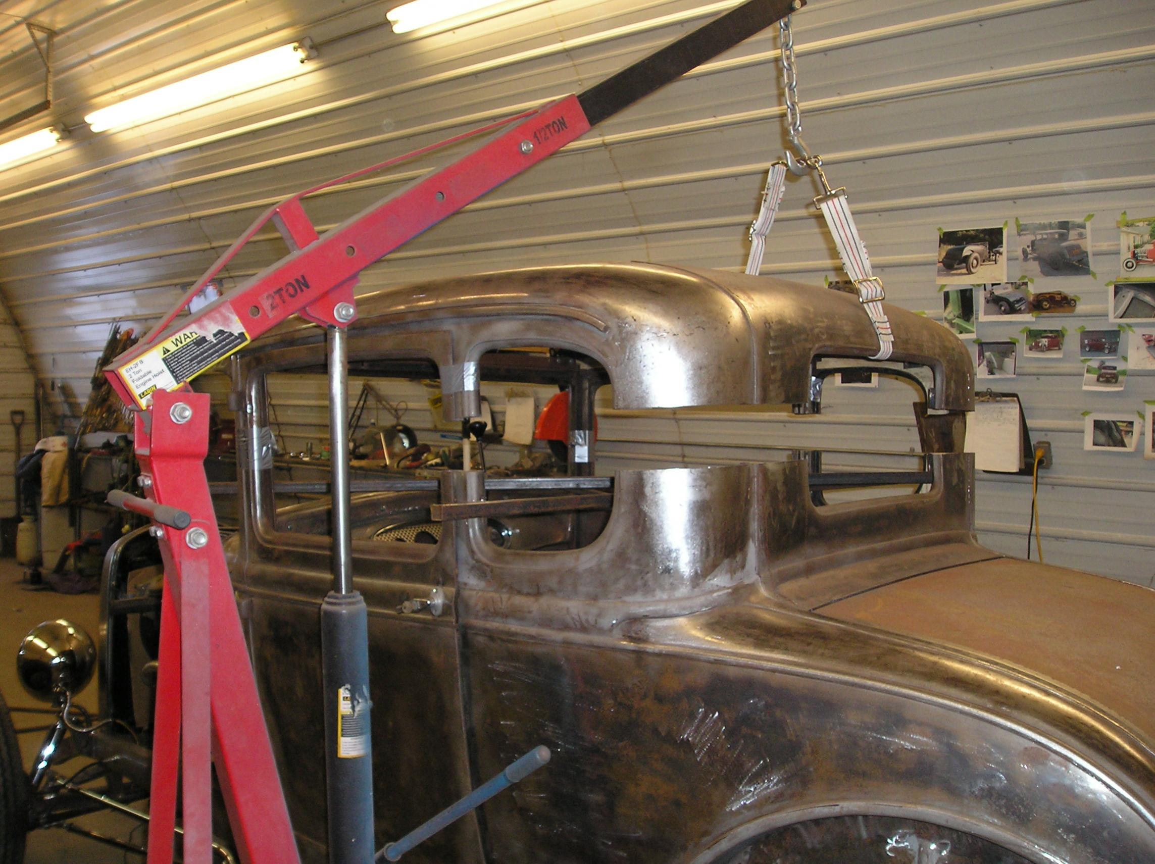

    Today I decided to take 3 1/2 inches out of the top, the pics. show how I did it working alone. Not too tough really:).
    Tomorrow I will start fitting and spot welding everything together.

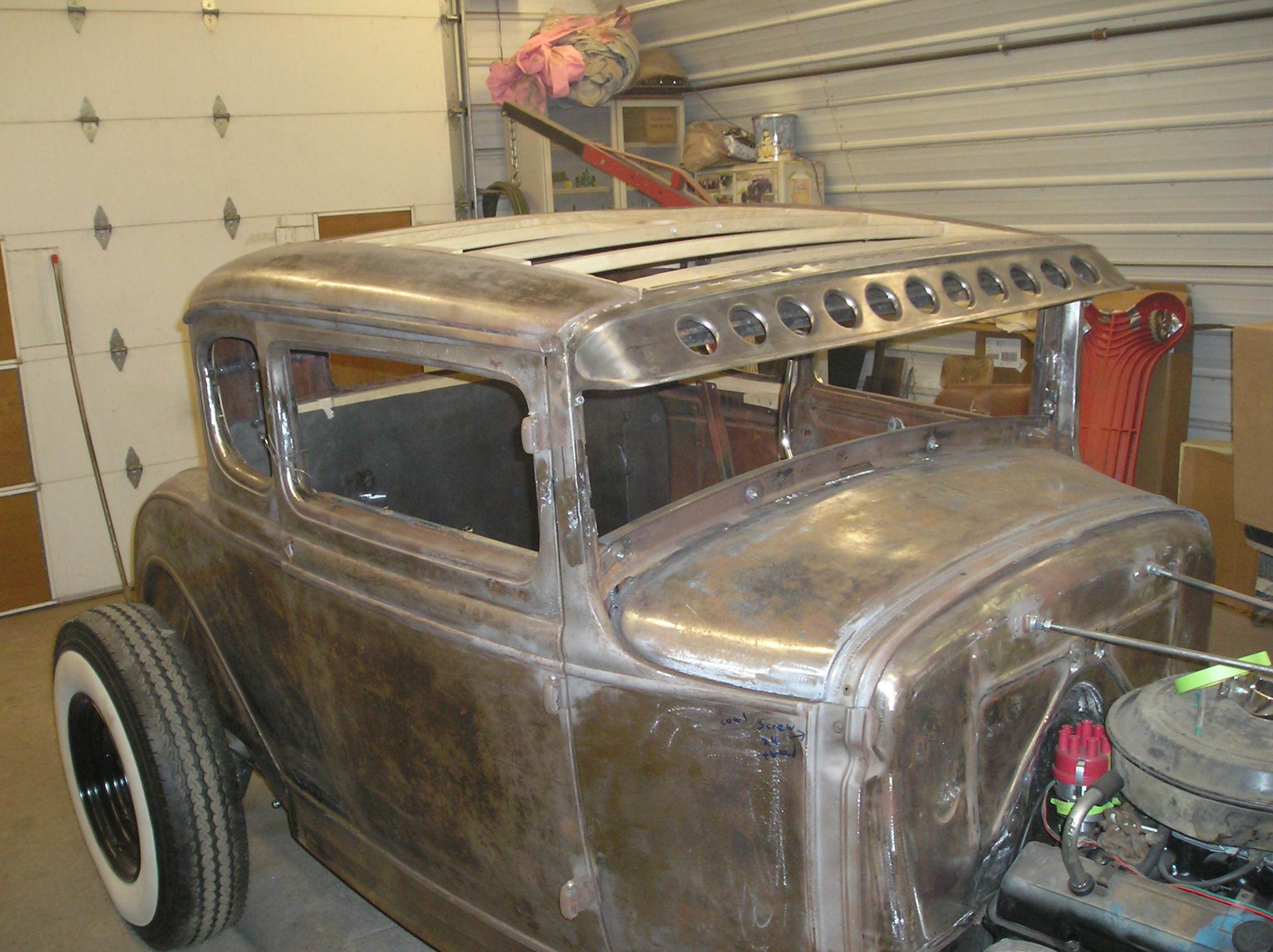

    Finished my first chop top last night, I got done with the garnish moldings.
    I won't bore you with pics of the 22 cuts I made here and there to get everything to align, it was not the worst job I've done. It just takes some thinking as you go through it .
    Also got a Rootlieb hood top for it. I ended up raising my grill shell up half an inch from the inch and a half I had lowered it.

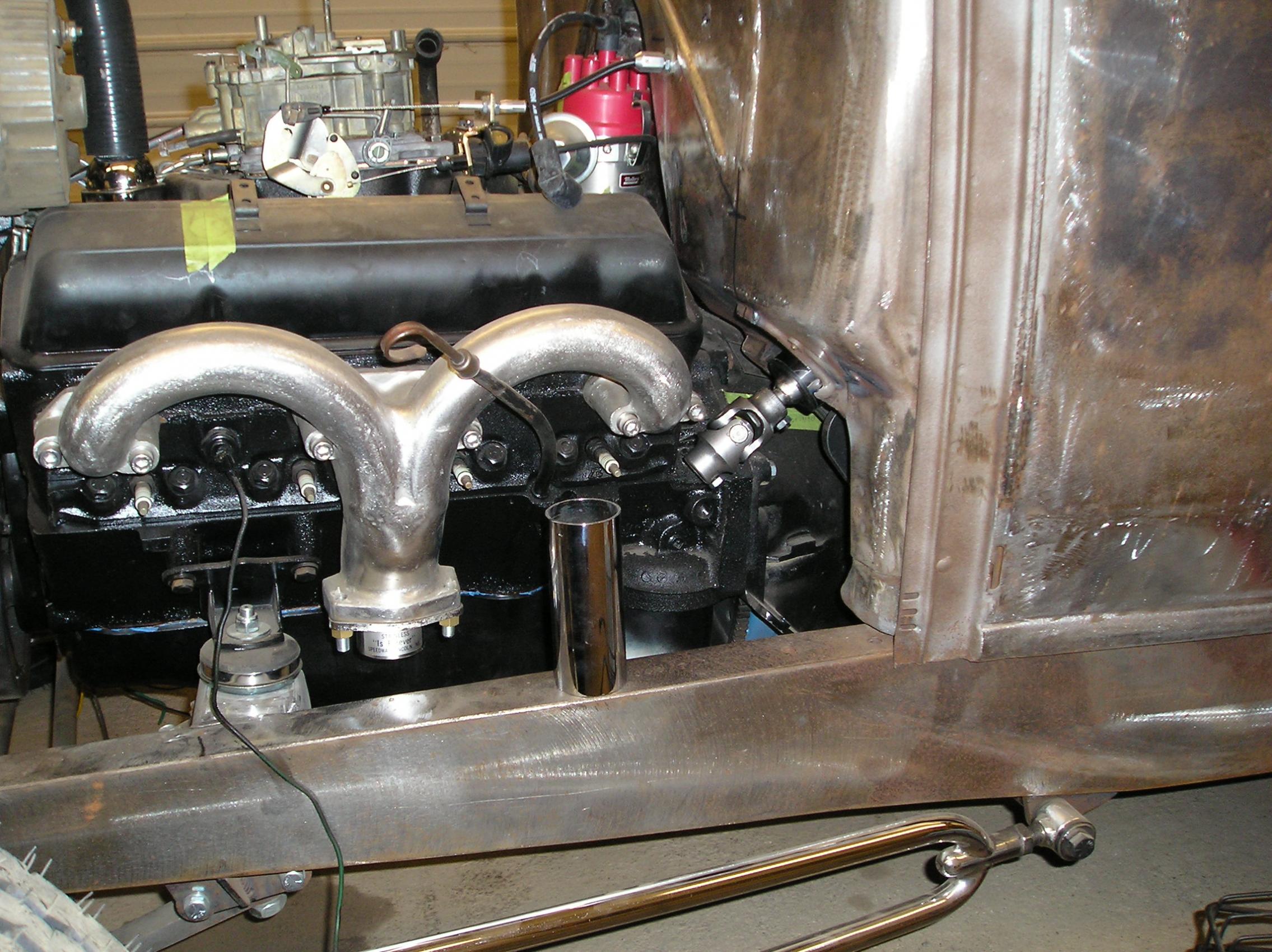

    I decided to shorten my steering column by 5 inches since I had mis-measured when I ordered it. I cut the outer tube 5 inches shorter , then I removed the inner shaft which is 1 inch round and cut it so it sticks out of the outer tube by 1/4 inch.
    I drilled some holes in the round for rosette welds and pushed 3/4 double D into the 1 inch about 4 inches, a nice snug fit.
    Did some rosette welds and welded all around the end, nice and strong.
    I got a couple Borgson joints and more double D 3/4 and joined the steering wheel to the tires for the first time, cool.
