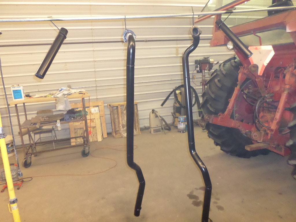

    Got my E brake working, the Lokar stuff was easy to work with. 130 002.JPG Painted my exhaust pipes with barbecue hi temp black. 130 004.JPG Had to cut and change the inlet by a couple degrees. 130 005.JPG 130 007.JPG Now both pipes are hanging the same.

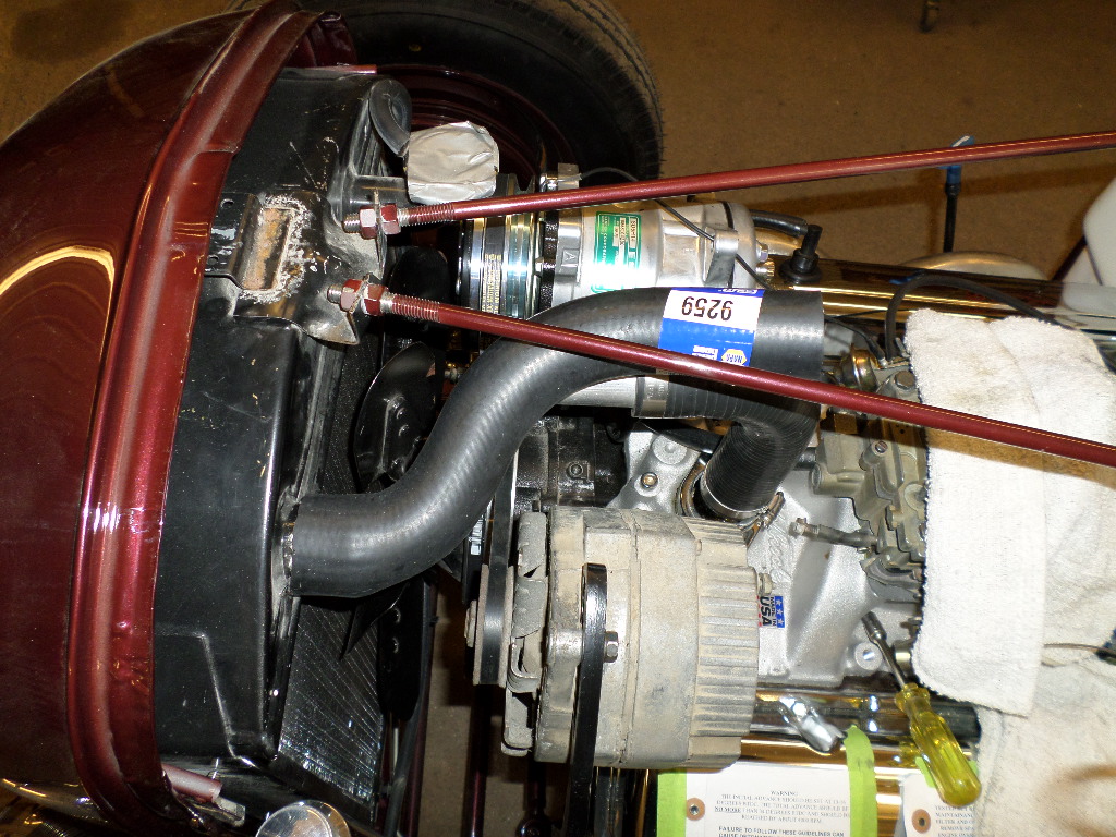

    Really don't like my belt tightener so I made a wire pattern and went looking for a different hose 132 087.JPG I found a hose that will work much better 132 085.JPG I took a belt tightener from a 283 I have and, with some altering it will mount like Zips intended. 132 088.JPG

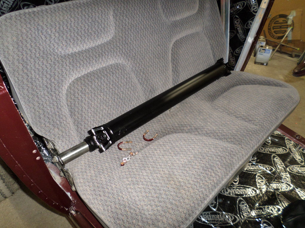

    133 001.JPG 133 002.JPG 133 003.JPG Been a while since I updated, been busy with the farm but, I have done a few things. I finally finished the wiring and I got a drive shaft and got it in.

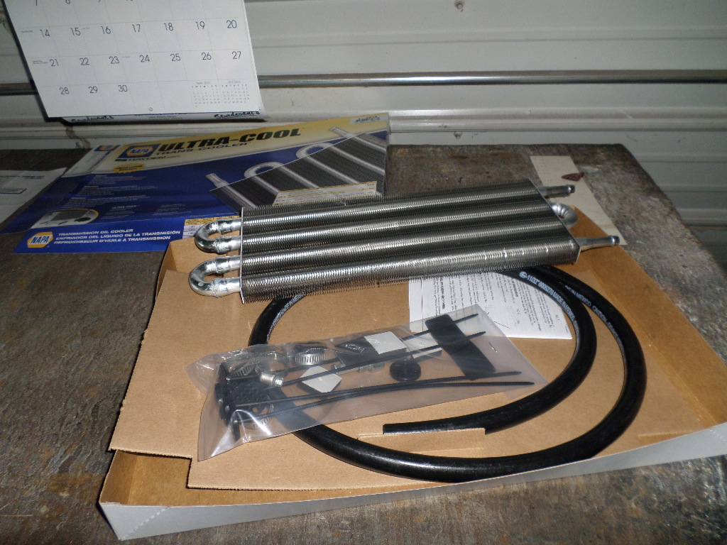

    133 007.JPG 133 008.JPG 133 011.JPG 133 013.JPG 133 006.JPG I also installed a trans. cooler at the advice of a friend so now the radiator and trans are separate. I have also finished with all the hoses .

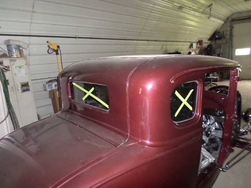

    133 005.JPG Got some of my glass installed too.
    Studebakermatt likes this.

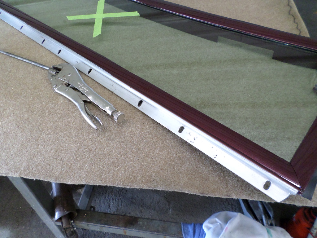

    It took a while to get the door glass working as the windows wanted to cock a little and jam. So after filing and sanding and narrowing the track, 134 027.JPG and ruining a couple C channels I got the door windows working well. I ended up shortening the pass. window arm almost 2 inches to center it better....

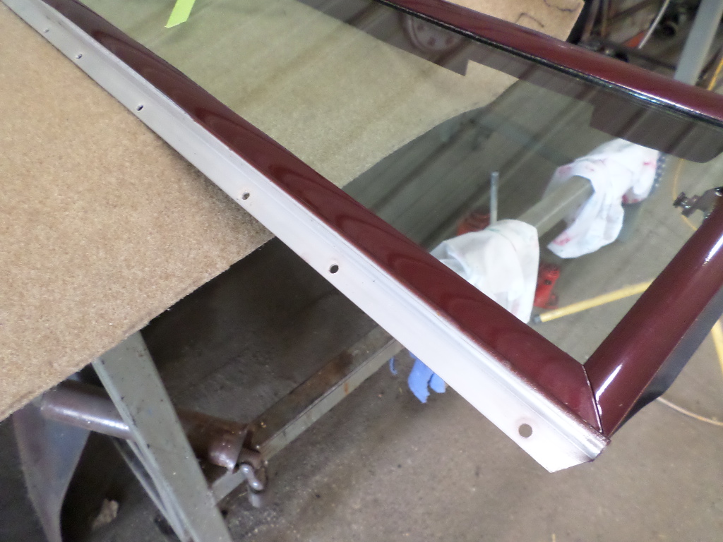

    I test fitted the windshield with the rubber attached and found it a little loose at the top so I made slots in an attempt to tighten it up. I have a feeling the windshield will leak some. 135 001.JPG 135 002.JPG

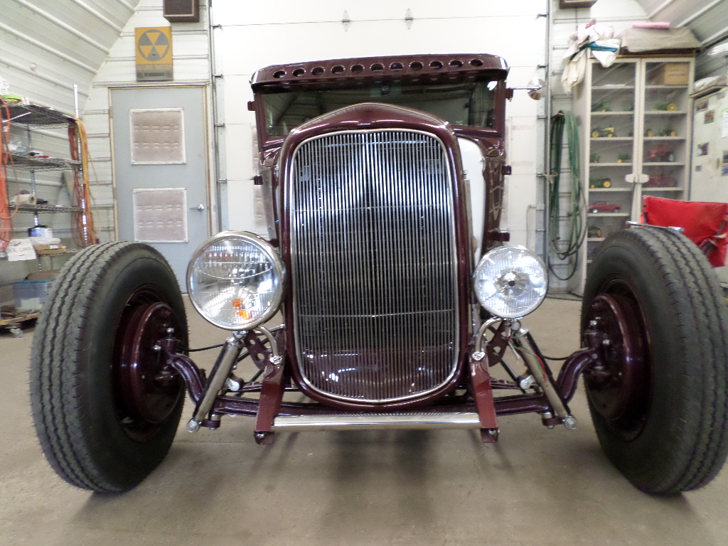

    I have decided to go a little more traditional with my headlights, so smaller ones went on yesterday. 136 012.JPG 136 015.JPG 136 016.JPG

  27. R35J1S
    Joined: Jul 20, 2012
    Posts: 141
    R35J1S
    from Missouri
    I can't decide. I like it either way. Good looking ride.
    Sent from my SM-N900P using Tapatalk
  28. Norm I like that look with one big light and one small light. reminds me of the Bill the Cat cartoon
    Jet96 and norms30a like this.
