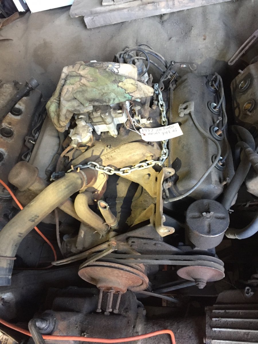

    Well, the engine is now mocked up. I suspected the steering shaft was going to be a problem and I was right. Step one was to remove the gearbox and it's integral steering shaft. Yea, no rag joints on this one! Looking back at the photo's I've come to realize some of the rework that is going to come from them.

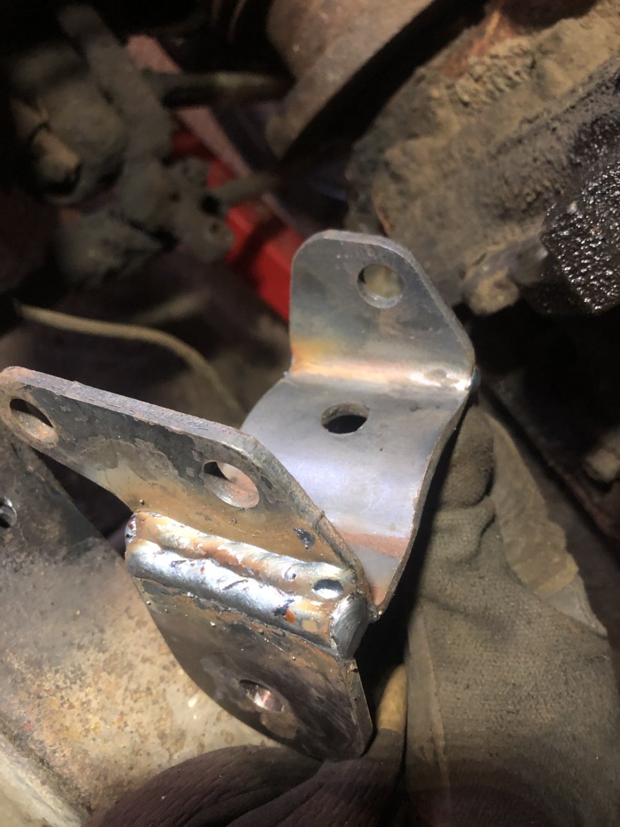

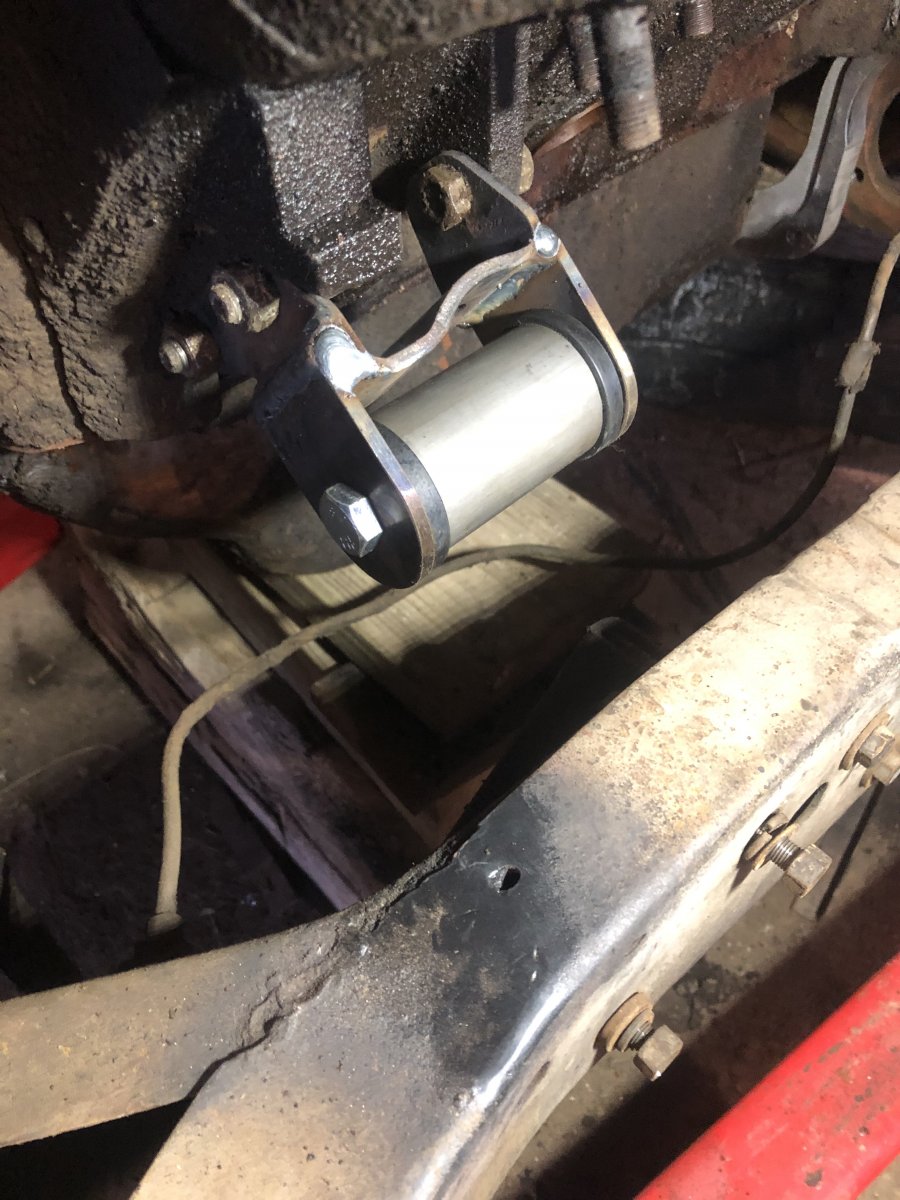

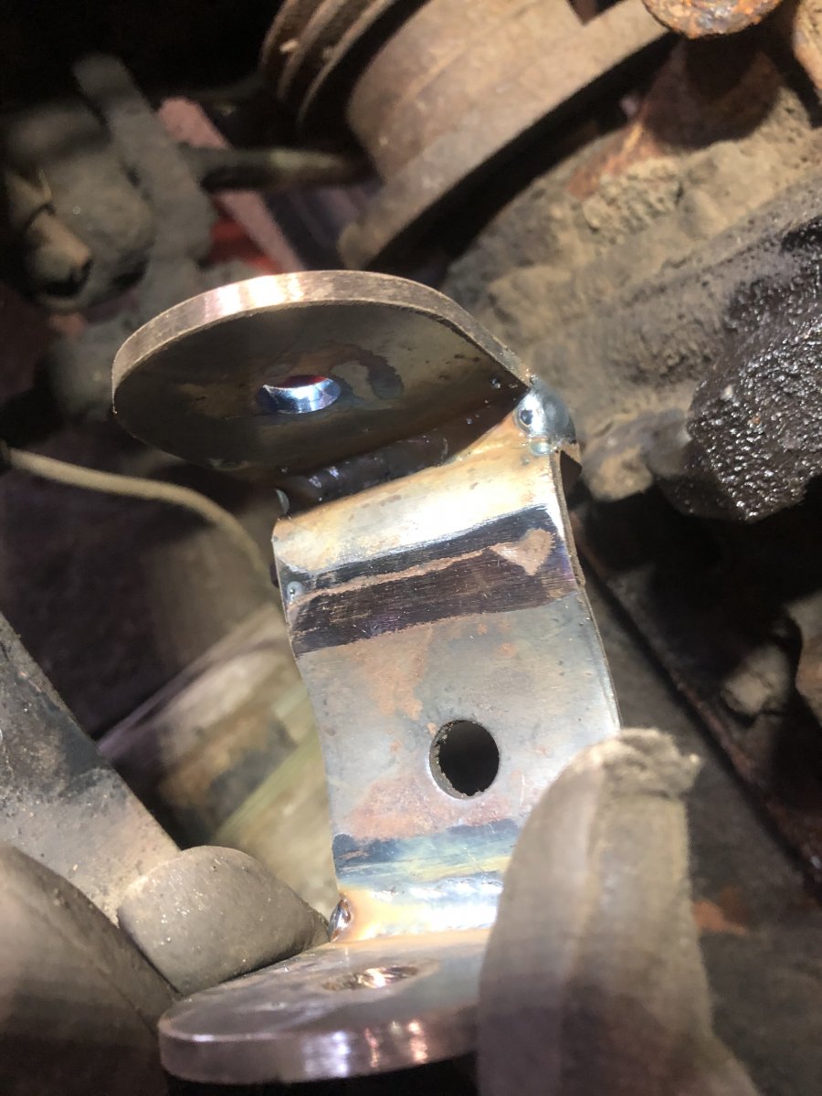

    The Desoto comes with an unusual donut style mount that bolted into the chassis with a vertical bolt. There were then three horizontal bolts that attached the mount to the block using some cast ears. Rather than remake the entire assembly, I chose to cut the original mounts apart and then weld some tabs to it. This would permit me to use some leaf spring bushings for the motor mount.
