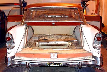

    Anyone real familiar with what parts exactly I'm missing here? Thank you

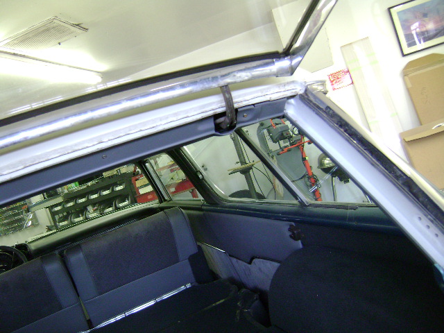

    You are missing the tailgate cable retraction system There shoud be a wire spool in the fender which feeds a cable out to the tailgate. It is on a retraction wheel. It feeds through a metal formed grommet which fits the hole you are showing and then the cable attaches to a bellshaped fitting on the gate. Also you are missing the "chrome hoop" which engages your lock when you put the tail gate up. This pic is a little small but you can see the cable set up.

    I got that off of Google images. I did a 55 Mad a few years ago and I'll try to find my build book. Here's mine......
