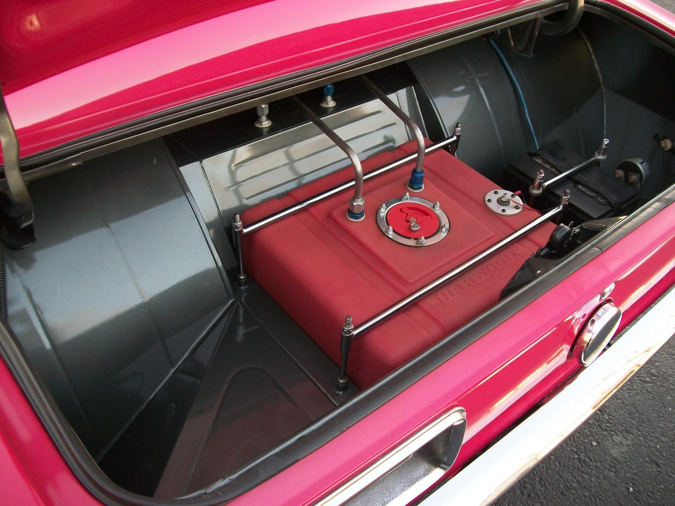

  12. I don't know about this set up. These pumps are pushers,not a suckers .I've always installed this type of electric pump setups level with fuel cell outlet connection.
    Electric fuel pumps are always noisy anyways.;)
  13. Maybe not a good example of proper mounting ;)Better read this - Holley's instructions for that pump!
    The best location for mounting any electric fuel pump is the rear of the vehicle. The inlet and outlet of the pump must be mounted below the lowest point of the tank. This is necessary to allow for an adequate fuel supply. The pump is designed to push fuel and not designed to suck fuel out of the tank. It needs to be gravity-fed or if it’s pulling from the top of the tank, it needs to develop a siphon feed to the pump. The pump should be mounted on the chassis, in a vertical position with the pump motor on top. Avoid exposure of the pump and fuel lines to moving parts and to any hot areas, such as the exhaust manifold.
    The pump should not be mounted in a closed area, such as the vehicle’s trunk.

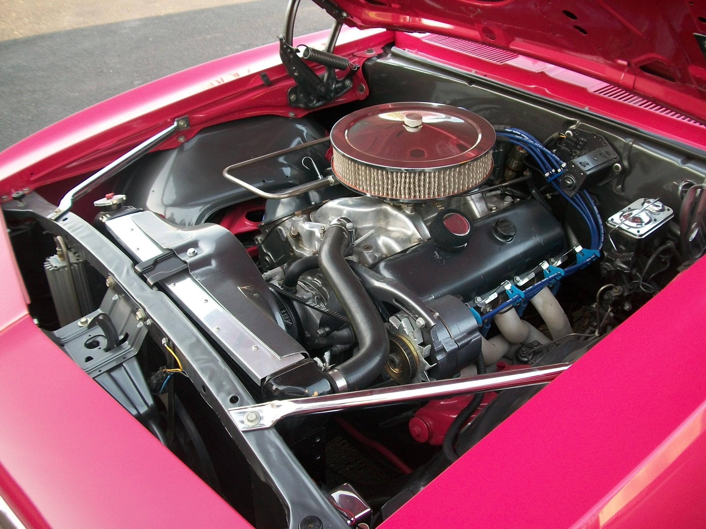

  17. aerocolor
    Joined: Oct 7, 2009
    Posts: 1,209
    aerocolor
    from dayton
    I just removed a return system from my O/T Camaro.
    It surged like a blower at idle using a black race pump and pop off valve set at 7psi through the fuel log. Now deadheading the pump and the idle is constant. I wondered whether the 1/2" line was too big causing cavitation. Never know now but the system was a plumbers nightmare.
    The pump isn`t any quieter.
