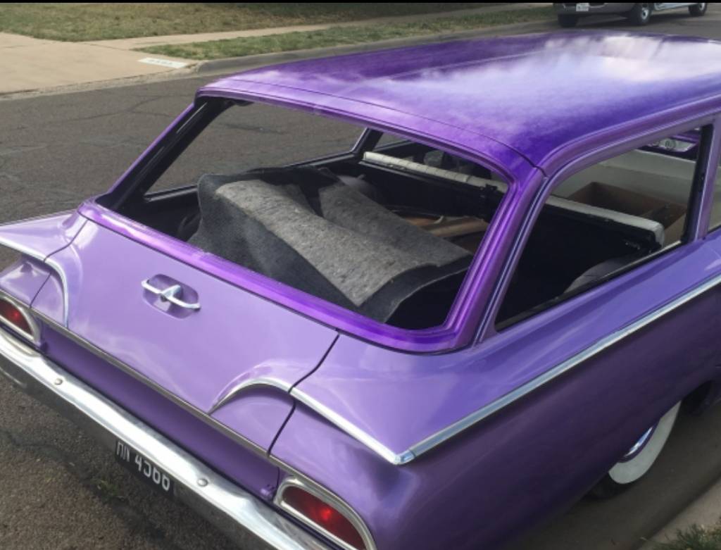

    I have a 1960 full size Ford Wagon, and no one makes a rear windshield gasket.
    I bought the car in pieces and I am finally putting it back together, but I do not have a old rear gasket to look at or send in. I called Steele,Carpenter,C&G etc... and they all say that the rear gaskets are not only not available, but not produced.
    Any help would be appreciated

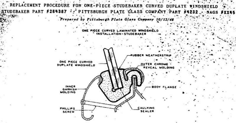

    before doing that, I would compare the profile of the rear window opening, with the windshield opening.
    This is not what yours looks like, but this is the view you need to consider:
