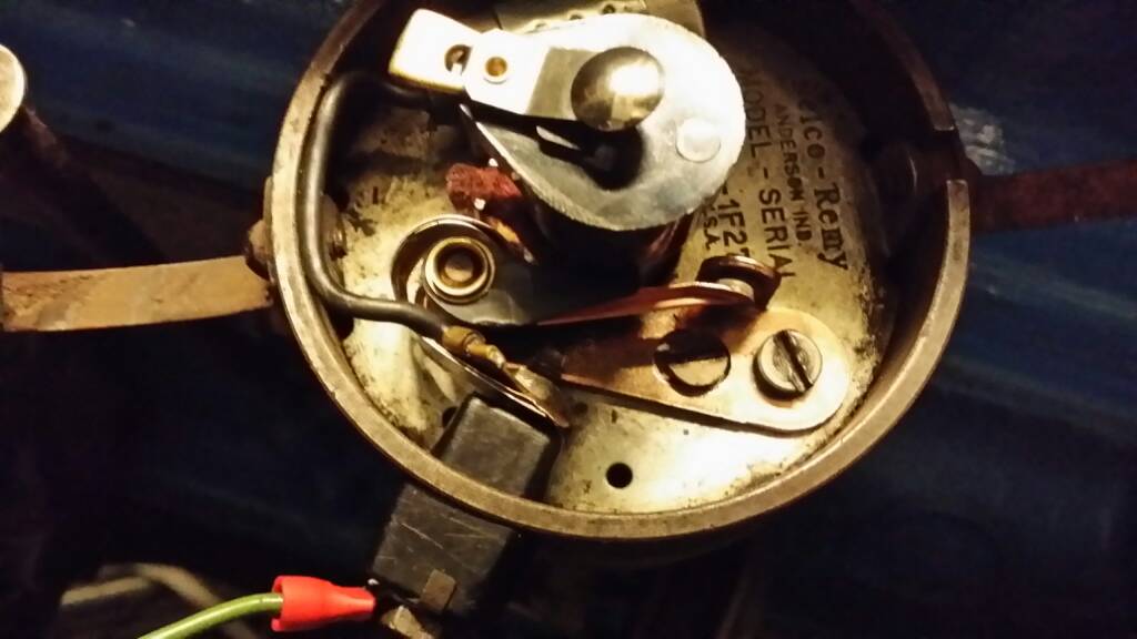

    Posts: 2,873
    henry29
    Post a pic of the distributor and the inside of the cap, sometimes you just overlook something someone else might notice.

    This is how the dist looks with all the internal parts. Today ive connected a sparkplug to the sparkwire from the coil, had the power on. I've got a tiny spark from both the breakers and occasionally from the sparkplug when I separated the points. Right? I measured the battery - only 11.99 v. Maybe its a badly charged battery that wont get the enough power to produce the spark. The breaker points has ground. Battery on charge during night. Next test tomorrow. Thank you for all the helpful answers.
