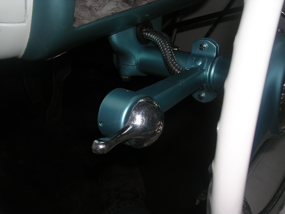

    Pics of the dash....and a vintage turn signal switch that I want to keep, rather than a modern T/S with a built-in dimmer handle

    Maybe I can do a micro switch on that stalk. Going through stuff in 2 buildings of CRAP, I just found a VW micro switch, and the only VW 12v dimmer relay I found so far is an older bulky type...but I did find a wire diagram for it. Looks easy wiring....just 4 wires on it:
    >>I will post a pic if I can get the micro switch to fit.
