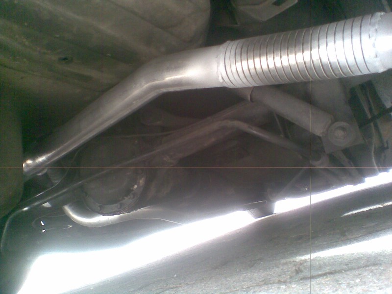

    Friday afternoon i went to pick the car up w/ the new exhaust system installed.
    As i mentioned up here its a custom built system.
    As i would have guessed the previous evening i had to pop the hood and
    start twinkering w/ the carbs, as the 2 tail pipes where pumpin black smoke as they never did!????
    So, why in hell did the old fucked up exhaust system block the black smoke and pump white one????:confused::confused:
    I had to open the air screws like crazy and kept the thottle valve almost closed,
    as it was obvious didnt manage to drive like that for more that 30 minutes,
    and closed the air a bit and opened the valves, better, bt a bit smokey!
    WHy people! i know im gettin too much fuel, but why w/ the old system the car used to run better?
    Isnt it supposed to run better now w/ 2.5 inch tubes and open pipes??
    I have a small flat muffler on the side of the trans then open pipe up to
    the rear axle that split in two exits one each side exiting
    throug 2 triumph style coktail shaker tips which are empty w/ a small baffle that doest really serve a purpose
    other than if stopped by the law i can say its there..
    Any clues people? at least this is the final proof i need smaller jets...
    but aint this story weird?

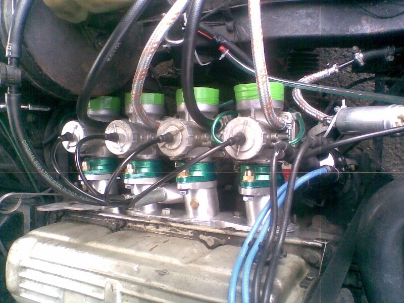

    What he said is that i had to connect the vacuum hose of the vacuum advance pump on
    the distributor to the manifold and that my brake booster vacuum hose, that was
    hooked to just one inlet port, had to be hooked to all four, cause the engine this
    way will breath more evenly.
    I trusted him and tried.
    The picture was taken a year ago, and the booster hose wasnt on yet.
    I hookt it in one of the plug holes plugged by the brass bolts.
    Now, to do what my collegue said i made 4 plugs, one for each inlet, that
    run a inch up to a piece of hose parallel to the valve cover and as long as
    the whole manifold. At one end i plugged the brake booster vacuum hose,
    at the other end the vacuum advance.
    Bottom line: car was un-tuneable!!!! I tried every possible combination of
    air and idle screw turns but no chance!
    Once i took vacuum advance off engine ran better.Better than ever that is.
    My collegue was right on one point, the brake booster vacuum hose hooked
    to all four inlets made the engine go smoother.
    Why i dont need vacuum advance? Or how should i set it up?
