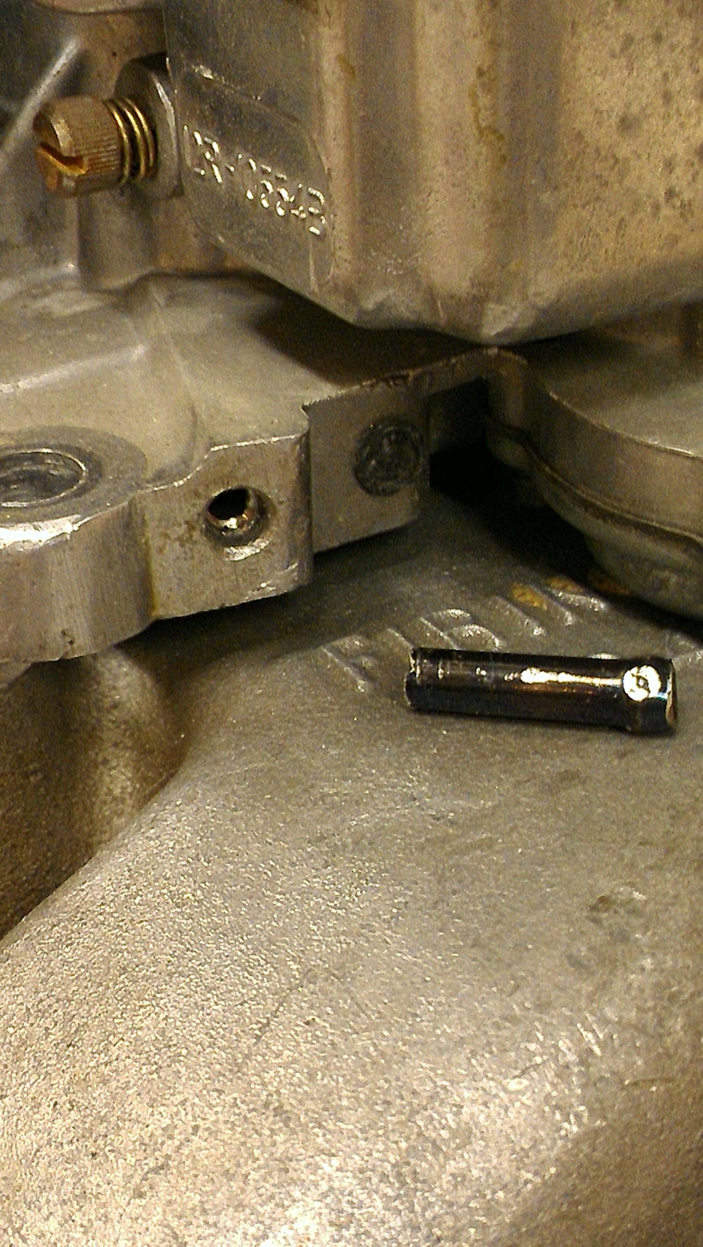

    Perverts! Not what you were thinking! I have a Holley 4010 that I would like to use but the timed vacuum nipple is broken. I'll need this port for vacuum advance. Any ideas how to fix it?
  2. JB weld will work.
  3. Can't you drill it out and replace it with a piece of tubing? HRP
  4. lowrpmtork
    Joined: Aug 25, 2012
    Posts: 59
    lowrpmtork
    Duh! I didn't think of either one! I'm going to try the JB Weld. Thanks!
  5. JB weld is the duct tape of the modern world.
  6. VoodooTwin
    Joined: Jul 13, 2011
    Posts: 3,453
    VoodooTwin
    from Noo Yawk
    JB Weld? Yuk. Do what Danny suggested; drill it out and insert a new nipple.
    Damn, I'm all excited now. :eek::p
  7. loose1
    Joined: Dec 16, 2010
    Posts: 22
    loose1
    Can you drill and tap it for a 1/16 or 1/8 npt and screw in a new nipple?
  8. yaidunno
    Joined: Apr 26, 2012
    Posts: 46
    yaidunno
    from Wisconsin
    A press fit tube or NPT nipple would be the proper fix. JB Weld...not so much.
  9. mashed
    Joined: Oct 15, 2011
    Posts: 1,473
    mashed
    from 4077th
    JB Weld SUCKS. It's a tapered hole. Remove the broken piece and shove the rest of the nipple back in. Done.
  10. ANDEREGG TRIBUTE
    Joined: Jan 1, 2008
    Posts: 1,385
    ANDEREGG TRIBUTE
    from Bordertown
    I would try to thread a sheet metal screw in there and maybe you can pull the broken piece out. Hopefully the original piece is still long enough to use again.
    BTW thats Mr. Pervert...if you please...
  11. or use an easy out
  12. Rookie1
    Joined: Apr 5, 2009
    Posts: 63
    Rookie1
    machine screw tap, then thread the screw in and pull or push it out.
  13. Ebbsspeed
    Joined: Nov 11, 2005
    Posts: 6,257
    Ebbsspeed
    If it's the timed (ported vacuum) port, plug the damn thing and use manifold vacuum. Or does it need to be a smogger motor?
  14. F-6Garagerat
    Joined: Apr 12, 2008
    Posts: 2,652
    F-6Garagerat
    This is what we used to do at Kirks Carburetor here in Detroit. If what's left of the tube is long enough. Screw a dent puller into the broker piece of tube and pull it out, that way u won't screw up the size of the hole.
  15. junk yard kid
    Joined: Nov 11, 2007
    Posts: 2,717
    junk yard kid
    I was gunna say what ebbspeed said. I have a car with what looks like fishing weights hammered in. Looks better than the vacuum caps.
