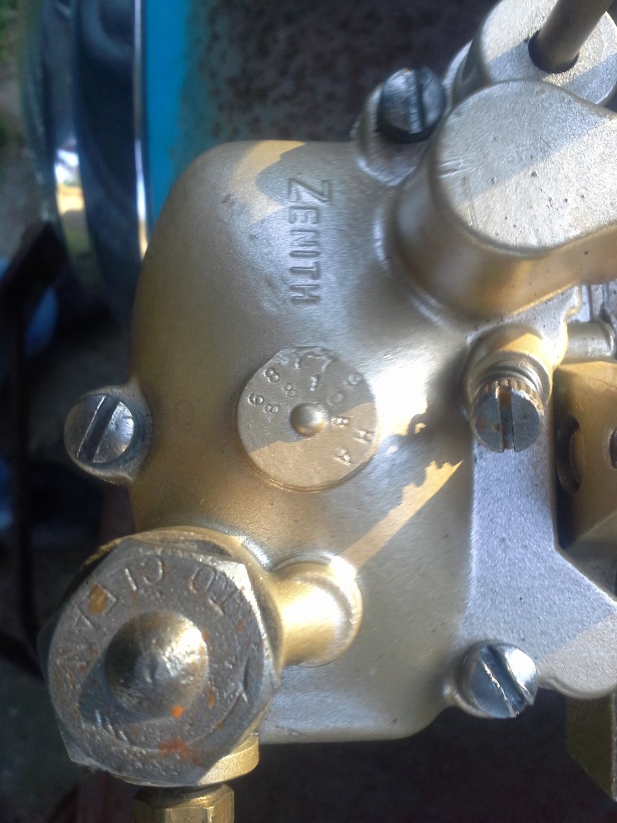

    Oh the great and knowledgeable members.... a little help please... Did a search but couldn't find much on carb info. A friend has a Nicson intake manifold with the carbs. They are marked with 8810 B on the casting. Are these the 80BV10 carbs? 20170527_191038.jpg

    Nicson used both Zenith type 80BV10's and 82BV10's. Yours are 82BV10's. I have not seen a lot of the Nicsons, but most of the ones I have seen had the 8810's installed.
    Kits (if needed) for either are available.

    The 8810's (82BV10) were used by I.H.C. in the late 1930's, on a 6 cylinder truck, which may have been a C.O.E.
    The 80BV10's were primarily used on late 1930's G.M.C. trucks which were C.O.E., and I.H.C. also used them on trucks.
    I think there was an industrial air compressor that also used these.

    What may have given you a problem is if you used 8810B instead of 8810. The letter following the number is an engineering status code, showing number of changes to the original design. It is normally omitted when quoting a carburetor number. Carter, Holley, Rochester, and Stromberg all used the same convention.
