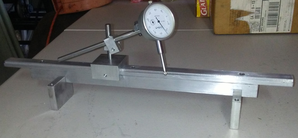

    Terry, there are plenty of distractions in the world these days. I hit the HAMB as a refuge from the craziness of the times. Between HAMB and my various shop projects, it's still possible to get through a day, a week, or a month without losing touch with what matters. I've frequently reflected on the fact that it was racing that added enough spice to life to make getting up and going to work possible through the years.
    Here is an example of one of the gadgets from the bottom drawer of my rollaway that I recently duplicated for a friend. I'm confident that you and possibly some others will recognize the application.
    I didn't originate this idea but it has served me well for almost forty years.
    Everyone, keep on posting the pictures, questions, observations, and commentary. That's what keeps us geezers going!

    That looks like it is to check the straightness and flatness of an engine block deck ? Anyway thanks for replying so quickly. My early years were good with my racing efforts in stock and Super stock then it became too expensive after around 1980 and my stupidity of getting married then divorced and having 3 (now adult) kids. My working for 3 years as a Div. 1 tech guy1971-1973 (working for NHRA was like working for the Gestapo) then 22 1/2 years as an IHRA tech guy was about all that kept me sane. I built several record holding engines and prepped cylinder heads from 1970 ( I got out of the Army in 1969.....Hated the Army even as a Sgt.) until about 1998. I sold everything and moved to Fla. in 2010 and now help put on 2 car shows a month now. One for older cars (hot Rods and muscle cars) and 2 weeks later one for Corvettes only ! Have a Merry Christmas !

    I thought it was used for checking the depth of the piston in a cylinder.

    It looks like you could use it for that also but I always used bridge and dial indicator that had 2 magnets to hold it to the deck or my C.C. tube and a plate that would fit the bore for the Super Stock dish. . . and by dropping a dome down below the engine deck to clear the top of a dome. Hemis were always a lot of fun.

    I've mocked up the fixture on a spare head to demonstrate it's most productive use. Most followers of this thread have either experienced or heard stories about the tedious process that Stock racers have traditionally endured while setting up motors. In the past, there was a time when camshafts were checked on lift, duration and overlap and a racer who left the trailer with the expectation of winning was also prepared to undergo a complete teardown. Entering a teardown, there was never any certainty which cylinder would be the focus for that event. Bore, stroke, deck, cam specs, piston configuration, spring pressures, chamber volumes and runner volumes for any cylinder were subject to verification. That meant that ALL cylinders had to be blueprinted to the builder's satisfaction and the tech expectation. Add the factor of valve-to-piston clearance and I could always count on at least one very long day of sitting on a stool in front of the engine stand, juggling cam buttons, pushrod lengths, and rocker ratios to make sure that everything was legit and that there were no catastrophic events programmed into the combination before it was ever fired. The fixture, secured to the cylinder head allowed the dial indicator to be moved along the rail from one retainer to the next without the hassle of repositioning the indicator and aligning the needle multiple times. The most advantageous application was for a small block Chevy with all the valves in a neat row, front to back. I've used it on big block motors but, obviously, it has to reset when switching from intake to exhaust valves. I'm sure that it would work just fine on most overhead valve motors. That's my story and I'm sticking to it!

    Great info Chuck! Did I miss the mocked up pic? Sounds like a painful day being torn down...Randy

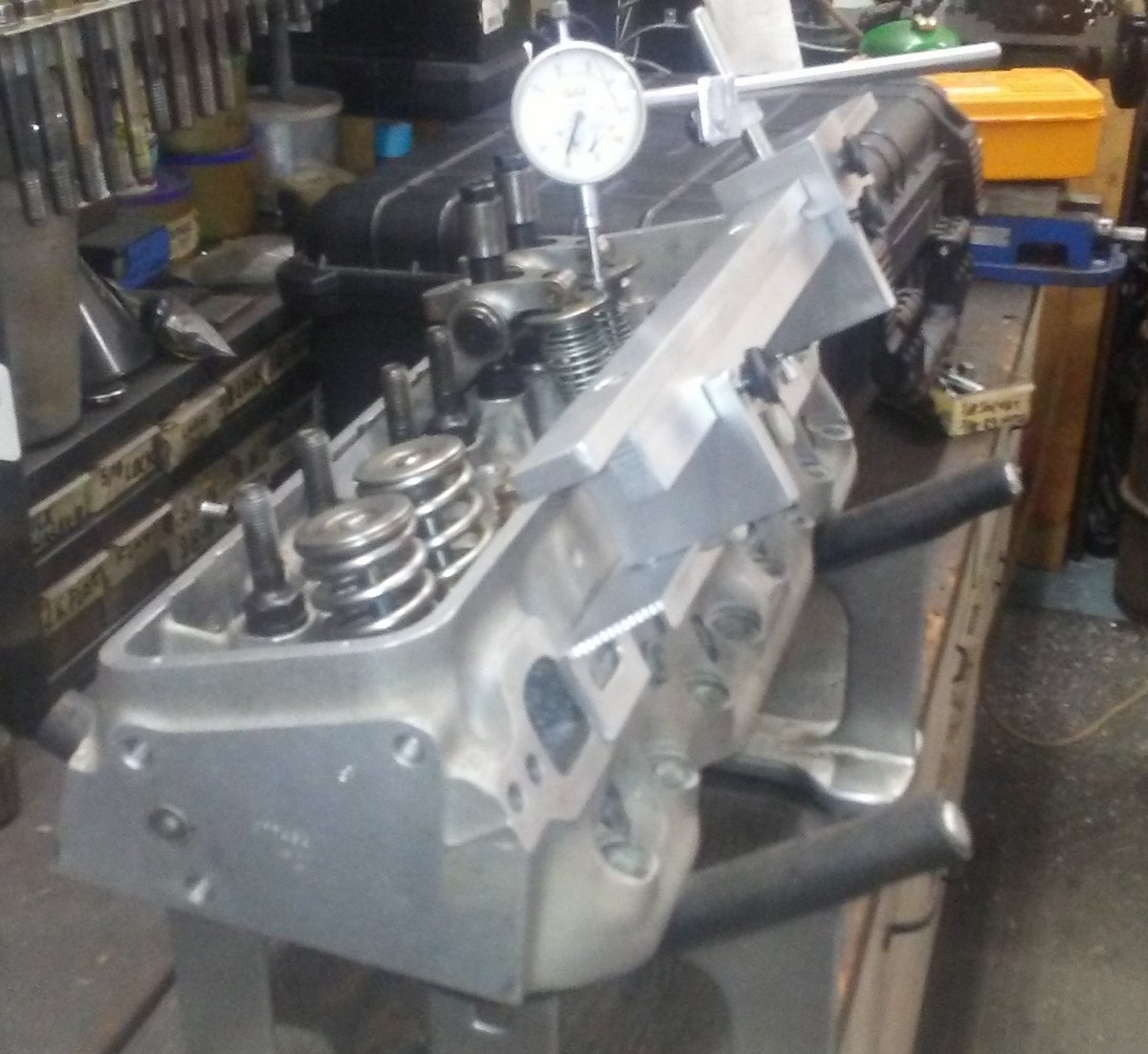

    Sorry, I mocked it up and neglected to add the picture. Getting old is a bitch!
    If it had been a "day" things would have gone a lot easier. During the Junior Stock years, at Pomona, it was 1. run class, 2. If you won, they sealed the motor and you departed for the barn at sometime after that, usually after 2 or 3 PM. 3. As many as twenty or thirty cars might be in the barn by the time you got there. 4. If you were runner-up and the winner got tossed, you probably started the teardown by 5 or 6 PM. 5. Depending on circumstances, an inspection could take at least a couple of hours or more. After the inspection was finished, you had all night to get it back together and ready for the first round on the next day. Different events had different schedules but having a full day to complete the process such as was provided at Indy was not common at the races I attended. If you were lucky, you tore down in a covered "barn" but I've ripped the motor apart in a open deset field beside the tech trailer more than once. The worst was at Las Vegas when we had the motor apart and a helicopter landed about 100 yards away! I was cleaning dirt and dust out of places that I didn't even know existed! The backwash blew away the tent that the racer beside me had put up.

    And they provided gaskets or no? Seems like I’ve asked that question before (it’s been a long first day of vacation...). Randy

    The only thing provided was the actual labor force that conducted the inspection. You took your own tool box and gaskets. Met some really nice people under fairly intense circumstances.

    I knew it was for checking valve spring/retainer heights, but I did't want to come off as a know-it-all, which I don't, no matter what my wife says. Yours is definitely nicer than any other I've seen. I am Butch/56sedandelivery.

    NOPE !

    And now you know why NHRA does not really do inspections on stockers any more and the rules of today are a JOKE ! Its one reason why a record holding small block today will cost you between $25,000 and$35,000. You might as well run a Super Stocker.
