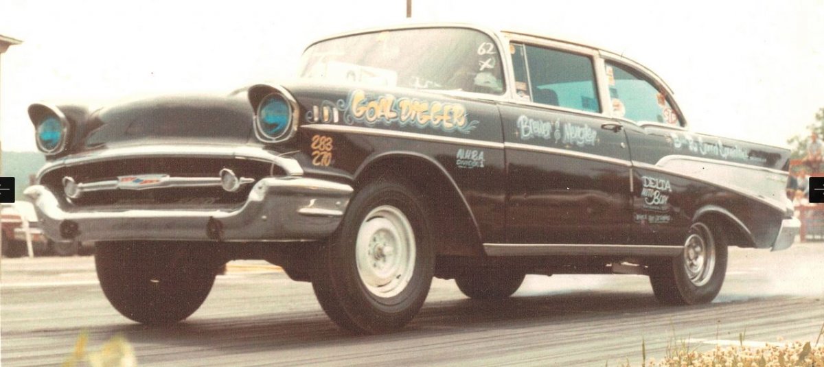

    My brother is not with us, but bill (driver most of the time) is still kicking. So I want to surprise him and show up at his house with the car and let him take it for a drive. So I want to get the car close,especially the interior. Thanks junior stock for the information!! Any and all information is deeply appreciated.

    Thanks for all the information guys. This is my plan,but nothing in stone. I have a 283 no side motor mount block that is good, 283 steel crank, a few power pack heads, not sure what year, small journal hd rods. Probably go hyper f/t pistons. 961 for 305 ci Steel shim head gasket. I used mostly isky cams when I use to build motors , I don't know if they make a blue printed stock cam, but the original car had the lunati. I have a factory in the tube 151 cam that works in 283 2x4 if advanced a few degrees. I have a factory 2x4 intake with 348 engine WCFB carb one stolen but found another(easy to change carbs later don't want to spend $3000 for reproductions right now). I want to use a iron glide because it's period and I have never built one. Someone gave me Marv ripes ph# on here ,guess he may know a little about iron glides.lol The body is off the frame. Frame has been sand blasted. I want to put the leaf springs back out side the frame rails ,welds look like they used chewing gum , and for stability , not running rear sway bar. I have ford 9" and8" rear end housings and third members we use in charger cars and street stocks and can go back to stock when I find good stock parts. Going to make rear shock top mount bar. That stahl torque control arm looks like fun little build for my nephew, if I had some dimensions. It's close to some of the torque arms for modified dirt. My guess is U can run a softer leaf set for better transfer and not have so much spring windup. All new stock front suspension, poly bushings moog ball joints etc. I know nothing about drag shock splits or what u could run. But get a deal on afco shocks. Now things I want are, seat belt harness with seat bar or roll bar not sure,disc brakes and fuel cell for safety and I can get it cheap. Now exhaust has to be on the car but not hooked up? They ran stahl fender well headers nothing hooked to the collectors. He had them chromed inside and outside with I think the same chrome he had on the crankshaft but not sure.OKjust took a look at the first picture taken of the car when they won some championship ,headers are black and have something on the end. I will try to post pic. Now body,,, no clue, want to keep wiring clean and simple. I need a front seat. I have a four door seat I might use until I can find a 2dr sedan seat for under $1,000,000,000. I don't want any interior I don't need,and let's face it, less I have to put back in the car the less work and money. So it's going to start a bit of a mix bag/work in progress with late 60s jr drag replica aspirations. Wish Barry was around for this. In 1971 or 72 nhra pissed him off for some reason and he never drag race cars again. He went to snowmobiles and got a factory Polaris sponsorship. Anyways if u take the time to read this and offer suggestions I greatly appreciate it and u thanks.
  7. old chevy luver
    Joined: Aug 7, 2013
    Posts: 72
    old chevy luver
    from sd
    [​IMG] forgot picture u can kinda see something on collector under noise by stahl. Thanks..
    Sent from my iPhone using The H.A.M.B. mobile app[​IMG] this is after headers had been chromed.[​IMG]

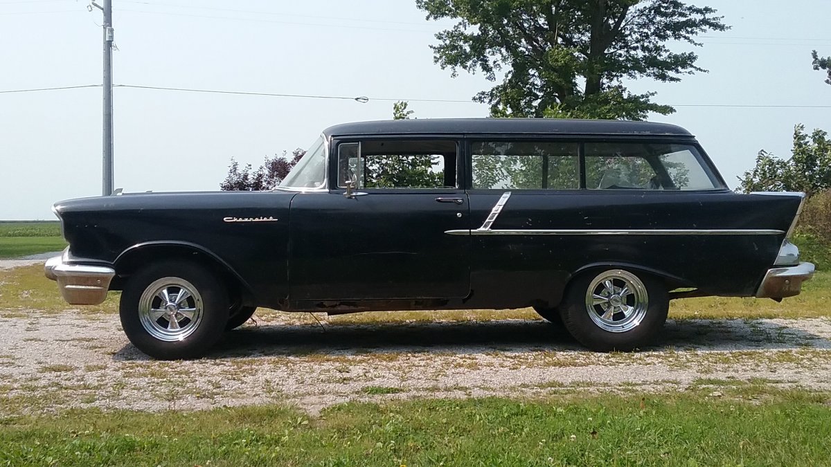

    Thought it was time to share my 57 150 2dr Handyman Jr Stocker/ street car build. Purchased it a couple years ago was in a barn for the last 35 plus years. Will be running a 283 or a 327 with a factory dual 4bbl setup, with early Stahl fenderwell headers . Car is currently apart with a full chassis rebuild . Hoping to have done to run at the Trifive Nationals this August.

    ^^^^Beautiful 57 Chevrolet Handyman Wagon, and perfect stance!!!^^^^ Keep posting to this thread on your build.

    VERY COOL WAGON

    Thanks ! That picture is without drivetrain but Im going to try to keep that stance.

    Welcome, Flatrocker! Liking that handyman & your plans for it.

    Awesome!!!

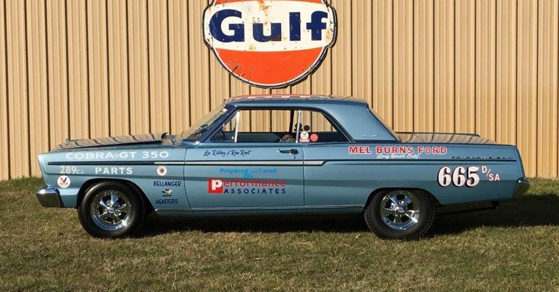

    posted by hemidav in the vintage thread.
    Yay Ford day :)
