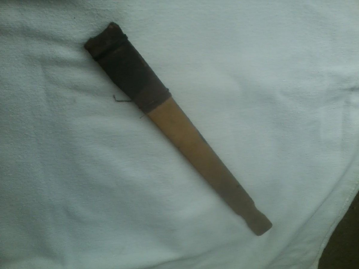

    Now be carefull if you do/this ---->
    A piece of emery cloth wire tied to a Paint stick ,so as to keep yer hands -n- fingers out of HARM'S way, hold it down in there to sand the BELT.....squeal
