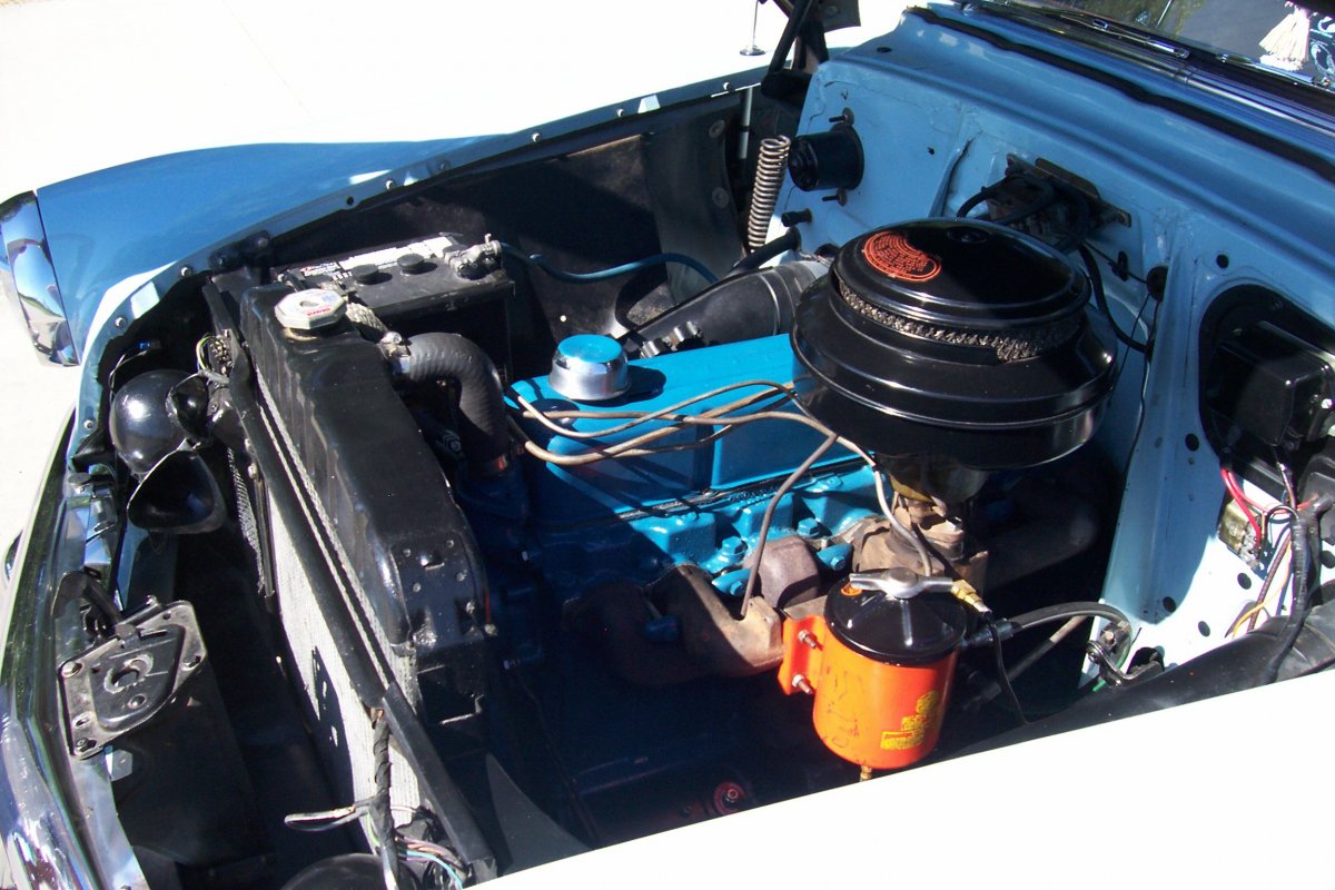

    Just drove my new wagon home from Tyler last night. It has the 235 with powerglide. Was cruising 55mph on the straights, but when I hit any incline... it would drop to 30- 35 and continue going down. Was told it sounded like no compression- ring issues... does this sound accurate? Is this a simple easy fix- or is it going to be extensive and pricey?
    All is original- still 6v.

  2. A compression test will show condition of your rings. Warm engine, remove all spark plugs and prop throttle open with a screw driver...test all 6 holes, writing down results and then squirt motor oil on each hole and re-test. If the readings came up a lot for the 2nd test, compression rings are worn.
    Truck64 likes this.
  3. do a tune up.... and check the compression and the ignition timing

    First thing I would do is replace the fuel filter.

    Could be as simple as a plugged air filter, fuel filter, weak fuel pump, timing off. Do the basics first. (check fuel pressure)
    If it needs rings, yes you can just put new rings in it if money is tight. You'll most likely need to remove a ridge at the top of the cylinders to pull the pistons. You may be able to borrow or rent a ridge reamer from a local shop. You'll need to clean all the carbon deposits off the pistons crown, ring lands and grooves, which is a pain in the ass. Soak the pistons in diesel fuel for awhile to soften them and loosen them up, maybe add some ATF to the brew. Note, a broken ring makes a good scraping tool to remove the carbon from the ring grooves. It wouldn't hurt a bit to hit the cylinders with a hone to put a fresh cross hatch on them. And while you got the head off it wouldn't be bad to send it off for a valve job and resurface. This is exactly what I did with a 235 as one of my first overhauls back when I was 16 years old, working with my dad out in the garage. We did it as an inframe in an old Suburban I bought (that my dad warned me not to buy, but I just had to). I'm not sure what kind of access you have at the bottom end, but if you can get the oil pan off you may be able to do an inframe o-haul too.

    I'm on board w/fuel pump/filter/line check before I torn into it too deep.

    Check the points gap, if the points close up they will loose power , Check to be sure there is grease on distributor lobe because if it is dry it will wear the rubbing block down and close up the points thus loosing power.Frank

    Is the float bowl overfull and spilling raw gas when on the incline?

    Possibly a restricted fuel line. Wouldn't hurt to remove fuel line from pump and check the gravity flow from the tank. If it's slow, maybe blow back to tank with compressed air, could be restricted screen in tank pickup.

    Don't tear it down just yet. LOTS of minor faults will often closely mimic other, more serious problems.
    A mechanics vacuum gauge will also indicate engine compression, as well as a whole bunch of other engine derangements, is a lot less hassle and it doesn't tear up the starter. I'd still do both, but a vacuum gauge is a must have tool. Poor mans Sun machine.

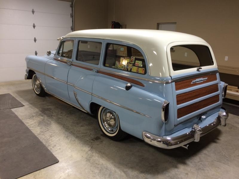

    A couple of more pics...
