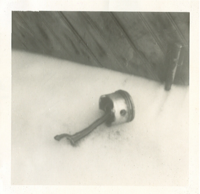

  5. AngleDrive
    Joined: Mar 9, 2006
    Posts: 827
    AngleDrive
    from Florida
  6. Dick Stevens
    Joined: Aug 7, 2012
    Posts: 2,930
    Dick Stevens
    Now tell us the rest of the story! Please?
  7. AngleDrive
    Joined: Mar 9, 2006
    Posts: 827
    AngleDrive
    from Florida
    Long time ago, 1959, owner was street racing. Welded 4 1/4 crank, full floating bearings. Stud most likely broke.
