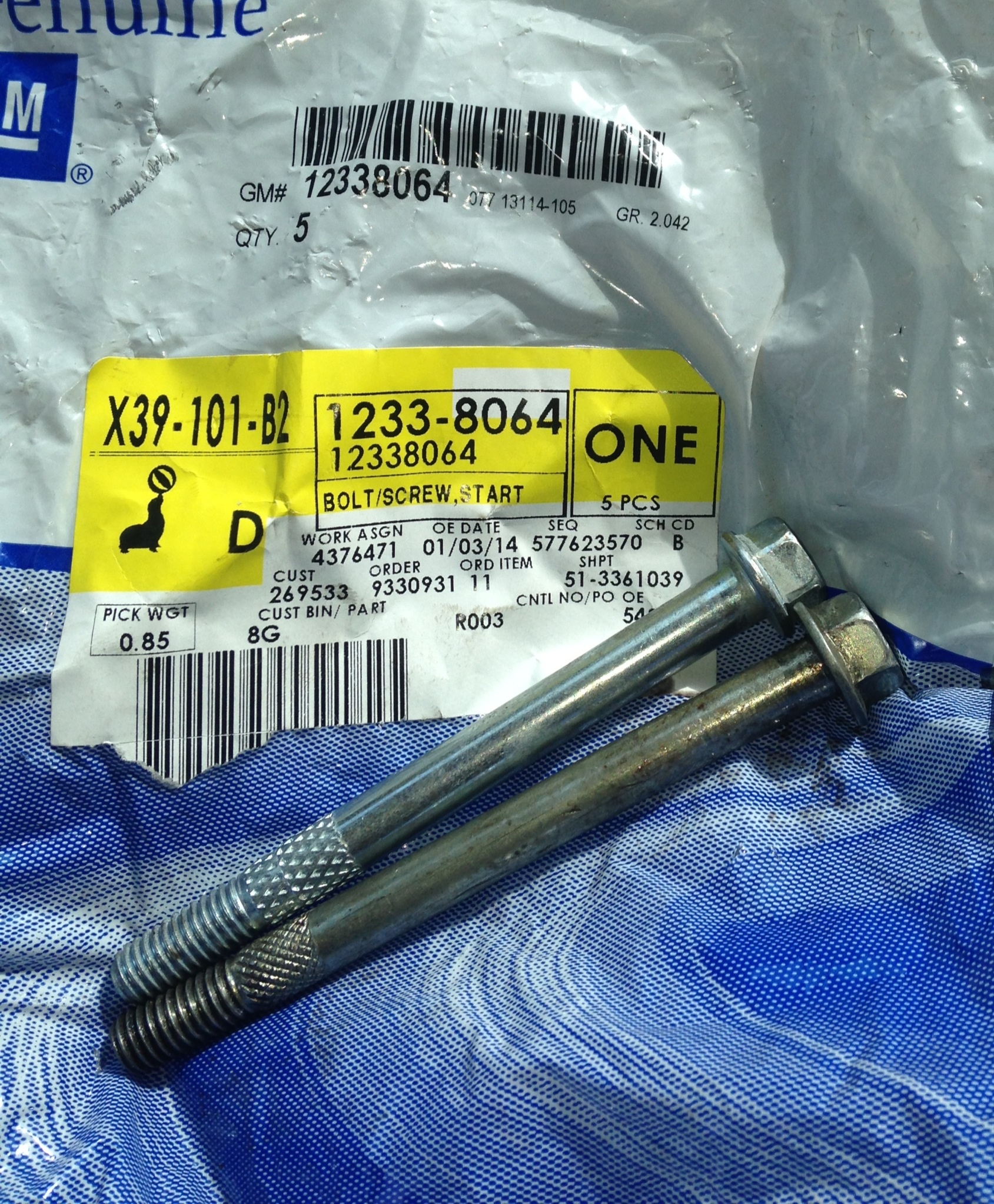

  3. Good suggestion,
    make sure you get the correct bolts as it is critical with those starters.
    So far throughout my colorful travels I've only found the dealer to have the correct bolts that work without issue. Expand quote
    stimpy likes this.
  4. stimpy
    Joined: Apr 16, 2006
    Posts: 3,547
    stimpy
    yea forgot all about the fitmit issue , the dorman bolts suck .
    and torque the bolts with a torque wrench , the new starters do not like to be squeezed too tight as they have tight clearances in the reduction section , IIRC its only 35 LBft is needed .

    $1.58? ..I would have thought $10 a pair...
  7. stimpy
    Posts: 3,547
    stimpy
    sometimes the dealer is cheap on there stuff like bolts and gaskets , but there are some specialty bolts I have gotten that were 4-5 bucks or more each but they were the only place to get them ,and often had to be ordered .
