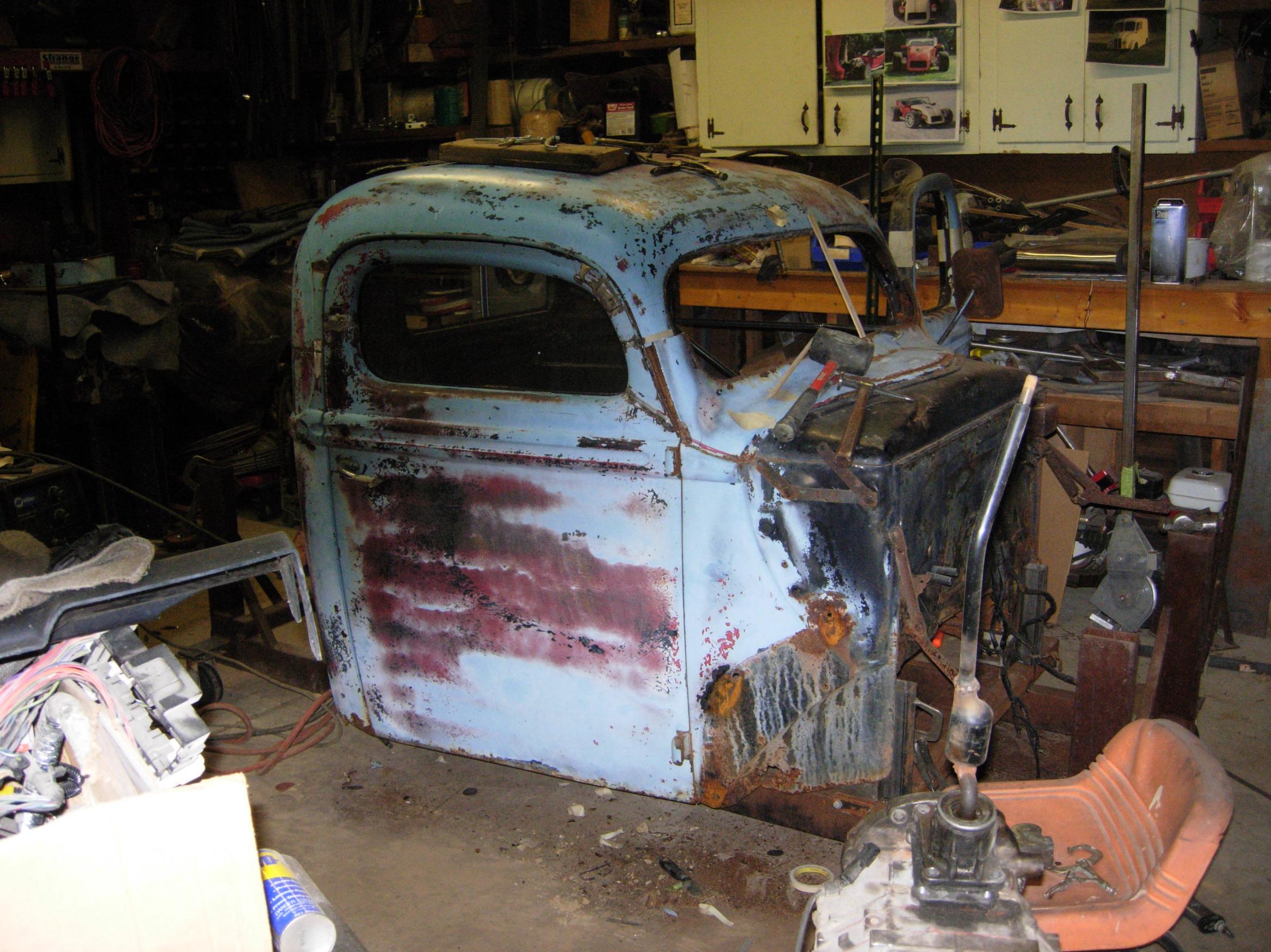

    The cab from what I can see is pretty solid, the front end needs to go and replace it with a dropped axle. Bobber trucks are ugly and I don't see what anyone sees in them but thats my oponion. I would put it on a differend frame or fix that on. You are going to get limited love for that so called truck on this site, it is not what we are about.

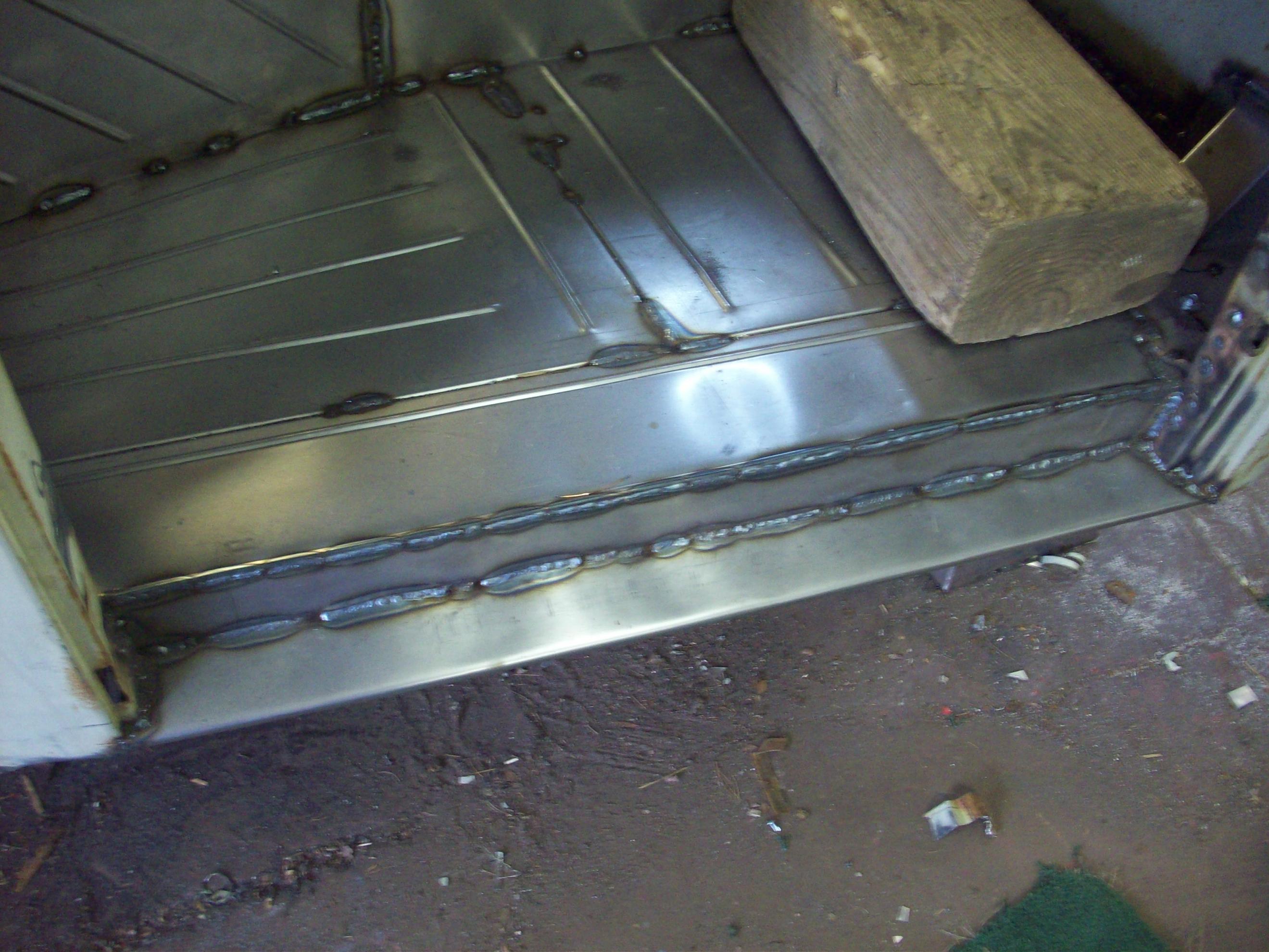

    more pics of the build. have the floor and rockers done body lowered on frame, motor mounts and trans mount in. my plans for the floor are to put fatmat down then a layer of .050 aluminum with a multitude of beads in it to look like a race car interior. put a picture of my bead roller i modified with a winch motor which kicks a** and rolls 18 gauge with no problem. have to take 5 inches off the bottom of each door next. running a t5 transmission so i had to put the trans mount at an angle as the trans was tilted in a camaro for ground clearance.
  21. Here is the perfect chop !

  24. Great looking floor! Any details on the bead roller?

    bead roller i made from looking at others on metal meet forums www.metalmeet.com/forum/index.php it works great uses a hf winch which i picked up for 50 bucks made the bead roller myself a while ago but you could buy one from hf and just beef it up .

    The frame looks really strange going up at an angle and I can't say I'm a fan of bobber trucks. I would say a stock frame would look better, your frame looks too thin for the overall look and doesn't flow.
