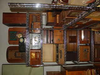

  27. Bluto
    Joined: Feb 15, 2005
    Posts: 5,113
    Bluto
    I gotta unpack the rest ..... I'll find it...... this is about 25%-0-my radios
    I think I got that tool in the cabnet refinishing kit
