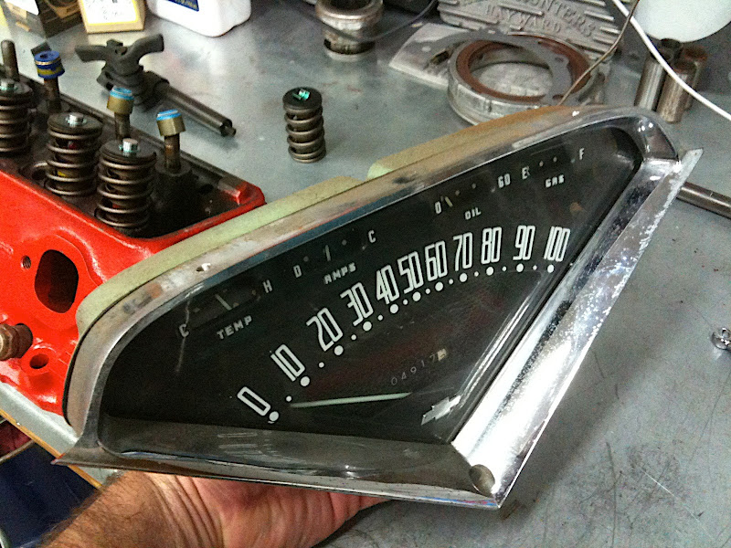

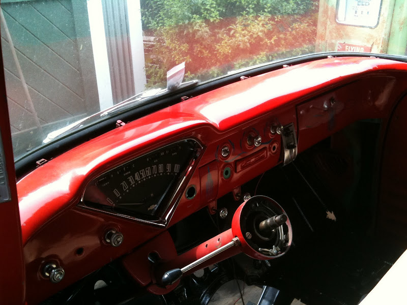

    Next up to bat was the dash panel. I noticed that the temp gauge was dangling inside the unit but thankfully the truck came with a new temp/amp gauge set. So I pulled the whole thing apart and cleaned it really well. Installed the new gauge set and then buttoned it back up using a new shinny chrome bezel. These little dash units are super sweet! They do have little cardboard tubes with a thin green lens on them for the turn indicators. You need to look at these and rotate them such that the light will shine thru an un disturbed section of the lens. Mine had been used for so long that they had actually burned right thru the coloring and were basically white. They should be nice and bright now just as they should be... Here's some pics:
    Here it is all done and ready to install.... Love that Chrome!!!

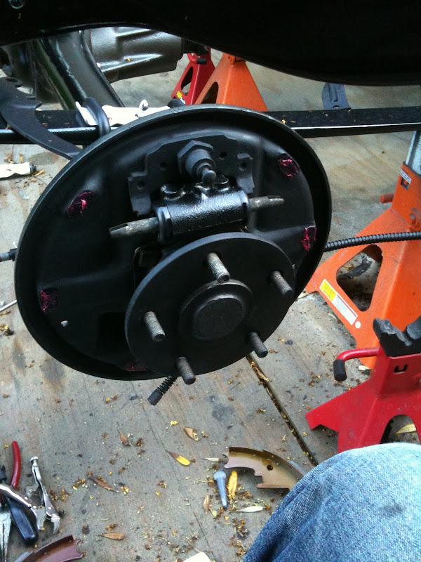

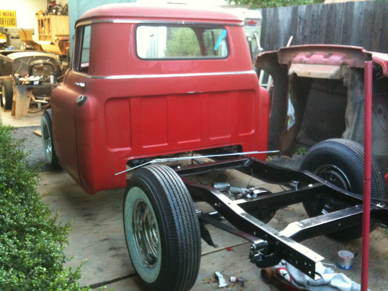

    HELL YEAH!!!! I'm back on 4 wheels!!!! 41 days since the start of the project and the rear wheels went on tonight. Yeah I had to do the brakes first and that was a treat... But they are good to go and the tires are all on the ground.
    Pics:
    A little grease on the wear surfaces...
    Then jam all this shit together.... Notice the self adjuster mechanism now installed. I don't really like how the spring is retained at the top but I'm sure it will be fine. Here is the done deal:
    Then on goes the tires and off the stands we go!!! It's going to sit just right. Need a bit of weight in the front, which will come from the SBC next week. But otherwise its golden.

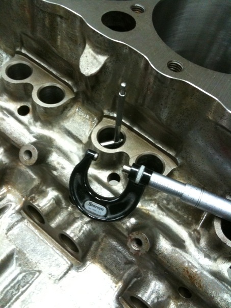

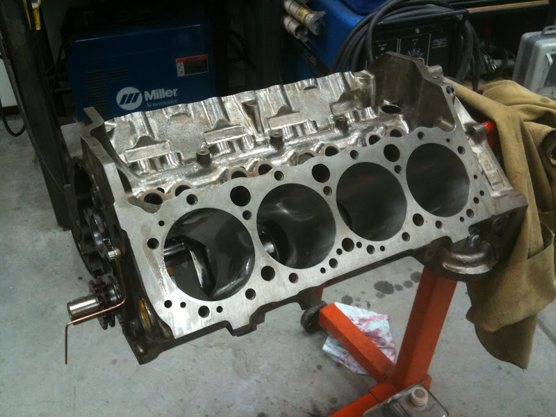

    Finally tonight I tore back into the motor after getting yet another fucked set of lifters.... I'm not going to go into that in detail but I will say I'm less then happy with aftermarket parts folks right now.... I re checked all the bores and did a clean up hone to 0.8440" Yes the 4th decimal place is important.... lifters need to run at 0.0015" to 0.002" clearance. I'm now set for 0.0015" on the number... tore the whole damn thing apart this evening and then honed, checked, cleaned the lifter bores and surrounding areas... Then jammed the crank back in. This will be buttoned back up by the end of the week.

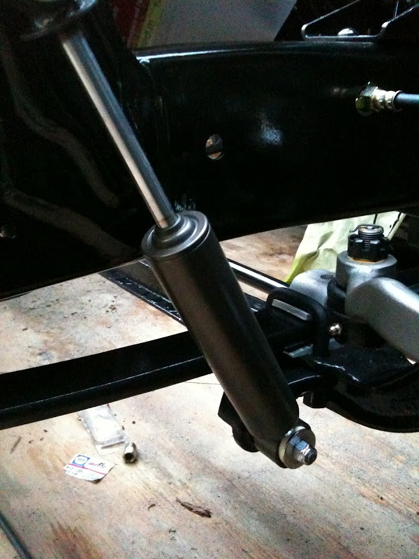

    Not a bunch but the key thing is to keep moving right? The truck came with brand new shocks for all 4 corners but when I went to use them it seemed like somebody sold this guy the wrong deal. The rears were perfect for the front and the fronts are perfect for??? I'm not sure. So I headed over to the parts house and picked up a set from a 1960's era chevy truck for the back. They seemed about right with the closed and open measurements to work. Painted up all that and bolted them on. I couldn't just leave them the stock colors..... So thats all done and good at this point.
    I still need to make the rear brake line that spans the rear-end housing as well as tie in the rear circuit to the prop valve but it seems like by the time I get around to that its too late in the evening which means its too dark outside. Hopefully these will get done tonight and maybe just maybe I will get the brakes wrapped up.

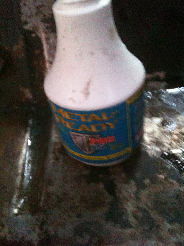

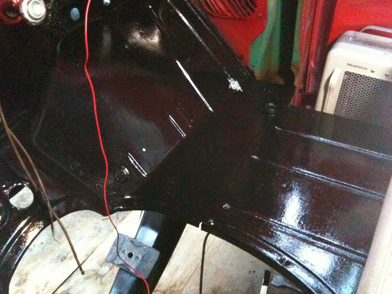

    Last night however I was determined to do my prep work on the cab floor and get the rust situation under control. Getting this done plus prepping and giving the firewall backside a good coat of paint is really key right now. There is a ton of shit thats about to go down inside the cab and all of this dirty work needs to be done. I have finally stripped the remaining bit from the firewall like the heater assy and all the old firewall pad. Wire brushed the entire thing plus vacuumed like 300 times to just get all the loose stuff outta there.
    Next comes the magic product.... POR-15. Lots of good words on here about this so what the hell??? I'll try it. There is one spot that is rusted really bad in the corner but the remaining parts are really just heavy surface rust. Regardless I want to stop this in its tracks and get some form of unity on the floor. I have a complete sound deadening kit for this that needs to be in here and it requires a clean surface to stick to.
    I wish I had some additional pics of the progress but I have been going kinda fast and have missed a few here and there..... The last thing that was messed with last night is truly understanding what's going on with this wiring harness. I now know.... And I'm ready.... I laid the thing out and started to divvy up who goes where. I think I have determined all the routes I'm going to take and its just a matter of getting the panel mounted and then sending the spaghetti on its way. AH HA! Can't mount the damn panel until the firewall is done!!! Hence all the nasty shit mentioned above. Here's my rats nest:

    WOW.... Just put the first coat on the floor of the true POR-15 top coat... I'm a fan... Nice Shit! I turned the heater on in the cab at 5:00 this morning and let things get up to temp and happy. I just blasted out there and brushed on the first coat and I'm nothing but impressed. Really looks good and was already laying flat for me. Maybe one more coat before heading to work. We'll see. If not lunch time.

    I forgot to mention that I scrapped and cleaned the underside of the cab last night as well and finished applying my fresh undercoating to the floor.
    Race home at lunch today to 2nd coat the POR-15 and then get ready for what comes next!

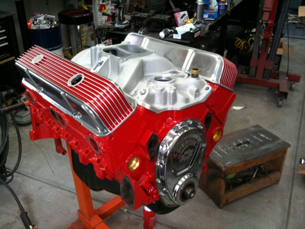

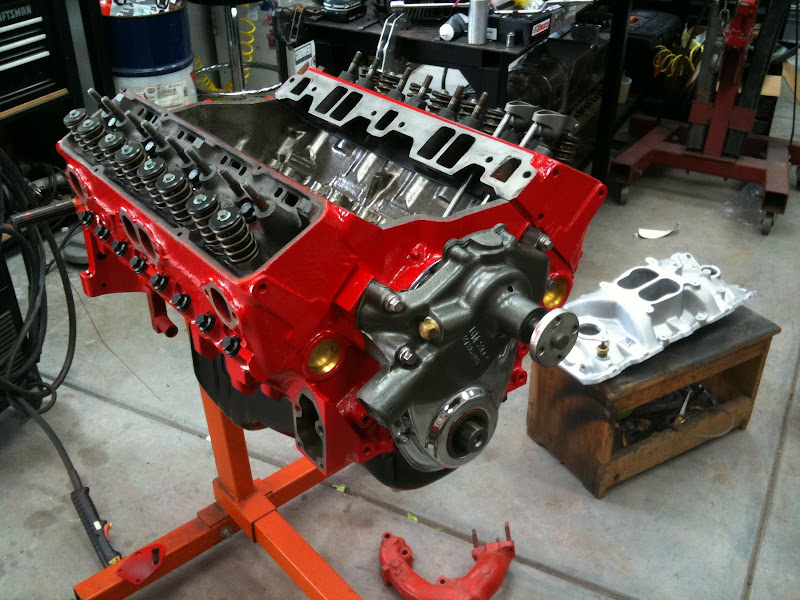

    The engine has been the main focus over the past few days... I am happy to report that its almost ready to go back in. Here's some pics of the fresh unit:
    All the little shit that mast be painted and detailed then bolted on... Water pump, fuel pump, yadda yadda....

    Last night I wanted to slow down a touch and I polished the dash. It shined up really well and After the stock radio goes in I think it will look killer. I also polished the doors and changed out all the screws to new Stainless ones. Very snazzy...
    Here's a few pics of that as well:

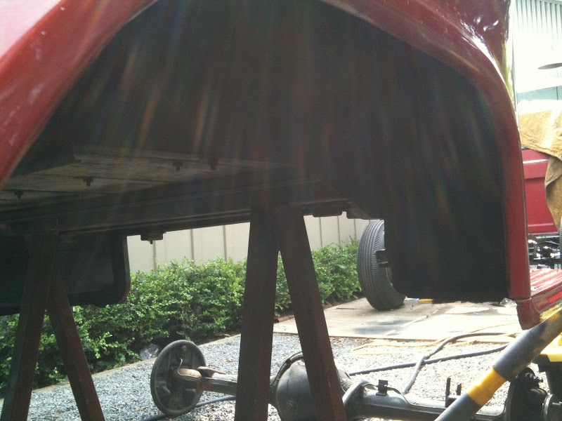

    Will this Damn Rain ever stop???? I'm sad that the motor is not in the chassis yet but also thankful at the same time that its not! It rained like a cow piss'n on a flat rock here yesterday. UGHHHHHH......
    So take advantage of that rain and wash the cab of all its old funky grunge! I did just that and now its ready for the Wifey Poo to polish it all up. I went ahead and dick'ed around inside the shop last night doing last minute tinkering with the motor. All the little dumb shit like, adjusting valves, oil filer on, priming the oil pump, yadda yadda... I think it's ready to come off the stand tonight and get the clutch/bell housing/ tranny bolted up. "I think..."
    But better keep it out of the frame until thursday because there is another rain storm on the way! This has been a weird year for the weather.

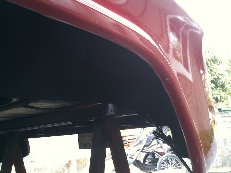

    So I zipped home really quick today at lunch and was able to shoot the inside of the front fenders to match the bed. These pics will show the contrast a little better... This will look so pro once they are on the truck. I love blacked out wheel wells!
    Sunday night we made out first full attempt at bleeding the brakes. That's always a hoot... So the front brake lines that go to the calipers are just slightly non symmetrical.... Why does this matter? Well when they go on the wrong way the line actually hits the caliper and cocks a little. This makes it so you don't get an even load on the soft copper washer and WHAMO! Big Leak. OK, anneal the washers and flip them around. Try it again and one side is fine but the other still leaks. AH well thats because the end of the hose is made ever so slightly too big to fit into the round recess area on the caliper. So when this gets tightened up it bottoms out a little on the end and yet again does not crush the washer completely. Out comes the grinder and we are back in business. No leaks up there any more. There is a few little weeps still coming from down on the prop valve but I'm not totally sure whats going on there. Either I have shitty flares still or the backing nut is bottoming out the threads before properly crushing the cone into place. I'll look again here shortly. Key part is my helper... Her she is in the main seat waiting to push that pedal. Nothing like a glass of Pinot to go with bleeding your brakes.
    Otherwise there is nothing else to really show pictures of right now... Trust me that I'm work'n me ARSE off but I feel like nothing is really getting done!!!! PRAY FOR SUNSHINE AND A MIRACLE.... I NEED BOTH.

    You should see them in person! I finished the rears like I posted on Sunday and about lost my mind... It is such a simple little trick but it looks beyond cool.

  24. What did you use on the fender wells? Undercoat? I tried some Napa undercoat, a few weeks later and it still isn't dry! Your fenders look great.

    I used the 3M stuff that comes in a can. Interesting part is that I first bought some when I built my '68 truck and it came in a white can. I ran out of that and got some new 3M stuff from NAPA. Well that was a green can. Ran out again and went back to the main paint shop to get more. RED can.... Who knows.... But it's all 3M and all can colors have been lovely. I ment to take a picture of the can but I forgot. Easy enough to go get some.
    Hope this helps.

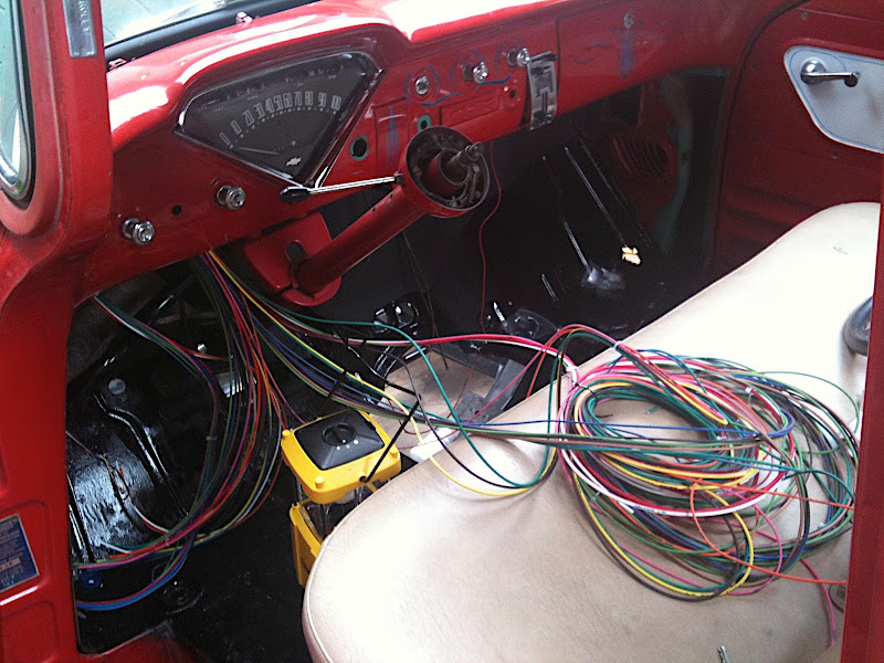

    The wiring is about to commence... I couldn't sleep last night so I hit the shop at 3:30 this morning. I finished the final details on the motor and took it off the stand.
    I will bolt up all the remaining shit tonight like, flywheel, bell housing tranny etc.... Here is the final shots of the motor prep stuff... I painted the ram horns VHT Flat white for that perfect mid 60's look. SO DAMN COOL.... It took the entire can of paint to shoot these last night. About 4 coats. I then baked them on top of the BBQ for about 30min. After they cooled from that I then transfered them inside the BBQ and cooked them a touch higher for 20 mins more. THey will get their final cure on the motor. Hopefully it will work well.

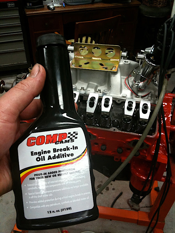

    The engine needed its oil system primed and for that I was lucky to borrow a sweet system from my local engine builder. This pressure pot gets about 3 qts of oil poured in and then you charge it up with 80 to 100psi of air. Hook the line into the oil sending unit port and then kick the valve open. In just 5 mins the entire oil system was rammed full of oil and it actually pushed all the way up thru the rocker arms. I rotated the engine 1 time to ensure it went thru all the holes and then I was done.
    Next don't forget you super Zinc Additive.... Otherwise you get a flat cam ASAP....

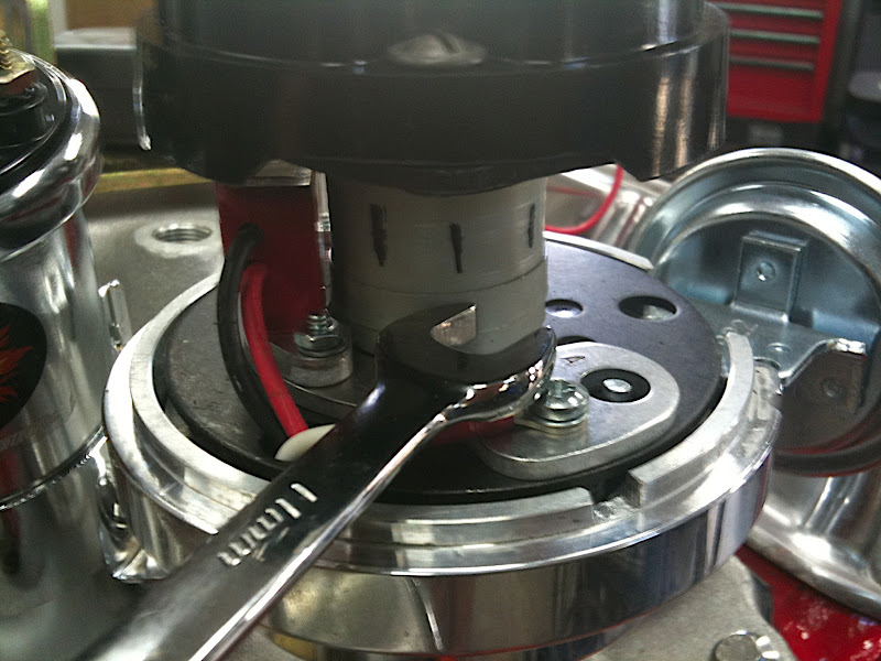

    The final piece was setting the rough timing and dropping in the distributor. This Pertronix unit doesn't have any indication as to where the magnets are at to accurately locate the point in which it trips the sensor. "Like opening the points" So I took a wrench and moved it around until I saw it snap to the center hub. I marked each one and then went about lining things up. I put the engine at about 12 degrees BTDC and then lined up the magnet mark with the pick-up. I know it's not perfect but I'll bet its right on for firing up without any BS.
    After that I finished up my mounting scheme for the fuse panel. I wanted it to be tucked up in the driver side corner because the wiring bundles seem to fall naturally into the right places. But the Rebel Kit needs to be spaced off the sheet metal a touch for clearance on the back side for the wires. I took a few chunks of alum that were about 3/4" x 1" and ran them under the 3 fuse block modules. I wanted to mount all 3 of the fuse block sections solidly so I laid out the blocks and popped 3 holes in each. The outside holes were drilled all the way thru the block and serve as my mount holes for the entire deal. After this was drilled and tapped I keyed the whole thing off of an existing hole in the firewall and then marked/drilled the remaining holes. Now the alum blocks are mounted up solid to the inside of the firewall and once I finish tucking the firewall pad in and around these I will reinstall the panel and start routing the wires accordingly. This wiring harness is such a slick way to go... Same thing with a painless etc. but once you pick that magic spot for the panel it's pretty much Blow And Go at that point. It seems like the hardest part is just keeping things happy and pretty as you are making your way from the panel out to the various destinations.
    Oh yes and of course the tricky little part about solving some of the original switch mysteries and how they work with the rebel harness..... Mr. 1959apache gets the gold star for that one.
    In the past I have painfully tried to route my wires as tight as I possibly can and have made it damn near impossible for taking things back apart again due to wire lengths being EXACTLY what they need to be. I'm not doing that this time. I promise it will be clean but I'm not going to go APE SHIT on the thing. Think GENTLE CURVES this time around.... Only makes for a bitch later on if something needs to be accessed or changed. Here's a pic of the beginning.... I will clean this up... Promise...

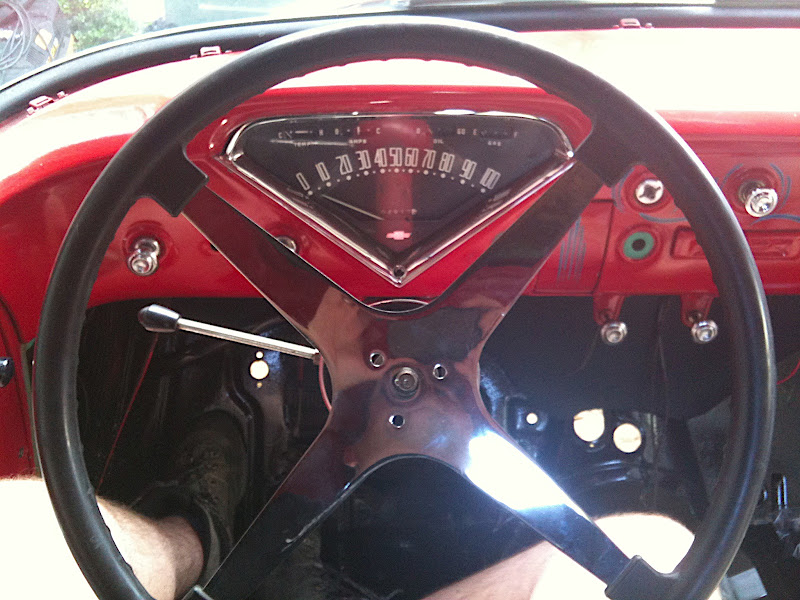

    Ah.... I almost forgot... One more pic for a little tease. I got the steering wheel last night. The Bell 17" from SoCal SpeedShop. I thought this would just be the thing for a touch of custom detail on this thing. Still big like the stocker but total cool HotRod shit. This is about to be my view each day when I drive to work.... :) :) :)
