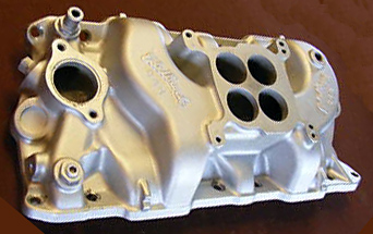

    1. Early Hemi Tech
    You will like that CB4. Those old Edelbrocks are really nice. The passages were bigger on the old style intake (I've got a couple :cool:)
    Here's a link for vintage Edelbrock intakes
    http://www.victorylibrary.com/mopar/edel.htm
    Your CB4

    THE-SYNDICATE
    I can't wait to bead blast it and get it all dialed in! It will be great on this little Chevy!

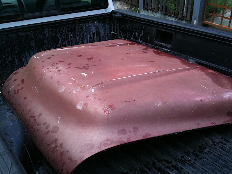

    Slow go this weekend.... But progress was still made! I just need to finish up the rear brakes tonight and then the wheel and tires can go on back there. I am making the rear drum brakes act as self adjusters vs the original version so I have to make damn sure I get all the parts in there correctly... When you don't do this every day these brakes can be a bit taxing on the mind... So I just called it on Saturday evening and figured I would get back on it today. I did manage to extract the old "new" wiring harness out of the truck.
    Take a look......
    Right... Well folks that's the back side of the ignition switch. and I think something went really wrong at some point. Bet this smelled neat inside the cab!!! The new harness should arrive today or tomorrow.
    Max and I loaded up early Sunday morning and drove out to this cool dude Larry's place to fetch up our '57 hood. Such a great deal because it was Mom's day and by getting the little one outta the house Erin could sleep in for hours and we could still eek out some progress on the truck! This guys Larry cooks us a full Pancake breakfast and then shows us all his loot! What a place! THen I give him my 2 old '56 hoods and he loads up our new '57. I just love these damn hoods!!!! The bullets are just what the doctor ordered.
    Here it is!
