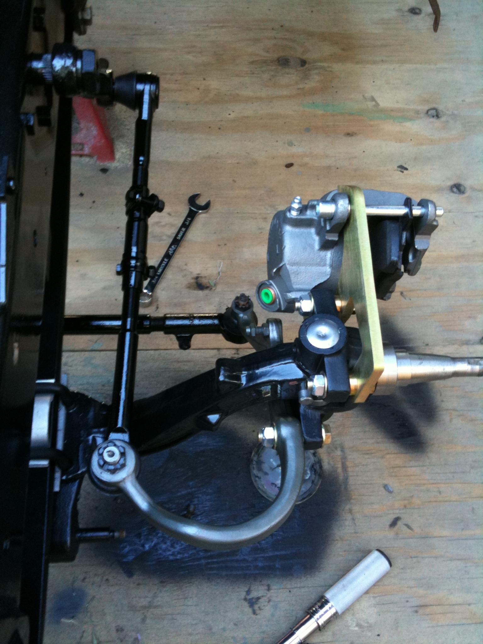

    Next Steering:
    So the super groovy deal on these things is to do the tie rod flip and use new modern style tie rod ends rather than the old ball and cup shit. Plus the tie rod will be perfect with regards to clearance under the leaf spring. I'm thankful this deal came with one!!!! But the kicker is that you need to get the damn balls out of the old steering arms. Hmmmm.....
    Here We Go!!!!
    Line this shit up in the old drill press and start small. I drilled like a 3/16" pilot hole down the center. You're in luck because the end of the ball has a center pop in it from the factory. Just make sure the whole thing is lined up right and drill it out. Then step up to a larger drill and hog the bitch out. I zoomed the bottom of this with a grinder to remove the old material that was peened over from the factory. Next I hit the end with a countersink just to remove a touch more material. Then get hot with the old punch and hammer! Outski!!! Done.
    Repeat other arm.
    Now the new tie rod will bolt right in!

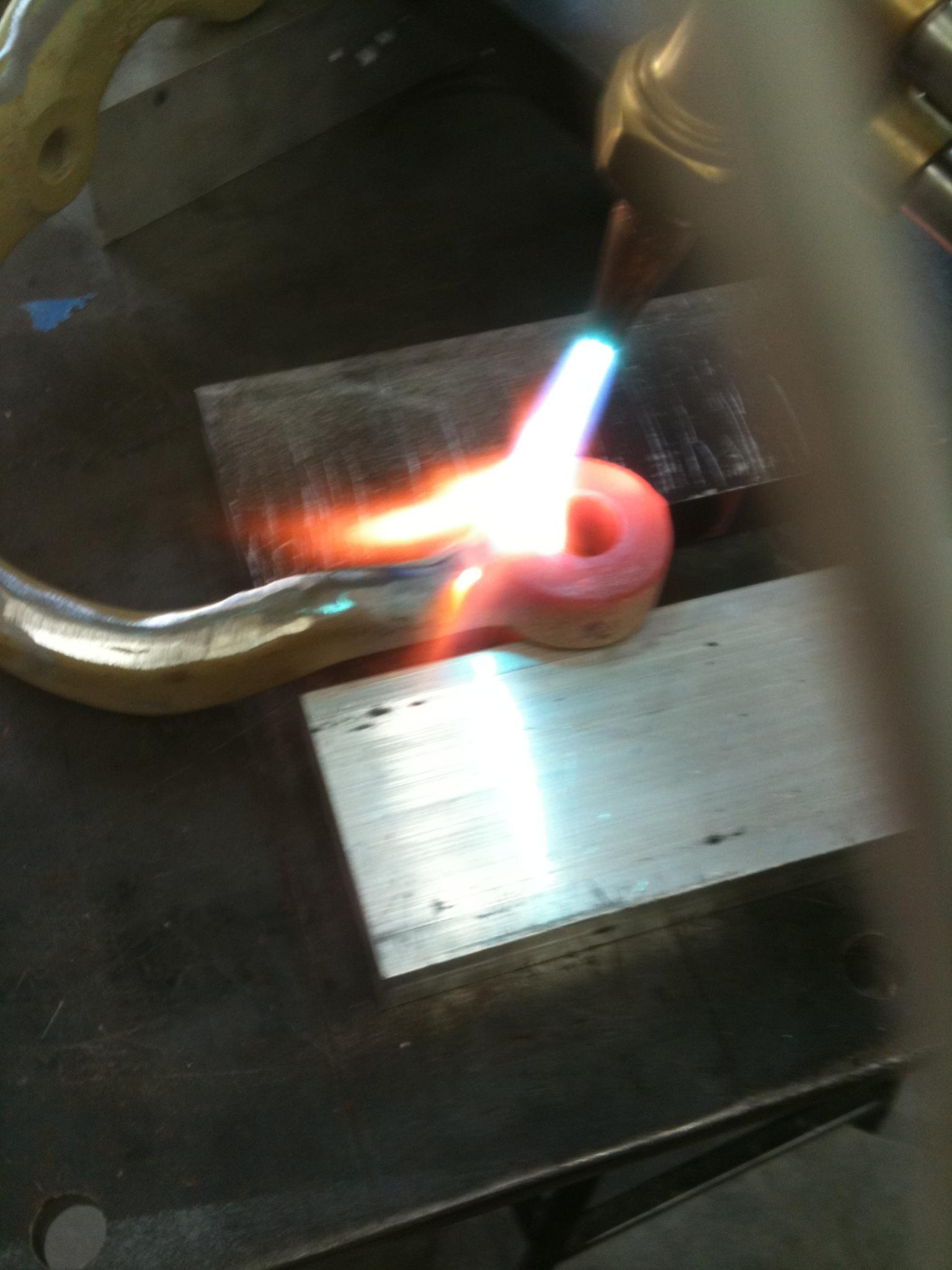

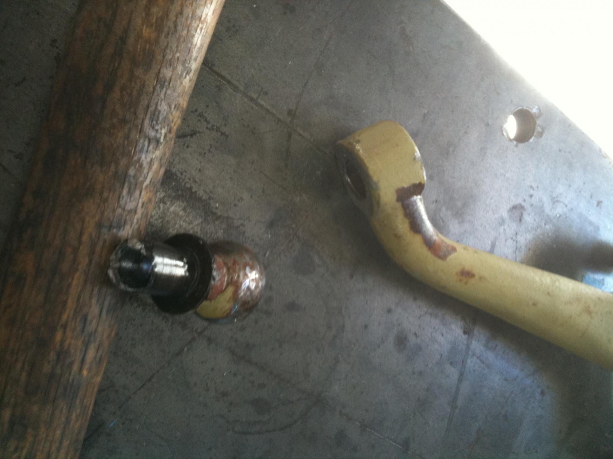

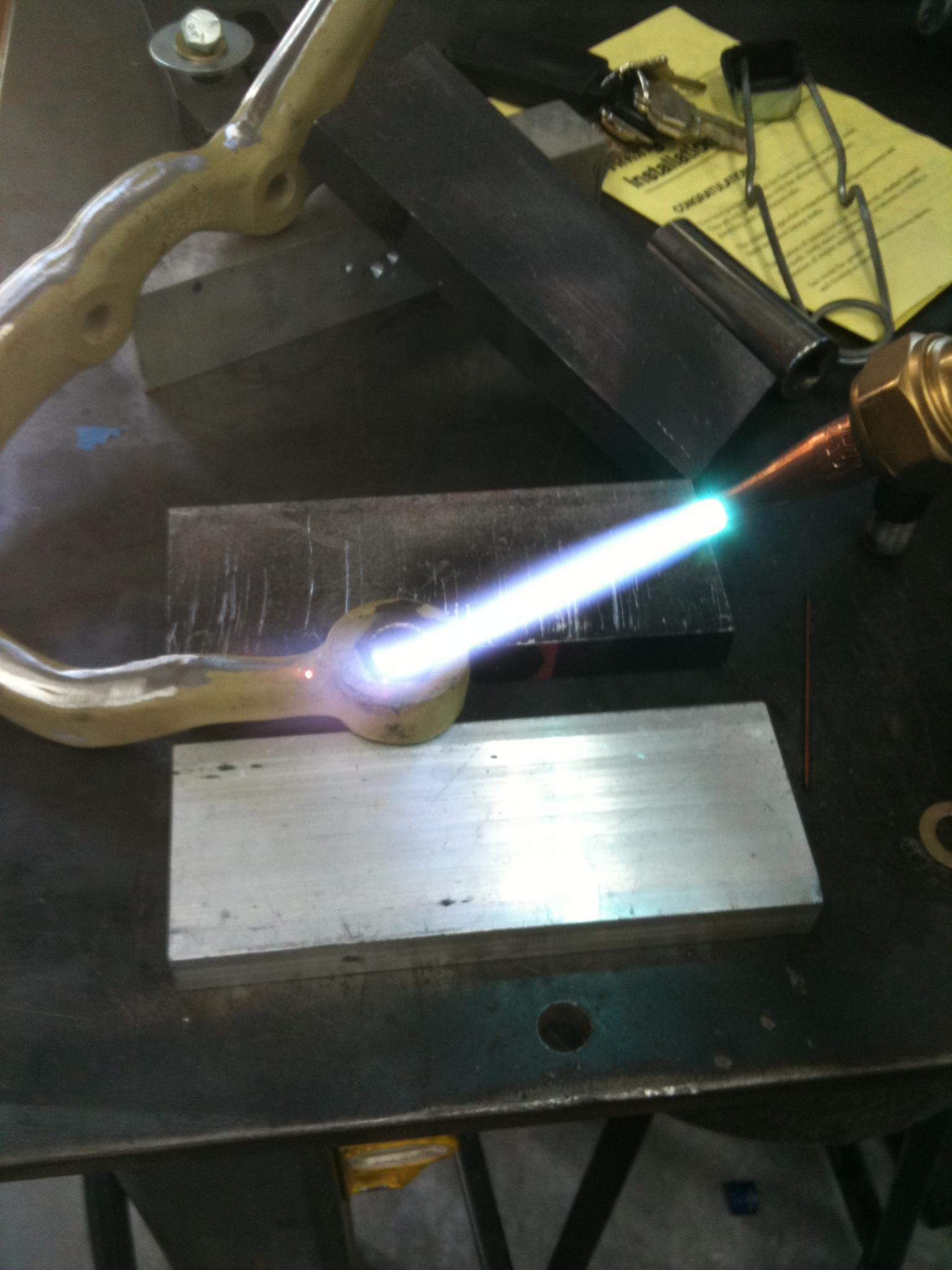

    And more steering... I need to contend with the drag link to make sure it's parallel to the frame and this will in turn help me to avoid bump steer. Well thanks to another super cool HAMB'er I was tipped off to SID's Dropped Axles and the drag link modification he does. I ordered one of his multi piece units for this as well that will allow me to center the steering wheel once I'm done. Very nice Guy with really nice stuff!
    However the trick is that you need to reverse the taper in the steering arm.
    TORCH TIME....
    First we need something to make the taper. Well that comes from the old drag link. I busted out the hand held BandSaw and did a little slice and dice. Out comes the perfect thing to forge the new taper.
    Next I wrapped my head around what I needed to do and set things up on the welding bench.
    Then light the GAS WRENCH and heat it up. Not like a MAD MAN but ever so slowly. No Crackle on the metal. Just a good red hot.
    Cross your fingers
    Drop the pin in the hole and WAIL on it with the sledge until the taper goes all the way in. This took a few reheats as the taper is really big on this one. Much different than doing a set of Ford Spindles. Those always seemed to be done in one shot but this took me 3 heats.
    So that's it for now, but once I grab a beer I will paint these and install everything tonight. That will pretty much wrap up the front end.

    Note: The picture in the last post shows the Drag Link in the stock config. It's really running up hill and thats the bad part. I will show pics of the new unit here in a few hours after my round of Cocktails.

    So here we go with the final installment for the day. The steering arms are all gucci'ed out and painted as well as the drag link and tie rod. Flipping the drag link around was just the ticket. It will be perfectly level with the frame once the weight gets on the front end. I need to put new zerk fittings in here and there as well as cotter pins in the various locations but otherwise all other bolts are torqued properly and ths part of the truck is put to bed!!!!!!
    Time for drinks.

    just read the stuff about the draglink, very cool, never thought of heating the taper like that. Did you have to quinch the former in between heats? Enjoyable writeup style as well, very readable.

    No Quenching at all.... Just re heat for each time and then walk away once its finished to let it naturally cool. I'm pretty sure a quench would induce a crack. Either visible or worse off invisible. The drag link really was a slick process that I owe "Dave K" a big thanks for leading me to it. He followed this path on his '59 and had all thumbs up for the finished product.

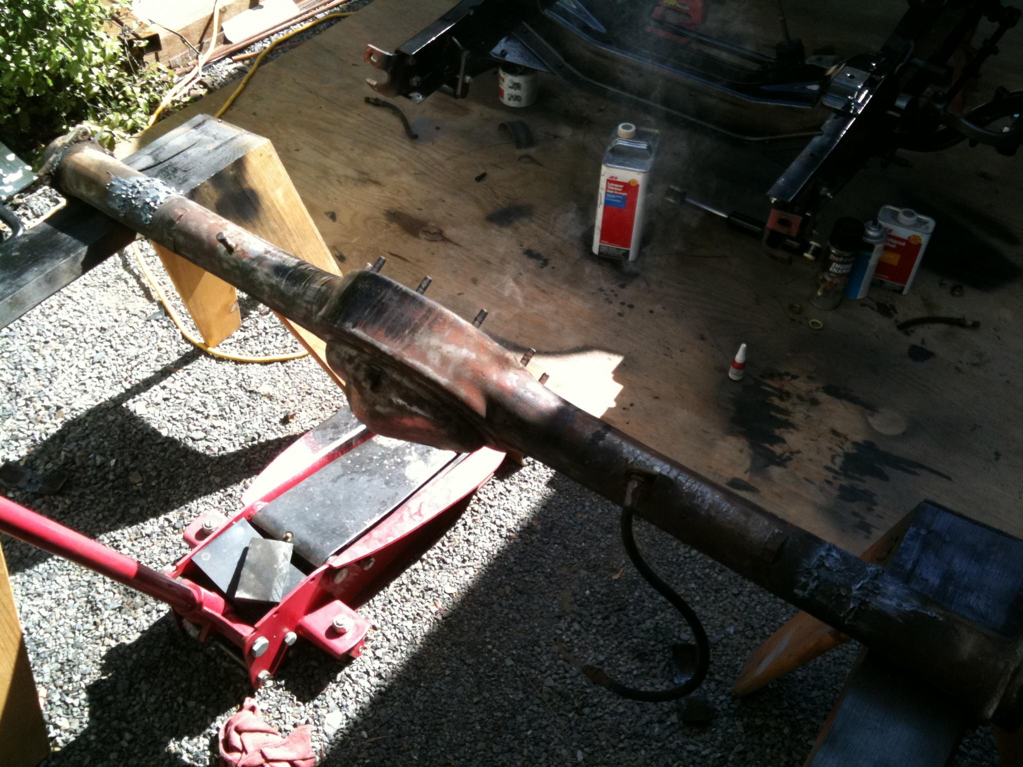

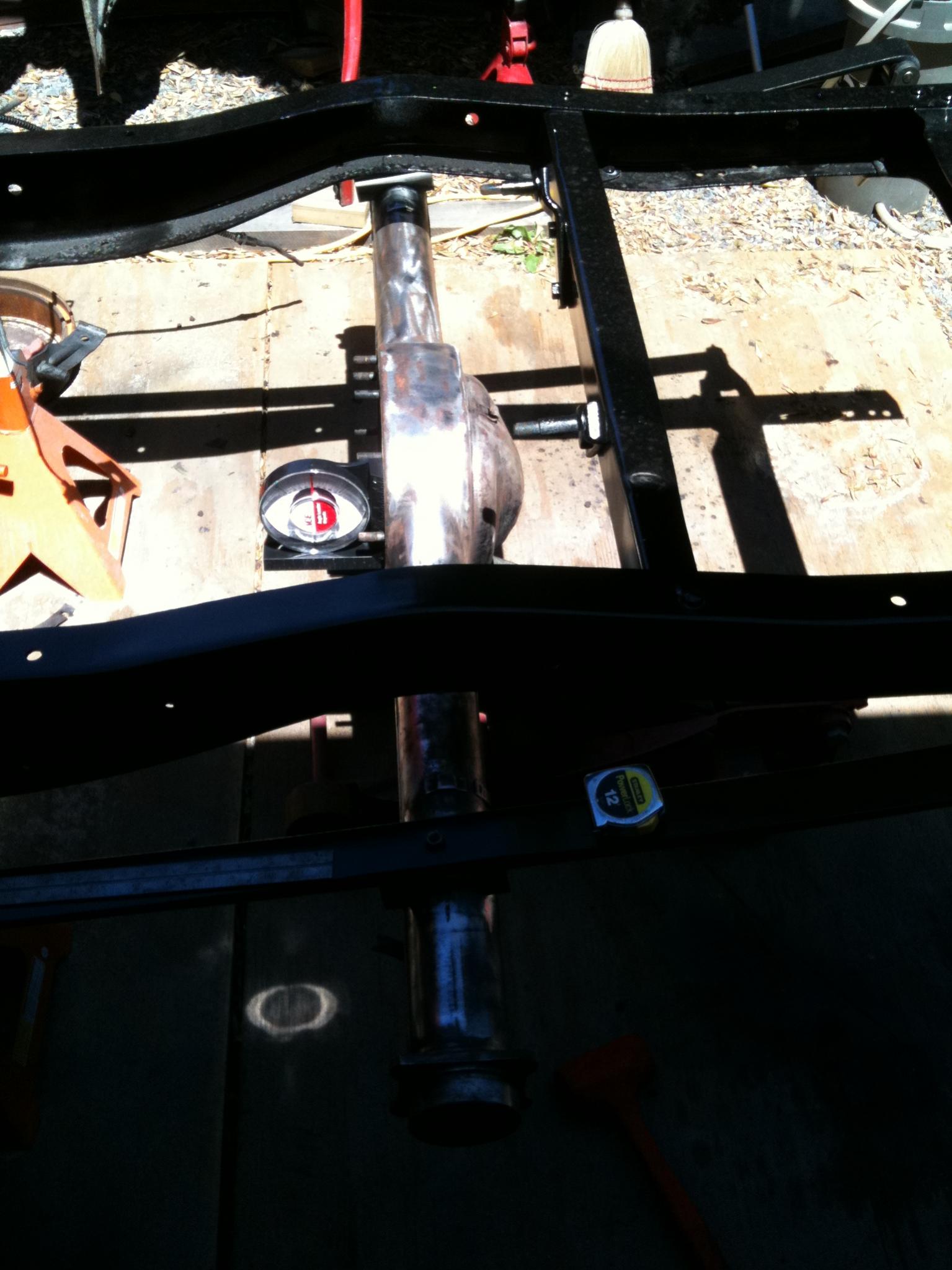

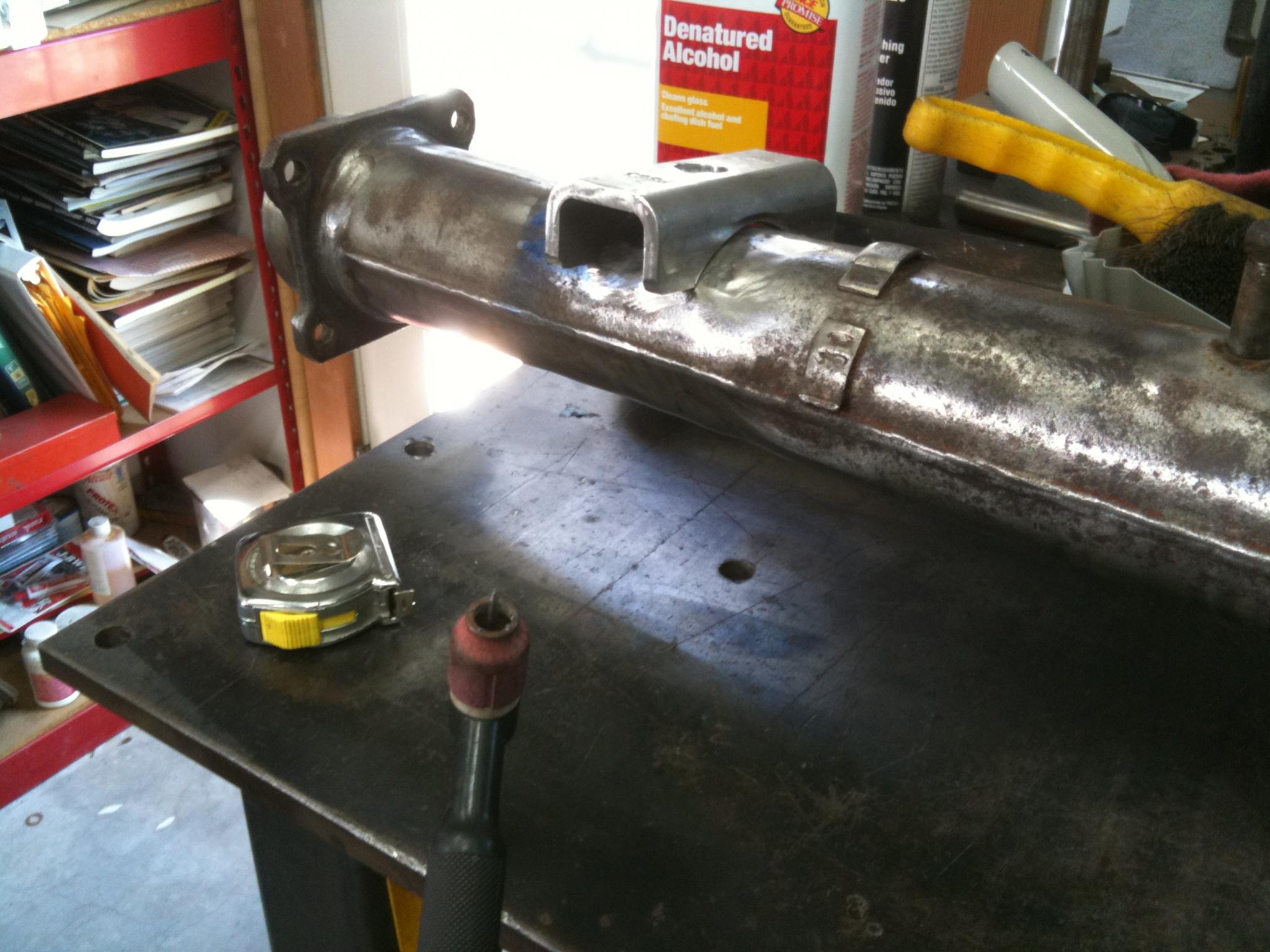

    So the first half of the day was spent on a little motor work like inspecting and installing the oil pump etc... Still waiting for my lifters... Hopefully they will show Monday or Tuesday.
    The real kicker today was dealing with the rear end. I thought the pads that were on it were going to work but not the case. They were off by about 4 degrees and we all know thats too much! I could have put 4 degree shims in but....
    So out comes the Gas Wrench and we torched em off!
    Then lots of grinding and cleaning as I would like the thing too look nice! BTW, I hate grinding.... I also scabbed off the little tab that carried the brake line T. I will doctor this up and re-weld it on in the new proper location.

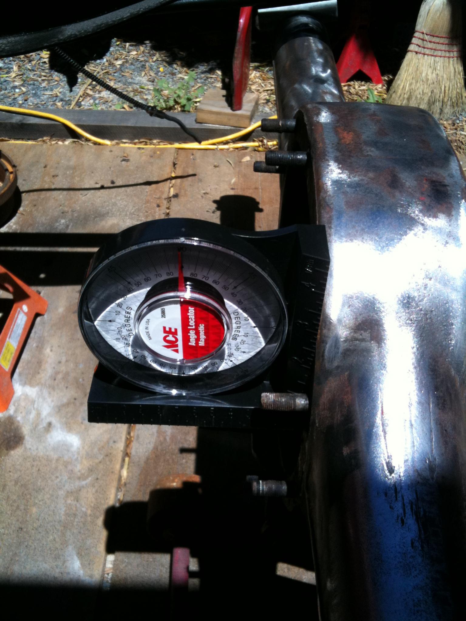

    After it was cleaned and prepped I took a look at the new saddles. Well they are slightly crude and come with a hole about a 1/4" too big for proper location on the center bolt. So I took a few washers that looked close and then opened the hole just a touch too match. Assembled all this onto the spring and then jacked the rear end in place.
    Time for Kodaks...
  15. THE-SYNDICATE
    Joined: May 13, 2003
    Posts: 796
    THE-SYNDICATE
    So just to be sure.... I tossed a block into the frame with the proper mounts... The tech line folks that sold me the Mono-Leafs were very casual about the pad angle on the rear end and said yeah stock is fine etc etc... Well they were right, as they should be but this didn't take too much time to do and I feel a shit load better now that its been checked.
    Typical deal of which everyone knows... Match the angles and your good! But because this is a leaf spring deal I did set the pinion about 1 degree down from the motor to allow for a slight twist during normal running down the road. Checked and Checked and Checked.... Measured the side to side and then marked everything really good. I'm going to remove this to do my tacking as I cannot get the welder out to this point in the driveway. But I used dykem and scribed it good so I shouldn't have issue repeating what's here.
    More news later on....

    Interesting thinking here - I like it! I occasionally have thought about this caster thing on mine too. I looked at my shop manual and from the factory they come with 1.5 degrees :eek:!! So there's definitely some room for improvement. I've driven some trucks with less than desirable caster and woo boy - hang on and be ready to react VERY quickly. I think this will affect over-all handling and get us a little closer to what we are use to today in our modern cars. Looks like you are on the right track given tire combo and over-all rake will affect this too. But it IS an old truck and that's part of having one! Good thread! :cool:

    Ah, I didn't see the 1.5 degrees anywhere in my books... But that's good to know. I think that these shims will help a ton on the finished product.
