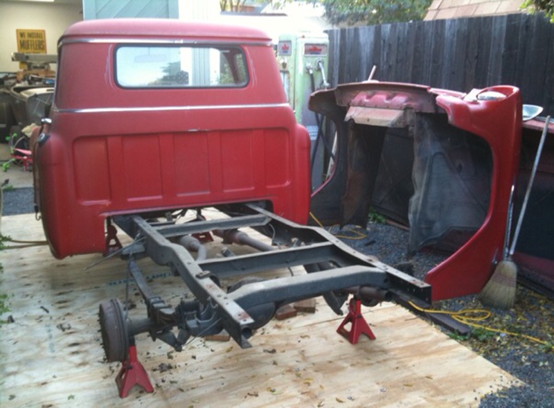

    Well..... Still chugging along! The past few days/evenings have been pretty solid!
    1. I have managed to get the bed off in one unit.
    2. Clean and Sand Blast the majority of the rear frame.
    3. Remove the old rear suspension. "This was a bitch by the way...."
    4. Received in the new Chrome Smoothie Wheels from Coker's Clearing house.... Shit Howdy they were cheap!
    5. Picked up the Crank and flywheel after a quick repolish and Balance check.
    6. Rounded up the Million dollar Primer to shoot on the frame after I get done blasting the rest.
    So.... This weekend should show much progress but I may need to bounce around on a few things. I will hopefully get the short block together and maybe get the frame in primer before another short blast of rain due Monday/Tuesday.
    Fingers crossed.... Here's a few pics of progress and my little helper!

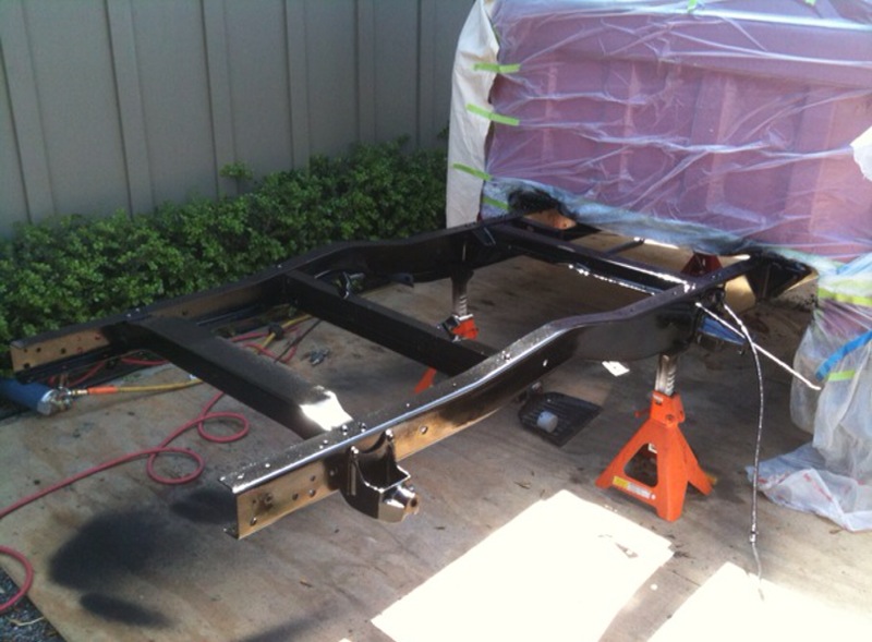

    Wow.... What a weekend... The entire frame has been cleaned as much as feasible and I was able to prime the bare metal yesterday under the cab and all the way out to the back. I woke up to a few little pissy things where the primer bubbled a touch so I got hot this AM and sanded the whole thing. I reshot primer where needed, sealed it and then laid on the BLACK.... I bought one of those 39.99 HVLP knock offs on Friday and I gotta tell ya! I would love to own a Bitchin Sata or like type but Dude... Fuck Me... This thing worked so sweet! I can't believe it. My old conventional gun will be going into the trash this evening. Here's a few pics for the Saturday and Today.
    This evening I will start stuffing the engine together.

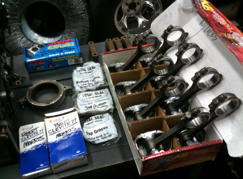

    Thanks Guys! I'm getting pretty excited to start putting things back together hopefully by the end of this week.... We will see? The block was cleaned tonight and placed back up on the stand for reassembly. I managed to lay out all the parts and get all the freeze plugs installed. I forgot that I ordered file-to-fit rings for this engine, Grrrrrr...., So I will have at least one whole night into making that shit fit..... But that's OK due to the fact that we are getting rain Monday/Tuesday... After that the front section of frame along with the firewall will get the magic black treatment and then we're done with painting for awhile.
    More news soon....
