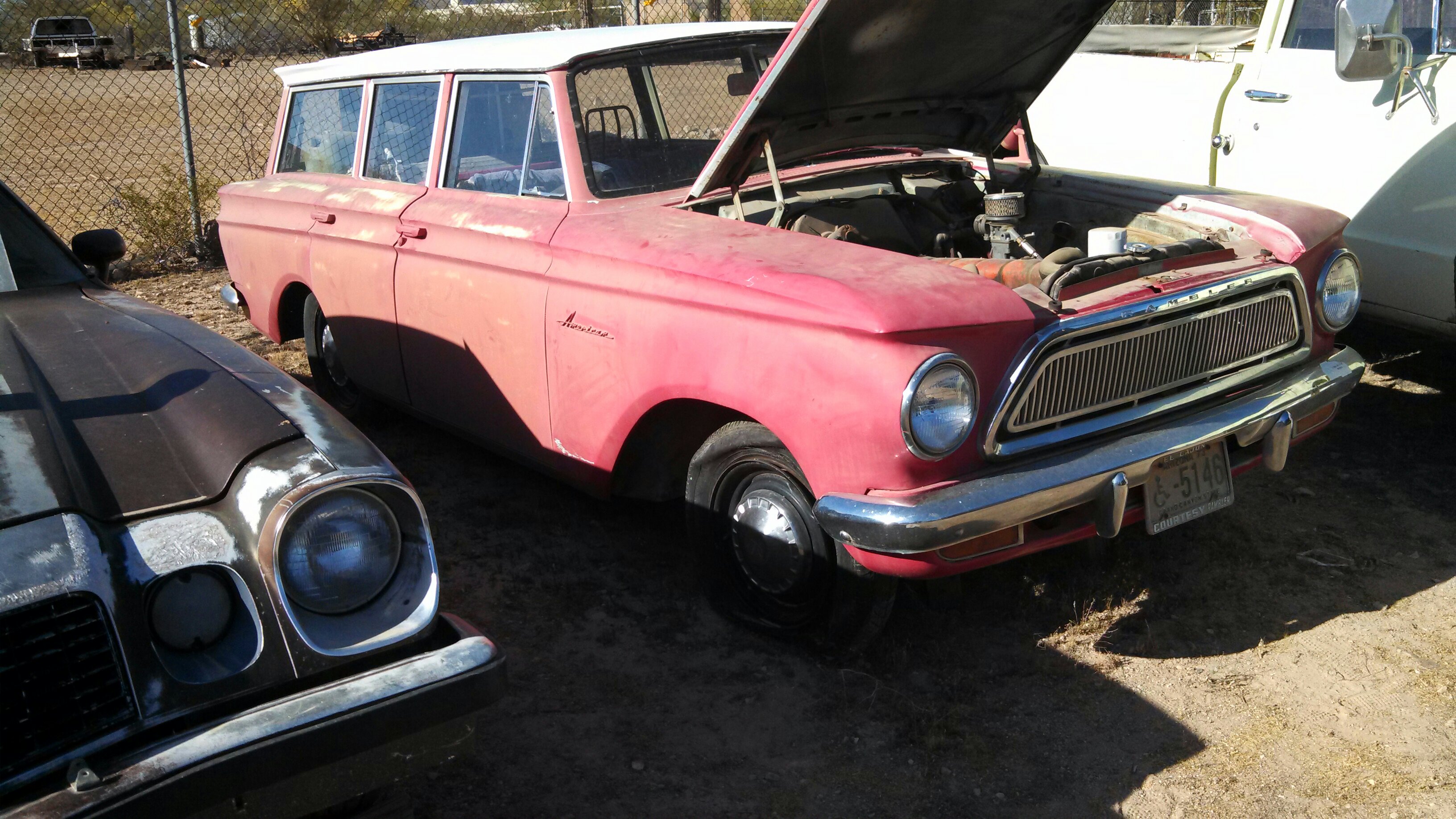

    Just picked up a 63 Rambler American wagon. It has been sitting in the Arizona sun since 2009. Started the clean up process to see what I got. Looks pretty solid with no rust. Thinking about a surfer style wagon build. IMG_20140518_110201_543.jpg

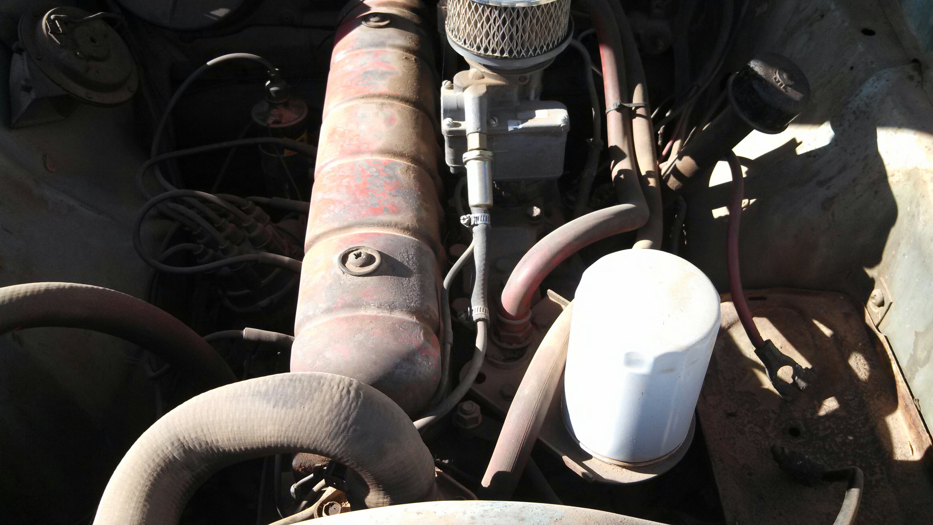

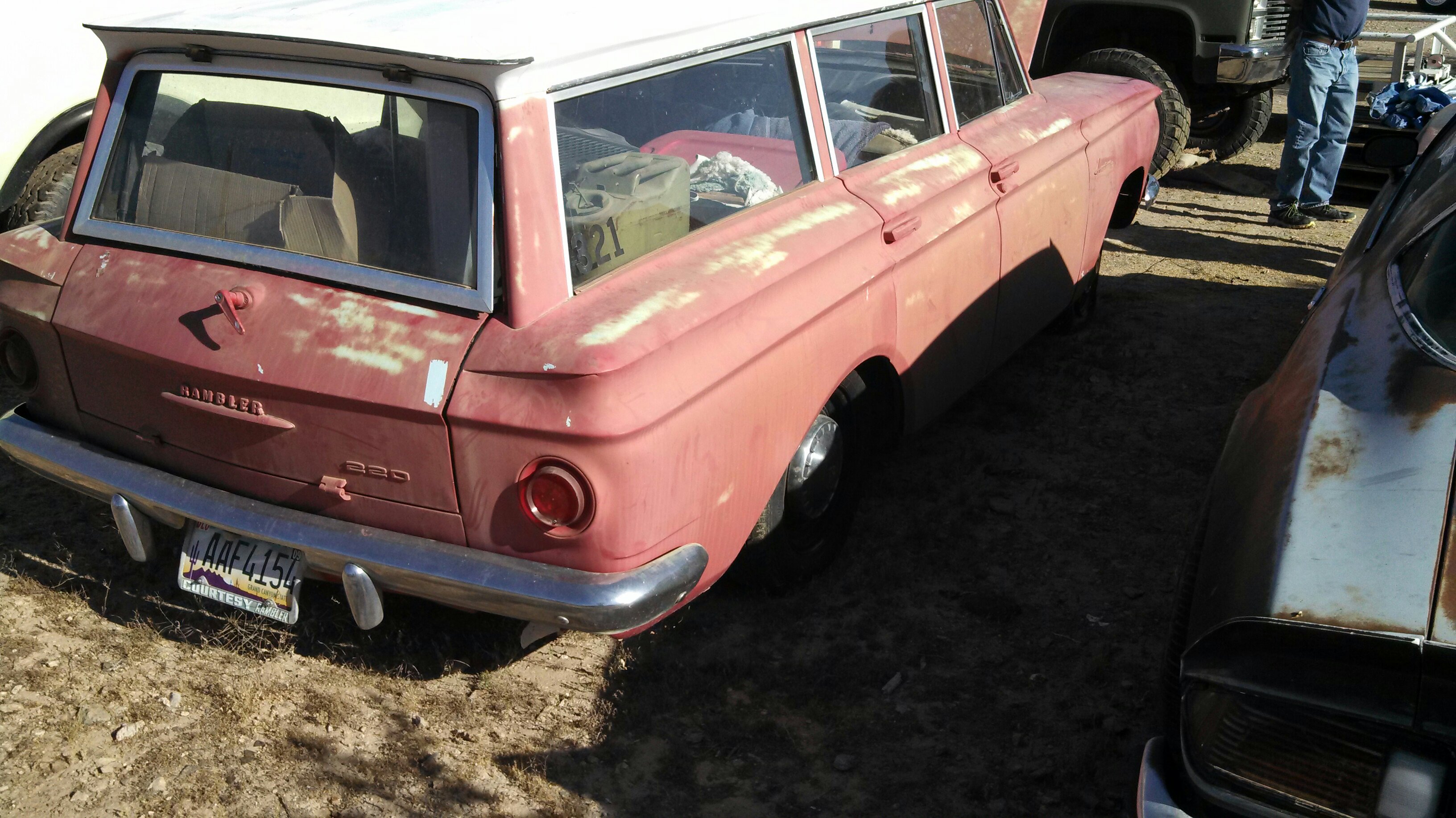

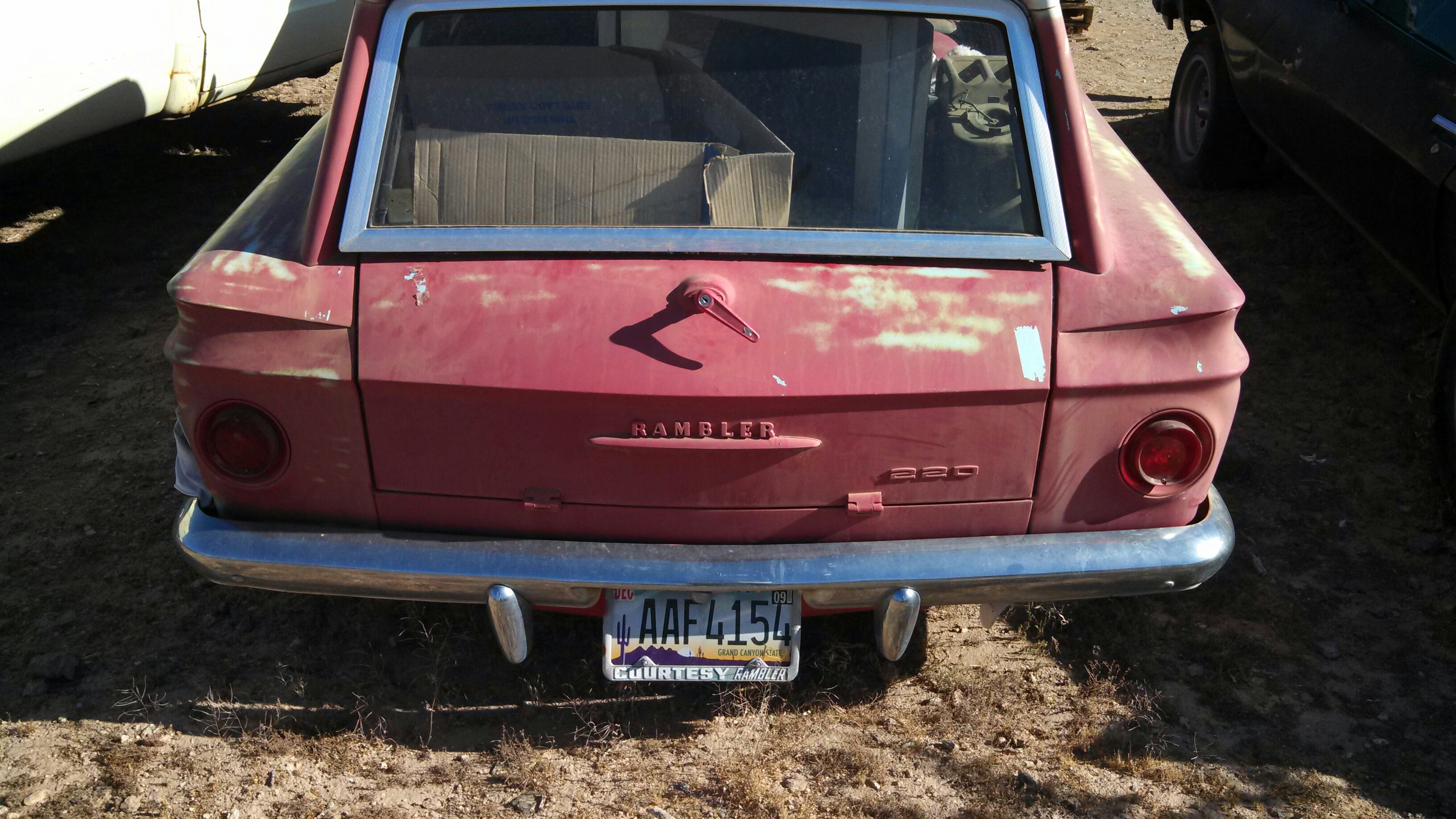

    Here are a few more pictures of my wagon when I picked it up. I have spent the last few weeks just scrubbing and cleaning. I was able to determine that it needs a fuel pump and then she will be running. Think I will re-torque the head bolts before firing it up. I have heard that this is important with the overhead valve engine. ResizedImage_1399779478713.jpg ResizedImage_1399779496908.jpg ResizedImage_1399779517671.jpg ResizedImage_1399779576606.jpg ResizedImage_1399779559982.jpg ResizedImage_1399779539540.jpg ResizedImage_1399779461117.jpg ResizedImage_1399779496908.jpg ResizedImage_1399779517671.jpg ResizedImage_1399779559982.jpg ResizedImage_1399779461117.jpg
  15. Looks like a great start.

  17. The body looks pretty good,keep us long roof guys updated. HRP

    I saw a thread a while back where a guy swapped in a 4.0 F/I engine from a Cherokee in one of these
    and made a great driver

    The 199/232/258/4.0L family of AMC/Jeep sixes is too long for the 50-55 Nash Rambler/58-63 Rambler American body (same chassis, just some different sheet metal!). It can be done, but you have to lose the factory heater to set the engine back about 3", and re-work the trans tunnel. A Ford 144/170/200/250 will fit by just making engine mounts -- those are about the same length as the 196 OHV and L-head (NOT the 240/300 Ford six though, too long!). ALL other US made I-6s and the Nissan 240/260/280 I-g are too long for that body. Any foreign I-6s that fit are generally smaller than the 196.
    DO re-torque that head!! The head bolts back out over time because of the head design. It is basically a converted L-head, though AMC did change the right side of the block in the valve/distributor area. The head is rather massive and expands/contracts a lot. The factory recommended checking torque every 4K miles, re-torque every 8K, but with modern gaskets (I think we can assume it's been changed over the last 50 years!) you can safely go 10-12K miles then just re-torque -- I did that for 14 years. If you don't drive it much re-torque every 3rd year regardless of miles. The lifters are solid and should be adjusted every 8-10K anyway, so I just did both while the valve cover was off. If you loosen then re-torque one bolt at a time you don't need to worry about using the torque pattern (unless of course they are all real loose). Torque head bolts to 60 ft/lbs (book says 58-62, back when they used beam type wrenches!).
    It's a good little six -- not real powerful, but rock steady reliable if you keep up with maintenance. See http://worldpowersystems.com/AMC/index.html for lots of tips and tricks for the 196 OHV and the little American.
