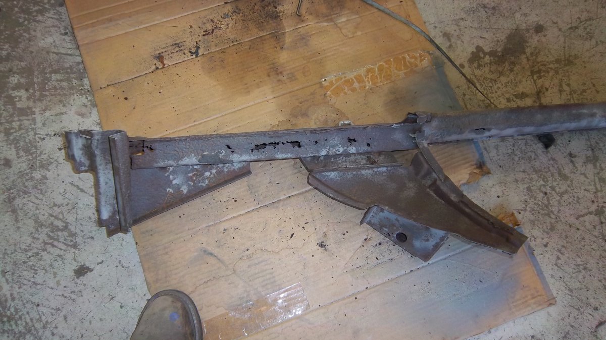

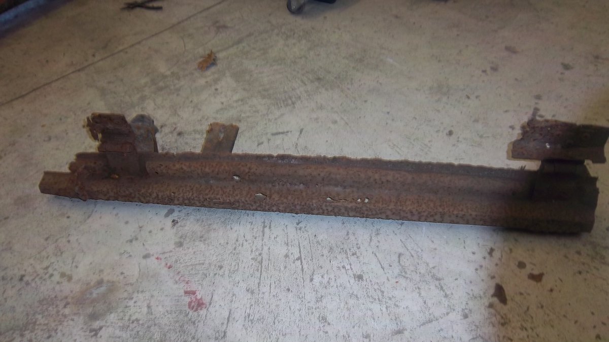

    OK, when the roof was on the car, it didn't give me enough info to plan out where everything was going to have to be located (B pillar, end of roof, end of quarter glass, etc) So I took it off, and tried putting the upper quarter panel pieces on it. A very bad thing is that these pieces are part of a 'load' I got a long time ago, and they were pretty rotted out. The bottoms of the tailgate jambs are non existent. One jamb just fell off the quarter piece when sandblasting it. It's going to make the mock up of this project very difficult! Even the real thick lower tailgate support is rotted out! 100_1044.JPG 100_1048.JPG 100_1047.JPG 100_1046.JPG

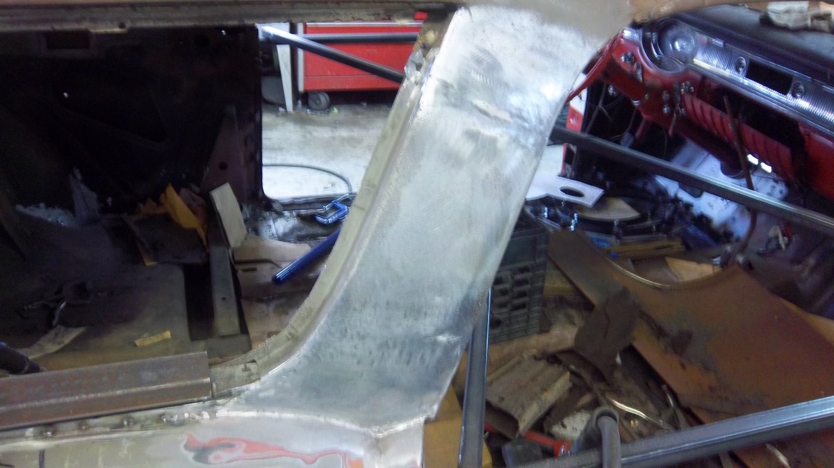

    After welding solid the A pillars, and the header support up front, I decided not to do all the sheet metal welding up there, and tie in the B pillars. Get it to the point where the roof doesn't have to be supported any more.
    The big debate was whether to keep the dip in the quarter panel. I was the one most against it. I thought it would compete with the B pillar for attention. The Chevy Nomad is straight across, even uses different doors, that don't have the beginnings of the dip. The quarter tops I used were actually from a Safari, and has a tiny dip just behind the B pillar.
    After thinking about it, I decided to leave it for now, I could always cut it out later if I didn't like it. So I made an inner support out of 3 pieces of 1/8" steel to tie in the door jamb support, to the Nomad one. Cut out the original brazed seam so I could butte weld it. Then a template and a filler skin for the "B". \Now I think I like the dip in the quarter. Keeps the Olds look and it also is a starting point for the Olds side trim (anyone got 56 Olds "98" side trim to sell??)
    Then the tricky part...putting the roof back on, and putting the upper part of the "B" in place, and slowly cutting it down to match the lower.

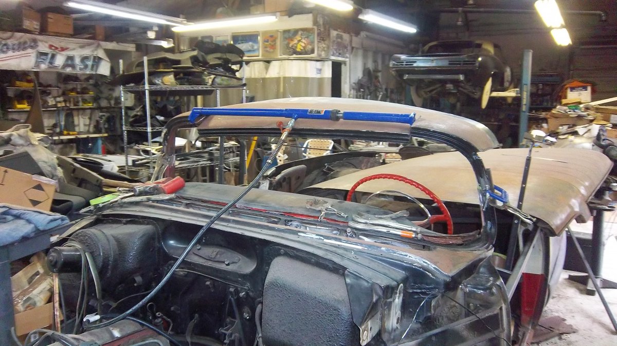

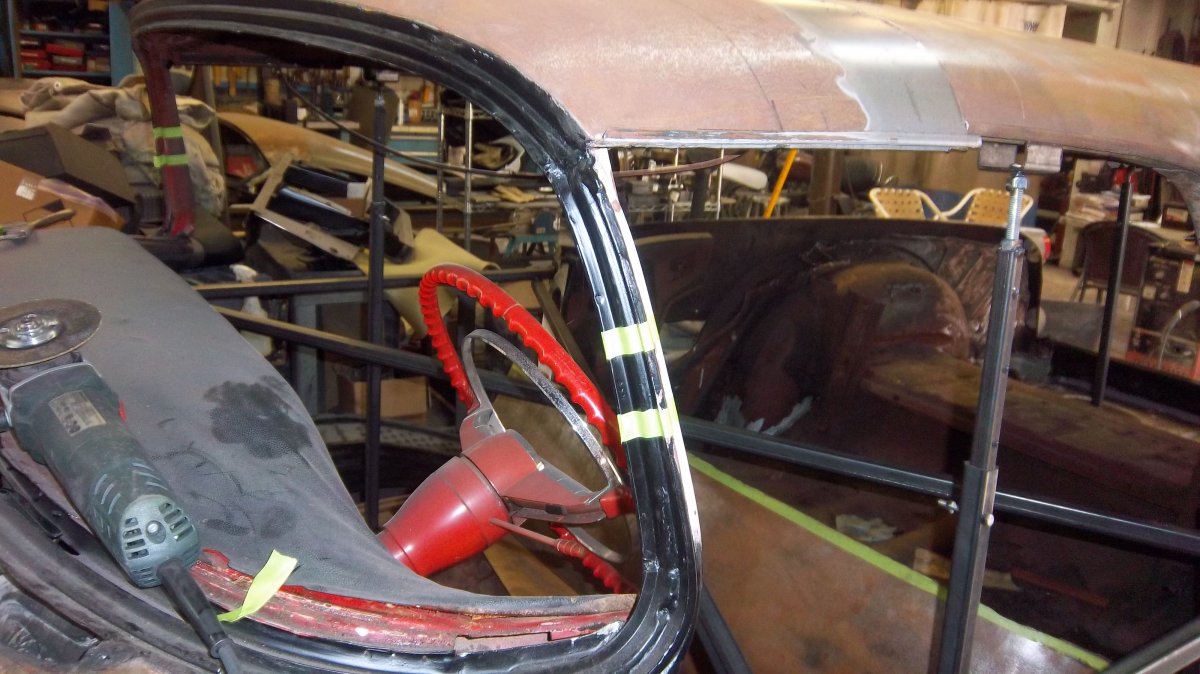

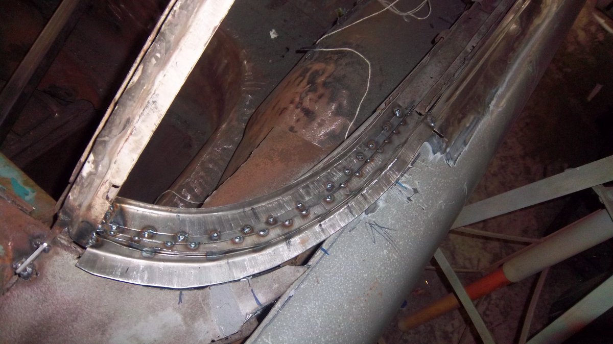

    Still on it. Went back to the front, to make it solid. Started with welding the front header support. Had to cut out part of the roof to get at the top part of it, but this NEEDS to be done. Also slowly reconstructing the Nomad window channels. 100_1078.JPG 100_1080.JPG 100_1081.JPG 100_1067.JPG

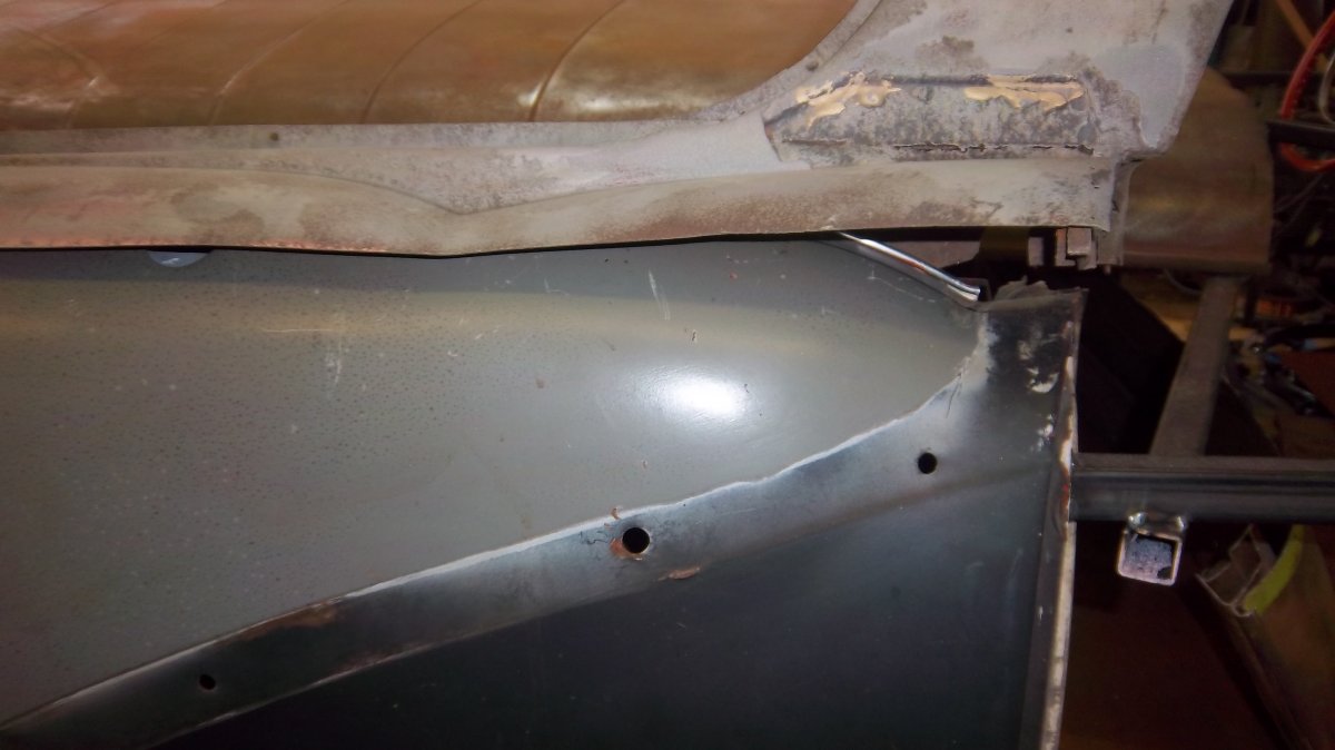

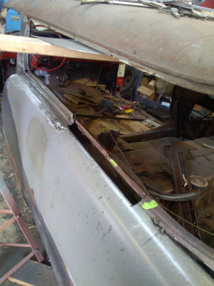

    Now we're just doing rust repair. Nothing exciting. I'll post more when we get to fixing up the rear tailgate area. Lots of sheet metal fab going on there! 100_1094.JPG 100_1069.JPG KIMG0039.JPG 100_1070.JPG
