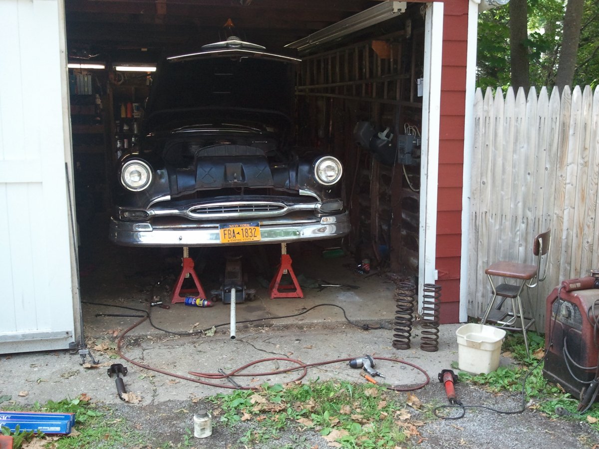

    About a month ago I worked up the courage to take out the front coils and cut them. I'd never done it before. I had to modify the spring compressor I rented from AutoZone with a longer threaded rod to get these tall beasts out of there. It was real slow going with that spring compressor too, so it took me all day.
    No going back now!! :eek:
    I didn't post this update on the HAMB sooner because I wanted my car club to see it first ... then I wanted to debut at a show! Anyhow here are the results:
    Anyone reading closely enough will notice that before I dropped the front, I thought the stance was "perfect." Boy, was I wrong, it's so much better now. All I need is another inch in the rear, maybe a little less. Then it'll be perfect.
    Frame sits about an inch lower than a soda can now. Remember, bags are for groceries!! And rich people who can afford them.
    I couldn't be happier with how it came out. Despite some pressure from my contemporaries to heat the coils and be done with it (yikes!) I held out ... I invested some time, cut them properly, and now the car still rides nice.

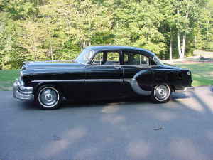

    Here are two photos for comparison: This is the total result of a tire change, fender skirts, drop blocks, and cut coils.

    The stance is nice, but don't cry or get angry at the car when those springs bottom out and lose what height they had. It's just the nature of the beast when you start cutting on something that was never meant to be cut.
    For now, enjoy it and hit up a Poncho person later when the funds are available and we'll direct you to a company that can sell you lowering coils.
    Glad you've not put that Chief out on the reservation.
