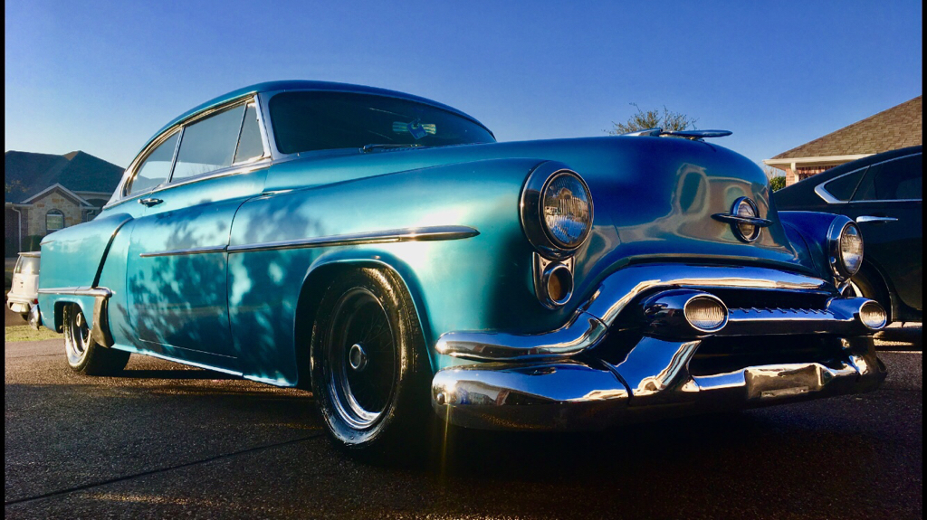

    So like I said, I hate posts without pictures, so here are a couple of new ones.
    Before and after of the wheels.the white walls are gone for now. Hoping to get new ones eventually (and real ones at that). After painting, I threw on some chrome trim rings I had from my panel wagon. [​IMG]

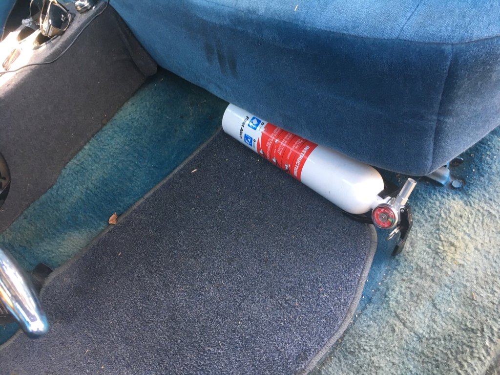

    Also mounted a fire extinguisher under the front seat for the trip to Austin.
    Picked up a spare tire as well for the trip.
    And currently don’t have the rear fender skirts on. Took them off to do some work, and actually kinda like the look without. Haven’t decided yet.

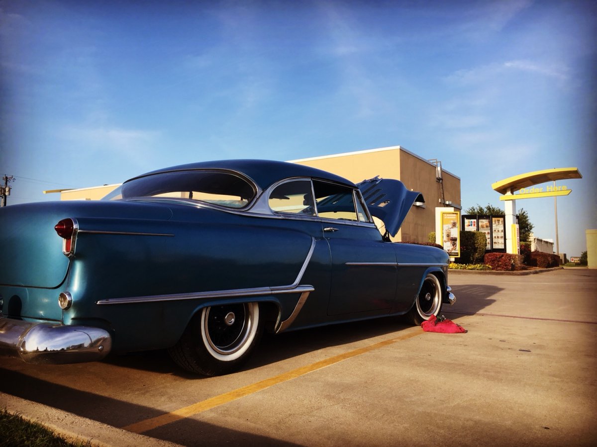

    We made it there and back again! Besides the weather sucking and so many people bailing at 3:00, we had an awesome time.
    We did have a hang up on the way back. I’ve been through my 4th fuel filter in the last couple months. I cleaned the lines a couple weeks ago and swapped the filter and fuel pump, but it’s obviously time to drop the tank and either clean it or swap it. I think Napa has one for about $90.

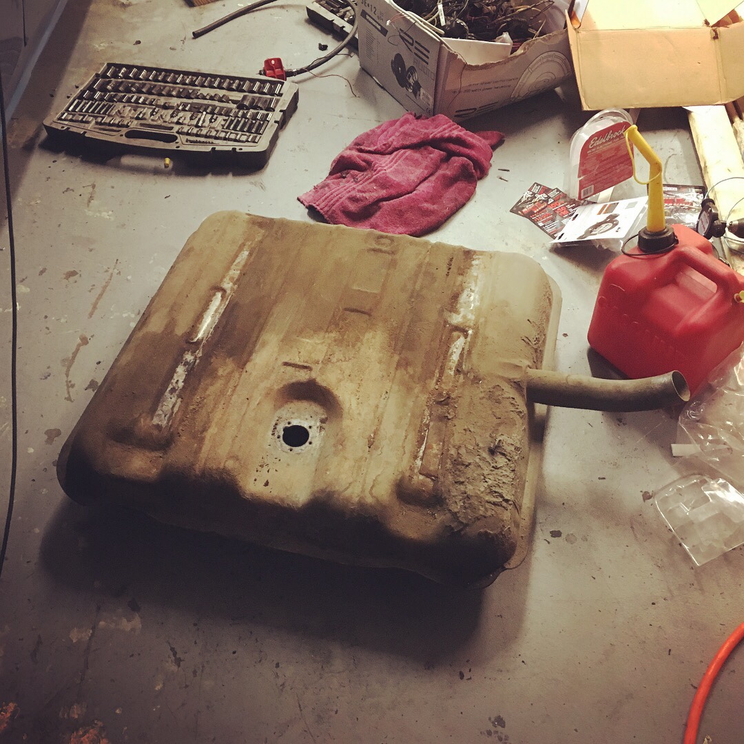

    I’ve got the mechanical working again, I’ve replaced the fuel lines, and now I’ve dropped the tank to get it cleaned and sealed. Hoping that takes care of me fuel delivery issues.
    Anyway, can’t drop off the tank at a shop till Monday. I’m having a kidney transplant in about 2 weeks. I’m hoping to have the car up and running before then. After the surgery, I can’t drive for a few weeks and can’t lift anything for close to 2 months.

    I haven't heard much from the shop that has my tank. I talked to them yesterday and they said it's not looking good. They put it "back in the vat." I have no idea what the vat contains, but hopefully it'll work. But, hope for the best, plan for the worst... A new Olds tank will run dang near $500. Are there any alternative tanks that might fit for less? It's just two straps holding in the tank, seems like something else might work.
    A 53 Chevy tank looks similar, but wider. They run a lot less. Thoughts?

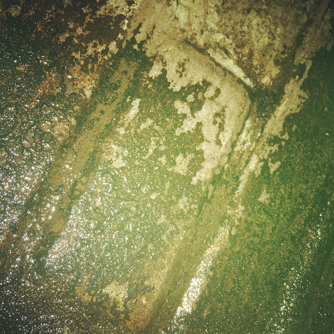

    Alright, so I’m still at a loss on the fuel thing. I need some help.
    Fuel tank is clean and back in. Mechanical pump is working, metal lines have been cleaned out, rubber lines have been replaced, and filter is staying full. After a few days, I’m still getting crap in the filter. Could the fuel be eating up the rubber lines that fast? It’s less than 3 feet of rubber at the front.

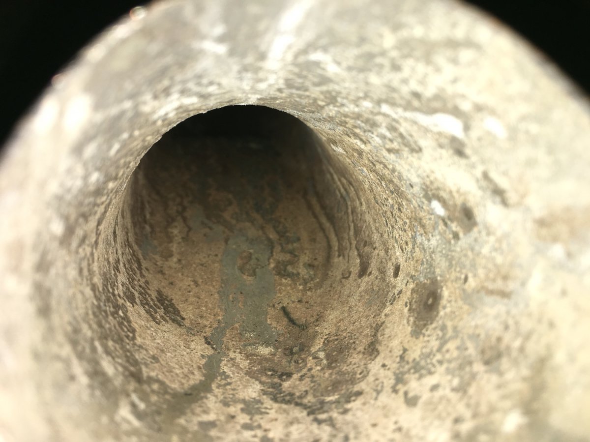

    I’ve got the plastic fuel filter up front. The rubber lines are new from O’Reilly’s. Rubber runs from frame crossmember to pump, pump-filter-carb. Rubber is all as short as possible, less than 3’ total, probably closer to 2’.
    Steel lines were cleaned with alcohol. After cleaning them, I used an electric pump through a filter to drain the tank. Filter stayed clean for 15 gallons till tank was empty.
    Whatever is in the filter is not magnetic.

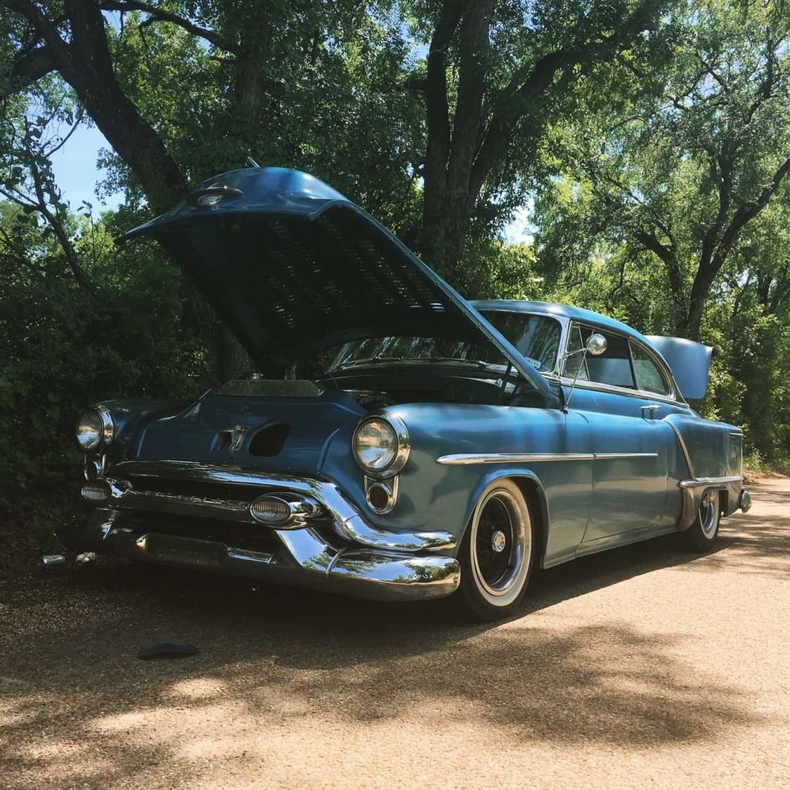

    Alright, so after lots of driving, I’m still having a few issues that are scaring me. Car hasn’t stalled out yet, but it’s come close several times. Here’s what’s happening:
    After cruising down the highway for a while and coming to a stop, fuel pressure drops to about 1-2 psi and the filter is practically empty, and the idle seems very rough. I let the car cool off for about 30-40 minutes, then I’ve got 3-4 psi and the filter is half full (or is it half empty? Haha). Still getting junk in the filter, but I think that’s a separate issue.
    My dad is convinced this is the problem:
    I’m not sure how that would affect the fuel pressure, but I’m willing to try just about anything now. What are your thoughts?
    On another note, fuel pressure never exceeds 5 psi, and is normally in the 3-4 range. Under heavy acceleration it’ll drop between 1-2. Is that about right?
    Thanks as always.

    See, that makes more sense to me. Everything on the engine gets stinkin’ hot. I pulled the air filter off to snap the picture, and I had to toss it on the ground because it was so hot. I checked out cool carb, I’ll probably order an insulator pretty soon. May try my dads idea just to rule it out.
