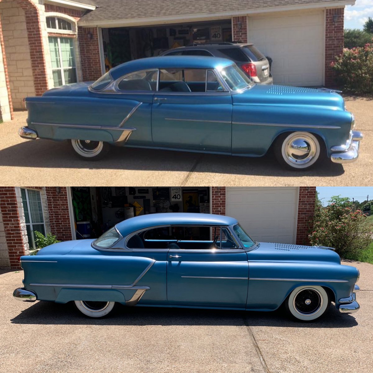

    Man, I kinda hate myself for what I’ve done to the chrome on this car. It was flawless when I got it. The rear bumper got nicked a year ago, and the chrome has been peeling since. The front bumper is also getting plenty of little marks now that I’ve been driving it so long. It sucks, but nothing to be done about it now.

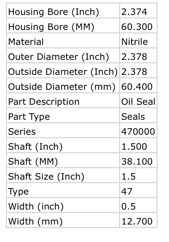

    Long story short, I need a new axle seal on the driver side. Not sure where to find a replacement. Here’s a picture of the one I’ve got now. I’d appreciate some help finding a new one. Problem is, I really don’t know what axle I’ve got.

  5. Try Olcar Bearing in SC. He has always been able to help me with seals and bearings..
    (910) 693-3324
    EnragedHawk likes this.
  6. Dick Stevens
    Joined: Aug 7, 2012
    Posts: 3,710
    Dick Stevens
    Seal should be easy, you have the part number right there on it, auto supply house can cross reference it.

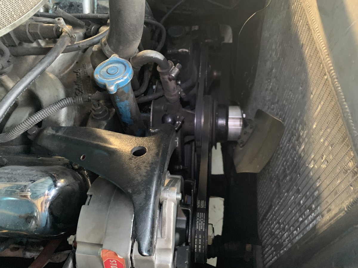

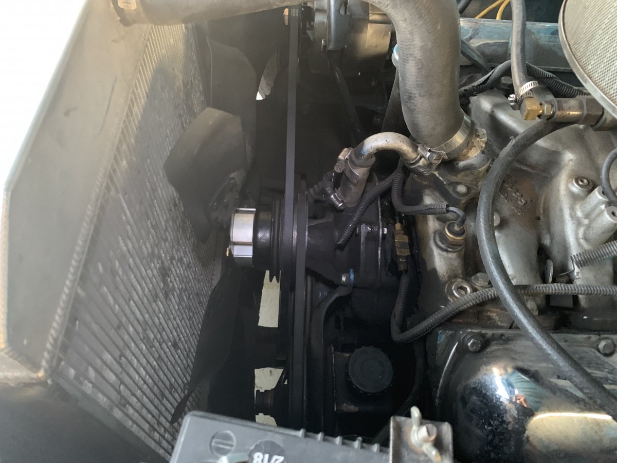

    7E4A2933-337D-42D0-A097-DEDABBA3F1C5.jpeg BCE2582A-996E-4B6E-B2DA-DF6EC4CF1115.jpeg

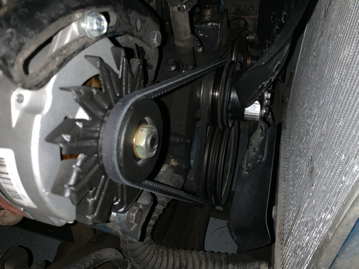

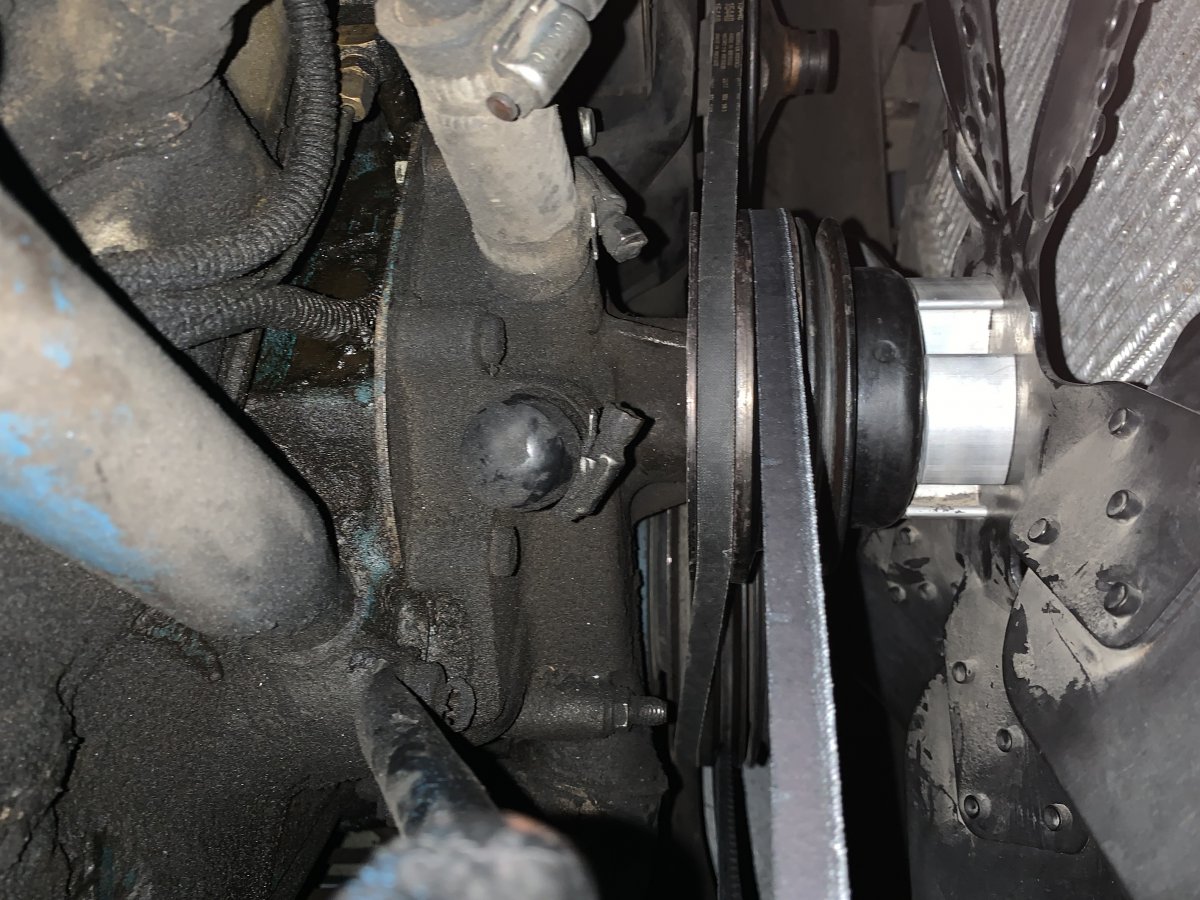

    Well, it was too good to last. :D
    A new/old issue has come up again. It’s an issue I knew about, but was never a problem till a week ago. Decided to take my kids along for their first “far away” car show (only an hour). And I chewed up 6 fan belts on the way there and back.
    So here’s the problem, the pulleys don’t line up. No idea how I got away with it for 2 years, but nothing I do will keep them from jumping now.
    Best I can figure, I’ve either got the wrong water pump, or the wrong Water Pump Pulley.
    I’m pretty sure I’ve got a “no ac” water pump. I think that’s the shorter shaft. I really really REALLY don’t want to swap the pump, but not sure I’ve got much of a choice.
    I’ve had a kidney virus a couple months now (it’s getting better!) but I’ve been pretty much put on garage probation, and I don’t have the money to pay someone else to do it. Is there a different pulley I could swap over to? Mine is sitting about a quarter to a half inch too far forward.
  20. Looks like you could remove pump, support the center of the impeller and slowly press the fan flange down on the shaft 1/4" or however much you need.
  21. MAD MIKE
    Joined: Aug 1, 2009
    Posts: 772
    MAD MIKE
    from 94577
    64-90 Olds had several different pulley and bracket layouts.
    There were two if not three different water pump heights, HD and Standard. For some reason I think the 330/425s had their own pump design.
    5-1/8" for non AC
    5-5/8" for AC
    Possibly, always check the shaft height between old and new.
    One other thing to note is that Olds didn't always use all the pulleys together, sometimes the WP or crank was bypassed when used with the PS, ALT or A/C. Or the grooves don't line up like you think they would, 2nd groove on a WP pulley does not always go to the 2nd groove on the crank and so on.
    From the looks of it it currently looks like the belts are all off one groove on the crank and need to be moved forward.
    PS pump looks a little crooked as well. The later Saginaw SPAM pumps used a two piece bracket, front plate and a rear triangular piece. They sandwhich the pump and then a spacer is used on the side of the block. 70's era accessory brackets really suck.
  22. EnragedHawk
    Joined: Jun 17, 2009
    Posts: 1,229
    EnragedHawk
    from Waco, TX
    So what if I just space the WP pulley forward? I’ve been playing with washers, and I need to go forward about 0.35”. Then I could use the second and third groove on the crank, then move the alternator forward. Is it safe to space that far out with shims? The shim kits I’ve found combine for a total of 0.25” usually.
  23. EnragedHawk
    Posts: 1,229
    EnragedHawk
    from Waco, TX
    Yeah, the pump is definitely crooked. I need to clean everything up and see where I can add a rear bracket.
  24. MAD MIKE
    Joined: Aug 1, 2009
    Posts: 772
    MAD MIKE
    from 94577
    I *think* the bigger problem is that the casting of the WP housing is different from AC to non-AC cars.
    It's not just a snout issue there may be a difference in the height of the bolt bosses that the brackets bolt too. Might want to verify that before changing things too much.
    Also looking at some earlier engine pics the belt placement is in different positions.
    Original engine pic shows the front WP pulley groove not being used, a few posts down the middle groove is not being used. Might want to take a look at some of your pics and determine why the belts are moved around.
    Check out this link
    http://www.2040-parts.com/original-...-455-425-v8-power-steering-brackets--i234070/
    Note the triangular T shaped piece. That bolts to the front bracekt, back of pump and with a spacer and a similar bolt for the engine mounts to the side of the engine.
    Adjustment of the PS is not smooth.
    You will need to verify what bracket you have as there are differences between AC/non-AC and BBO/SBO as the deck height changes head location, which is used to attach a stabilizer bracket between the front exhaust manifold bolt and the top corner of the front PS bracket.
    Confused yet?
    https://classicoldsmobile.com/forum...-steering-brackets-1972-cutlass-350-a-124005/
    Check out the above link to get an idea how the brackets go together. The following thread has a pic of the PS pump brackets mounted on the PS pump while free of the engine. You are going to need to locate and replace a few fasteners. Smaller bolts are usually flange headed.
    Normally the front bracket mounts to the WP via stud-bolts. It looks like in one pic the WP is mounted using just bolts. This will screw up the alignment by 1/4" on the WP side.
    With the correct brackets the pump WILL line up. It's a mess trying to figure them out at first but they do work... as long as the brackets are from the same engine/model.
    One other note.
    More fun.
    '80-'90 307 Olds brackets look similar, but the bolts that attach the pieces together are often metric. Don't try to force a bolt. If it looks like 1/4" and a 1/4" bolt doesn't fit, it is most likely a 6mm threaded hole.

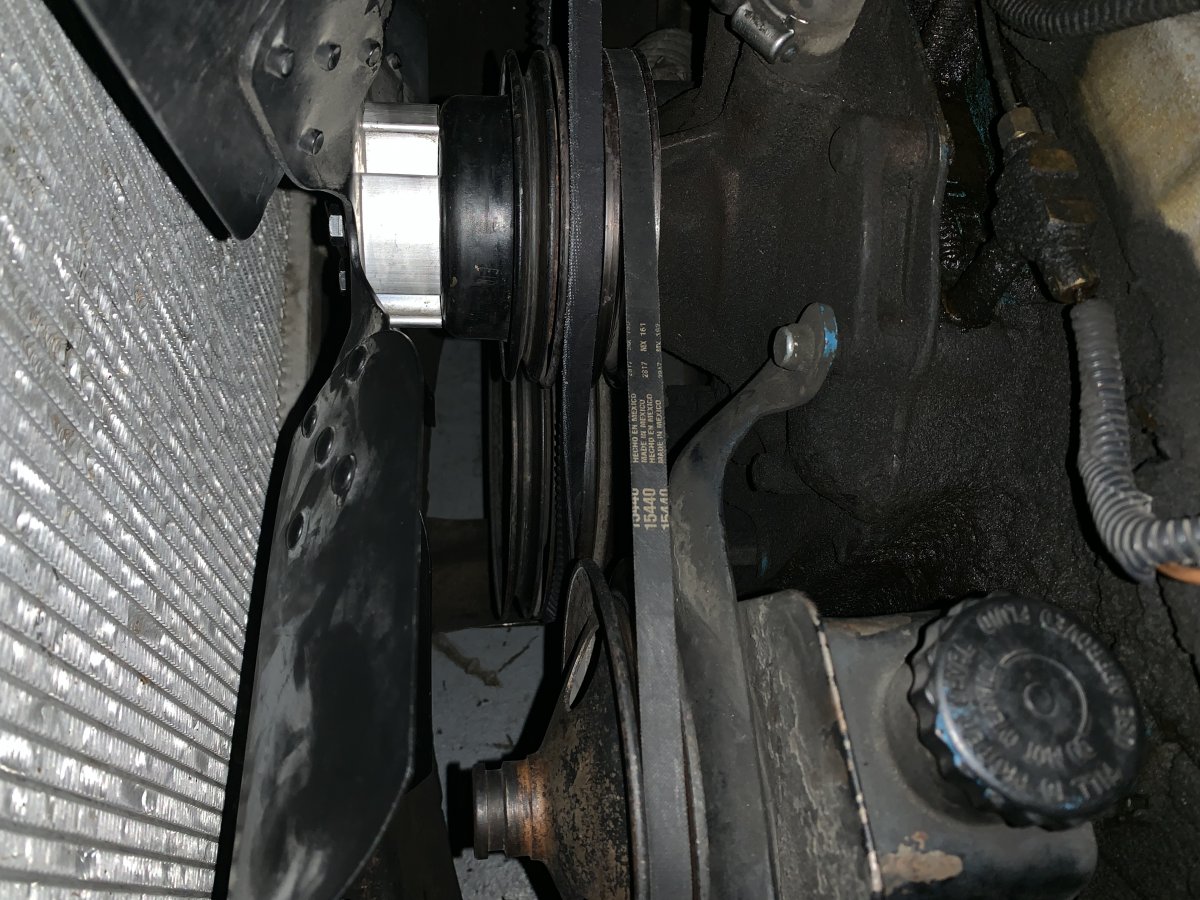

    I decided to try spacing the water pump out. It took a couple of failed attempts and new belts, but I seem to have it right now. Going to baby the car for a bit (mostly because I need a car), but I’ll hop on it at some point and see how it does.
    Here are some pictures of how it aligns now. I’m sure it’s not perfect, but as long as the belt doesn’t jump, I’m cool with it.
    A468CD0C-1D97-47BA-B8A2-80E324CCFB77.jpeg 30936090-F4AE-4388-8756-2731C0E4D4EB.jpeg
    AndersF likes this.
  26. Way to muscle through another issue Hawk! Great job. I was going to suggest shimming out the other pullies to line up with the furthest out one ...but looks like you fixed it...
  27. MAD MIKE
    Joined: Aug 1, 2009
    Posts: 772
    MAD MIKE
    from 94577
    Did you need to shim it out 1/2"?
    In future if you need a new pump GMB AL WP is a nice piece, takes a few pounds off the front of the engine. ~$30 from Rockauto.
  28. EnragedHawk
    Posts: 1,229
    EnragedHawk
    from Waco, TX
    Thanks! Hopefully it’ll last. Been driving it a little harder every day and the belt has been staying on fine. Taking it to a small show tonight about 30 minutes away, so we’ll see how it goes!
  29. EnragedHawk
    Posts: 1,229
    EnragedHawk
    from Waco, TX
    Ended up with a 5/16” shim. Couldn’t have gone any farther out if I had wanted to though. Bottom of the fan would have scraped the trans cooler line on the radiator. I’ll keep the pump in mind. Thanks again for the help!

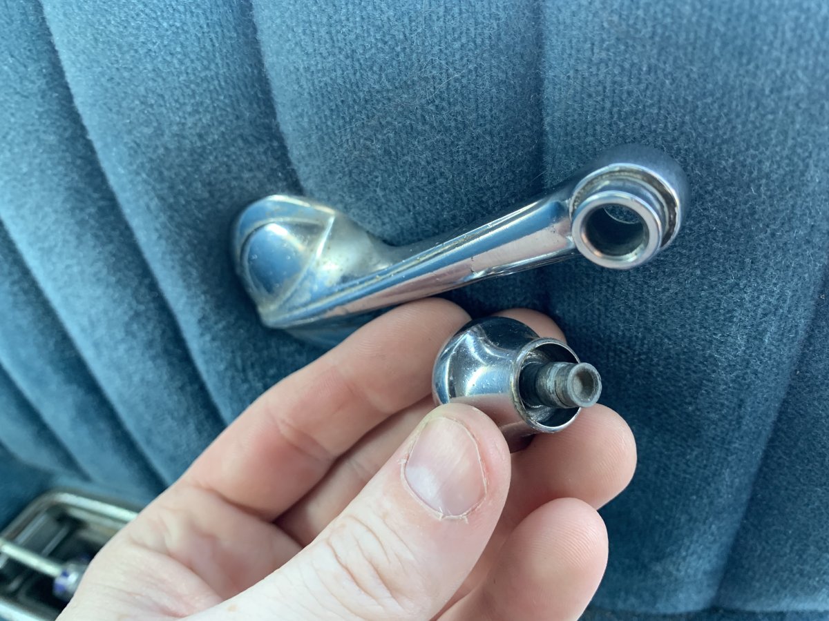

    While I’m here, anyone know how these go back on? I don’t see a clip or anything for them. I’ve had two come off the cranks for the windows.
