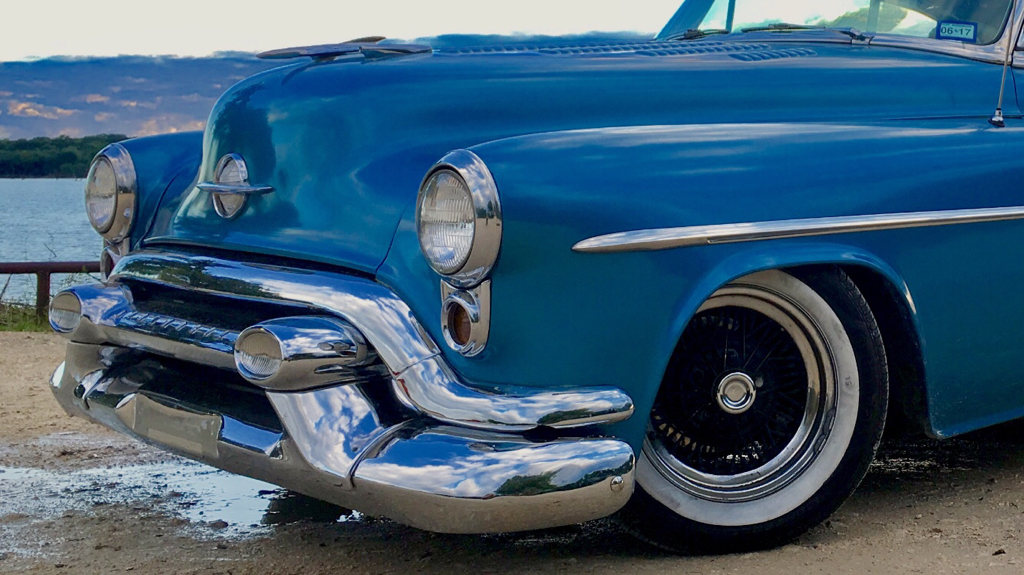

  3. Couple things.....the fuel sock may be getting covered with debris cutting down the flow. Are you still using that red Holley pump? Have you tried running itin the yard with a clean gas can and that Holley pump? How long does it take for the psi to start to tumble....in the yard or always on the road. Also, a very small pin hole in a pickup line will cause all kinds of issues.
  4. Nice Olds! What is your setup for a radiator? I have the same basic setup in my 50 Olds Coupe, but I can’t keep it cool. Mine is basically completely stock engine.

    The fuel sock is brand new because I didn’t have one before. Still using the Holley. I borrowed a new one from a friends and had the same issues.
    When I first started having issues, it would take about 30 minutes to start having problems. Fuel pressure would dive to 3 pounds and sometimes stall out. I’ve made a lot of changes over the last week and the problem is still there, but it’s changed.
    Now, fuel pressure will hold at 5.5 at idle with a minor bounce at the gauge. When I start driving, pressure will bounce between 4-6 psi. Hasn’t dropped below that yet. Doesn’t seem to matter what the engine temp is.
    I’m going to try and re route the fuel lines to the pump. It’s worked for 9 months, so I’m not sure why it would suddenly matter, but I’m getting desperate.
