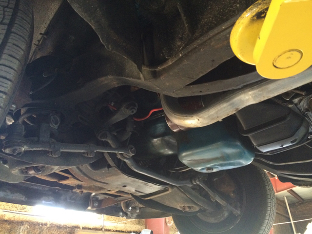

    I haven't checked out the brakes just yet. It's definitely under the floor. It feels as if there's no booster at all right now. The front flip has been swapped, so it has discs up front. Don't those require more pressure for stopping?
    If it has no booster, I figure I'll need to get a proportioning valve as well.

    Got her home today! Going to take care of title and registration in the morning. Took it for a small drive down the street. Look like there's a pretty bad oil leak I didn't see before. Hopefully an easy fix. Also, there's no booster at all, so what does that mean for me? Can I just buy one and throw it on?
