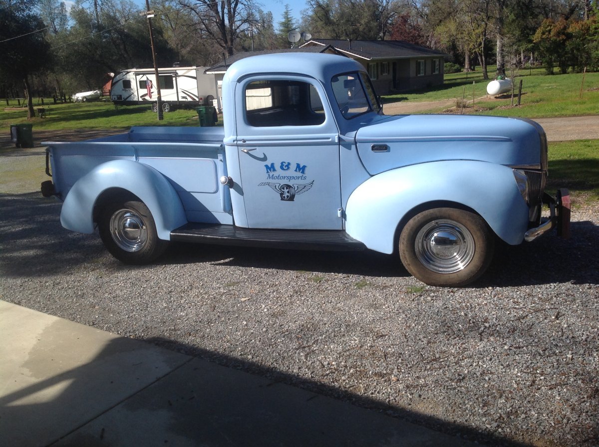

    IMG_0286.JPG Got the new project running, clutch linkage repaired and first road trip under its belt. Drives like an old Ford pick up and I love it. Wires went away. Have got wider rims for rear on the way. Next up redo all brakes and pull wood out of bed for refinishing.

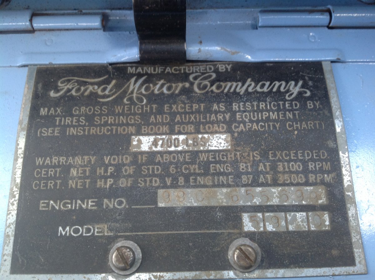

    IMG_0287.JPG There has been some question as to the year of cab on my '41 project. I have a clue and a question for those with Ford knowledge. Tag on inside of glove box (see pic) gives HP for 6 cylinder and V8. If memory serves me right in 1941Ford had a 4 cylinder or V8. Flathead 6 didn't come along until after WWII. If that's the case the cab is definitely later. Right or wrong? Thanks Mike
  3. studebaker46
    Joined: Nov 14, 2007
    Posts: 715
    studebaker46
    1941 was first year for the 6cyl hence different front crossmember, if your gastank was inside cab then your cab is 42 through 47 Tom
  4. Your number shows up as 1946 by sequential serial numbers on VanPelts site, BUT 59 C shows as 1945 model. 99 C is a V8.
    Confusing.
  5. Other than the gas tank and filler location, cabs are the same '40-;47. Bed and rear fenders are the same '38-'41, and '42-'47 is the same. '38-'41 pickup gas tank is the same as '38-'40 car and has the filler in the left rear fender. '42-'47 gas tank is under the seat and is the same as '38-'41 3/4 ton and 1 ton. '38-'41 mounts the spare tire on the passenger side, '42-'47 mounts it on the driver's side. Ford widened the pickup beds in '42 because more building material was being made in 4x8 sheets. A sheet of plywood will lay flat in a '42 or later bed, but the '38-'41 bed is only 46" inside width.

    Talking to the owner of one yesterday, he says the chassis was different from the ‘40 as it was set up to take any one of 3 options; 4 cyl, 6 cly, or V8.
    Either way, not many ‘41 pickups around. This is the only one that I’ve ever seen over here.
  7. 51504bat
    Joined: May 22, 2010
    Posts: 4,794
    51504bat
    Or the cab could be a 40/41 from a big truck, 3/4 ton or larger. Same cab but the big trucks had the gas tank under the seat.

    I think hotroda got it right, CONFUSING. Truck is legally registered as a 1941 and that's all that really matters to me. I can drive and enjoy. I may move that tank to the rear in the future with filler in bed, not sure at this time. Thanks 51504bat on headliner info. I had thought about the ABS alternative, just wasn't sure about texture. I believe they will send samples of the material. I'm not shooting for showroom original, just a clean driver. I appreciate the input from all.

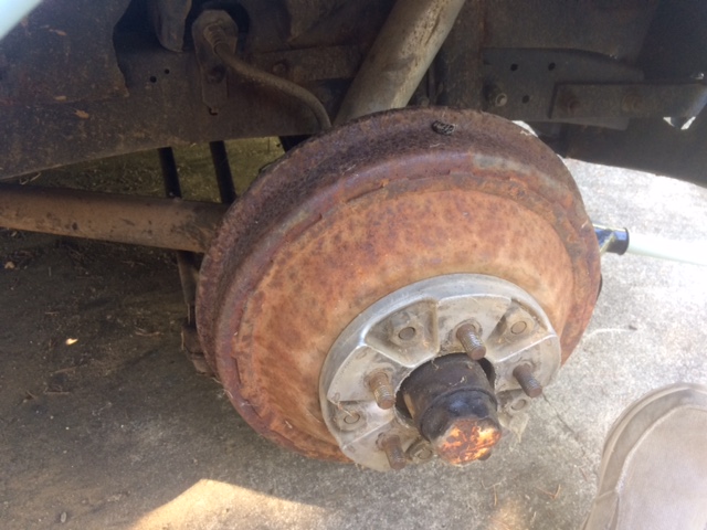

    IMG_2918.JPG IMG_2917.JPG Thanks to everyone for their input. First on the list are brakes and refinishing bed wood while still save able. Haven't decided on front brakes yet. Like the idea of rebuilding originals with a pair of Speedways repop Buick aluminum finned drums but by the time I figure cost in parts I think I could buy 2 disc brake kitso_O. The adapters in pic are gone and new studs were put in to go back to the 5 x 5 1/2 bolt pattern and brakes made usable so I could move it around. Thanks again

    Anyone want to venture a guess to what this rear came from? When I purchased truck I thought it was from a ranger pu. It has 4 bolt drums with adapters that were made by someone to put the 5 x 5 1/2 wheels on. No tags no #s stamped on tubes. I'm thinking mustang 2 or maverick. Plan on hauling drums and wheel cylinders to parts store and drive some counter guy crazy!
