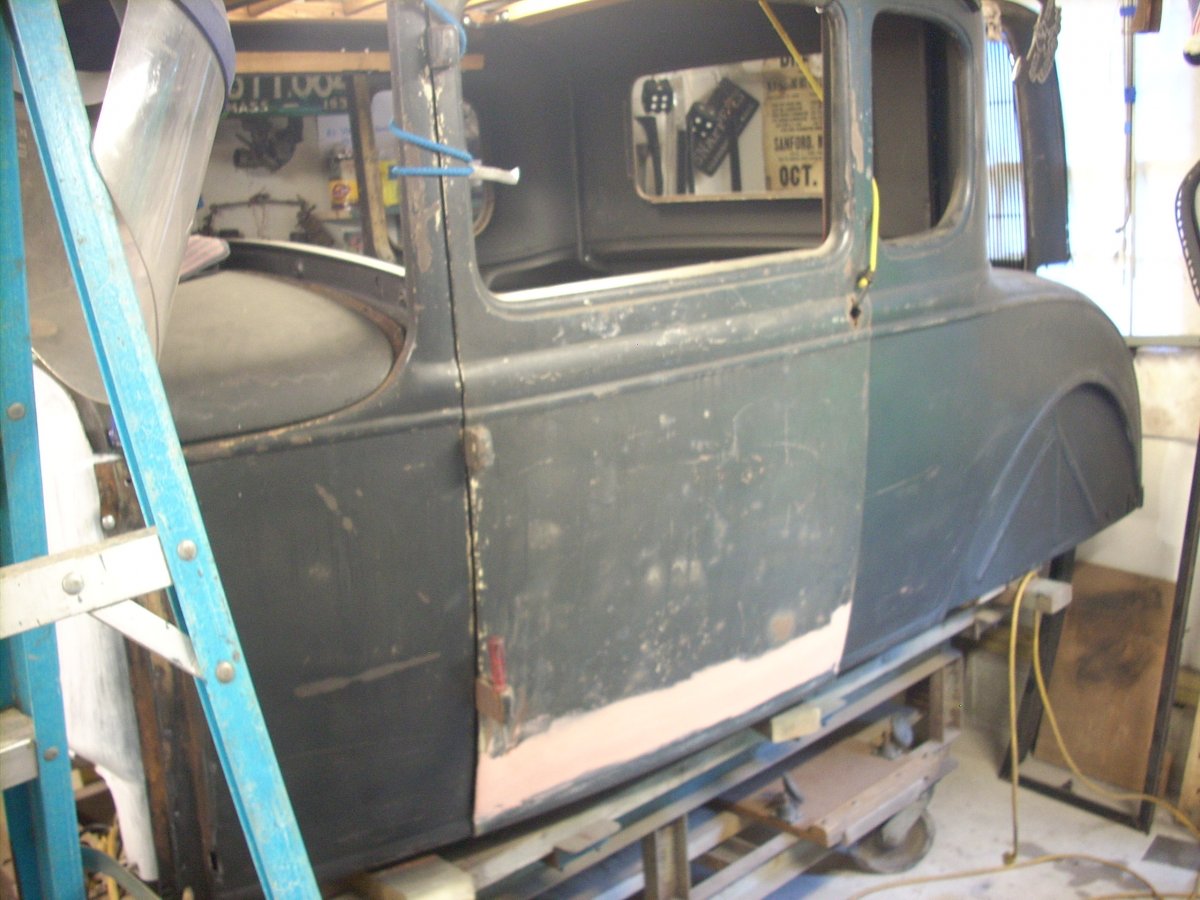

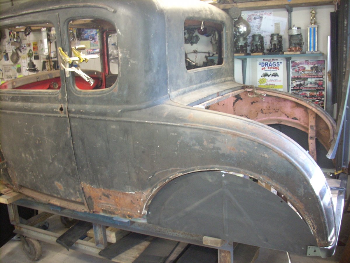

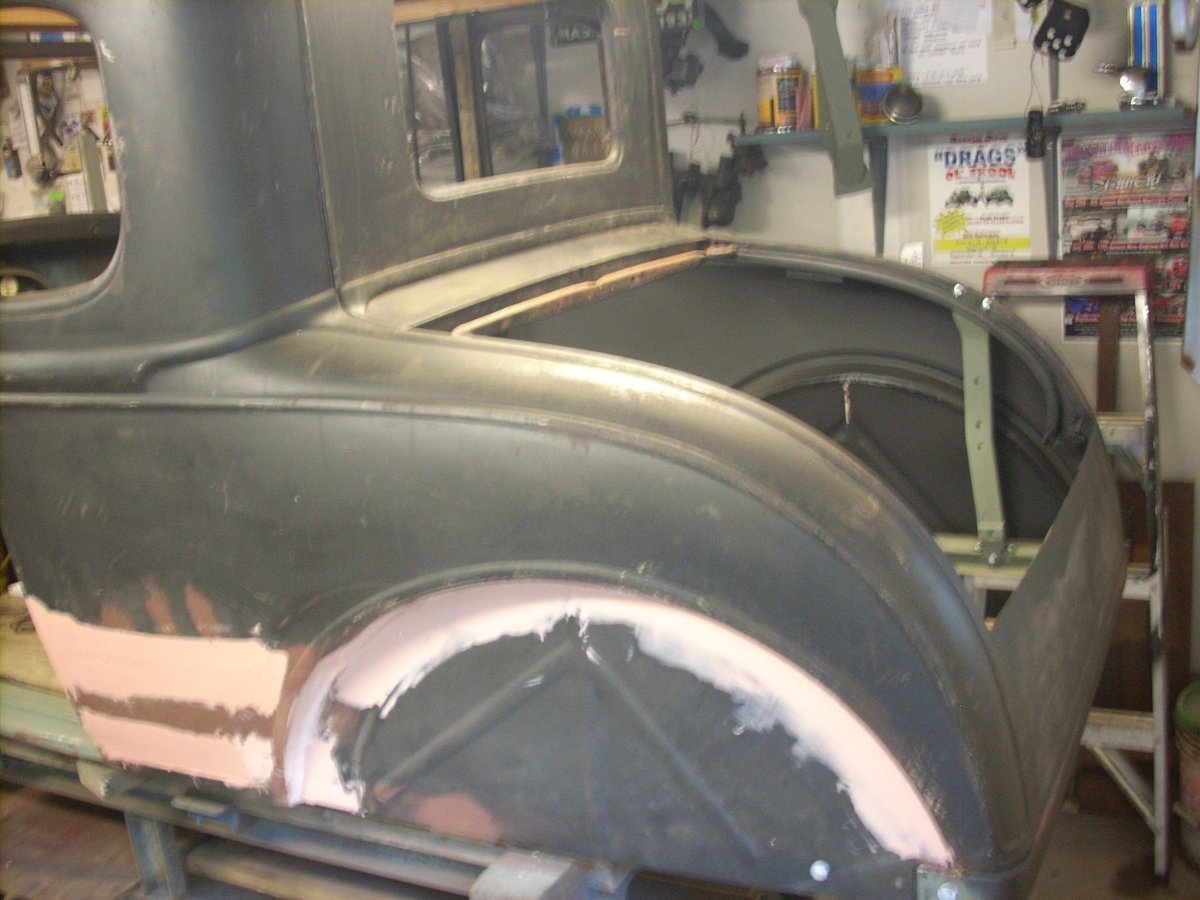

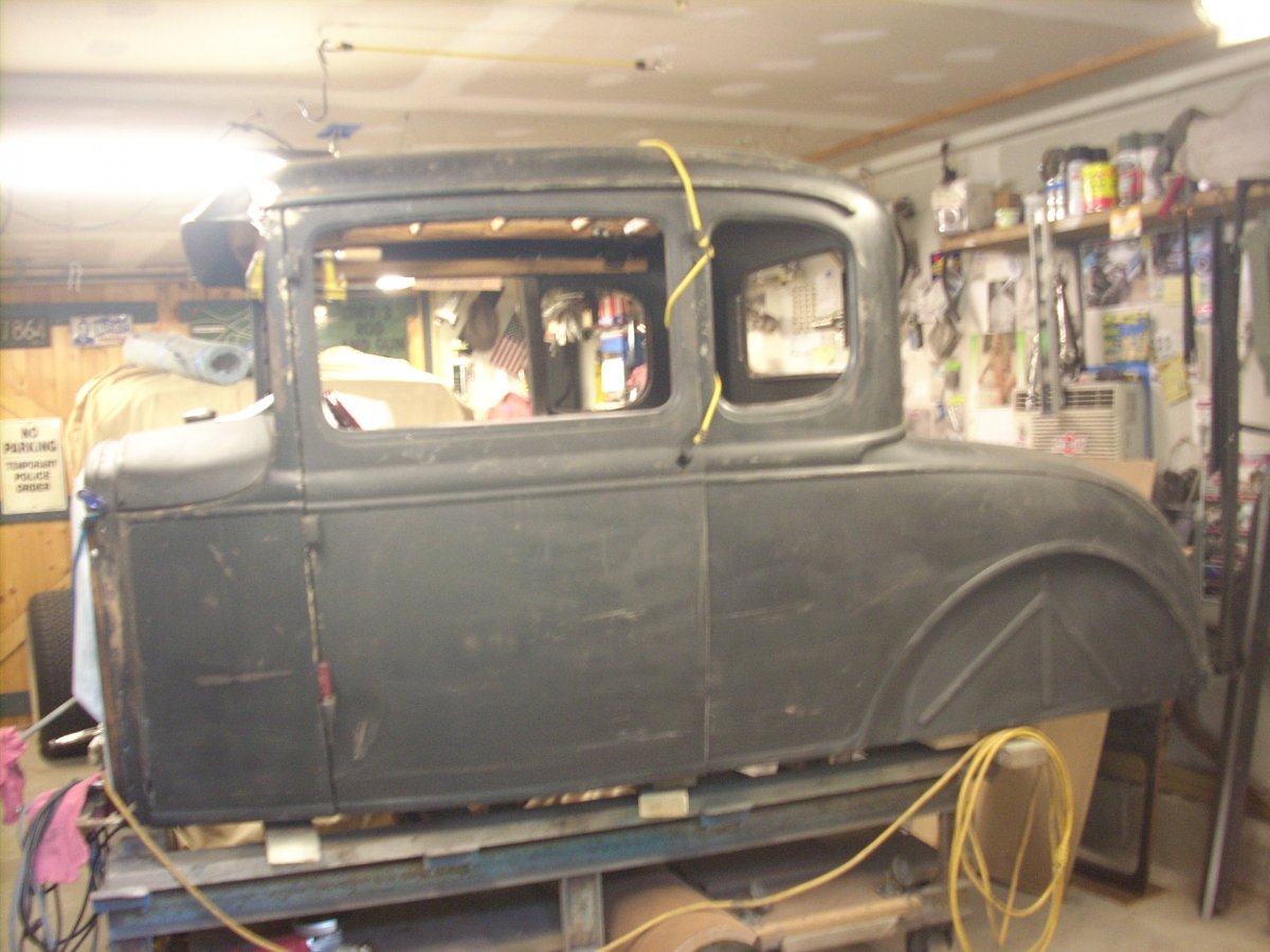

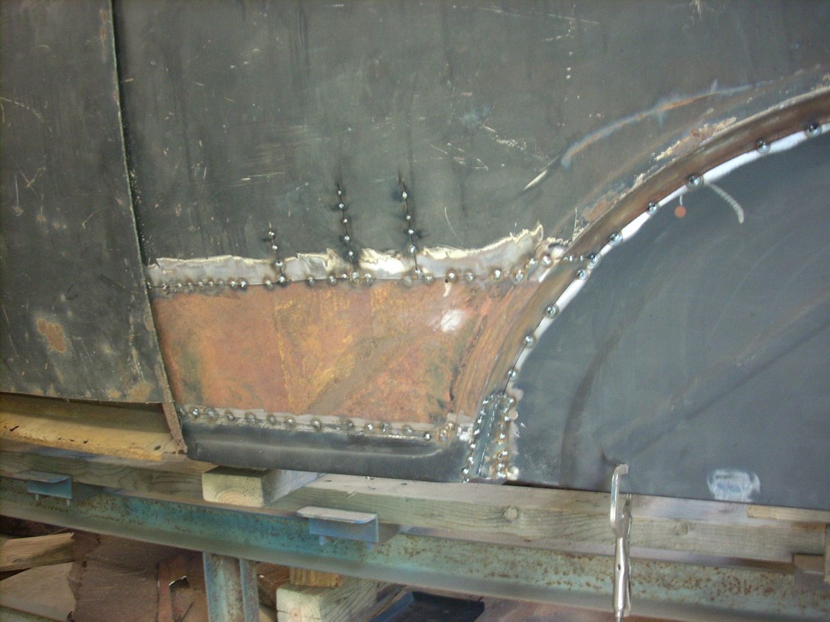

    Sorry, I'm a carpenter- I use Bondo. Such is life.
    Patched with original tin as much as possible, base coat Rustoleum Red Oxide primer, 2nd coat flat white Rustoleum, 3rd coat flat black Rustoleum. ( all applied haphazardly with "chip" brushes).
    When top (3rd) coat is tacky, wipe down with thinner very lightly, produce a few scratches and dings with a piece of jagged metal from the trash, and Viola!
    Looks mahvelous, dahling.

    But it's not "fake patina" - it's color matching/ blending ( unless you take a solid car and do the " red first coat, black 2nd coat, and sand through it ( barf). Which looks really crappy.)
    Totally different approach to try and match old finish.
    Everything's fake the minute you change it from the original if you look at it that way .

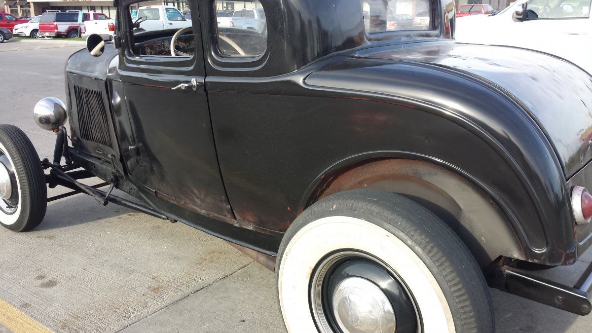

    Use lacquer. This was done in a weekend.

    image.jpeg Looks like a nice old hot today to me.....how much you want for it?

    The goal was to look like an old hotrod, so I guess goal was met, thanks.
