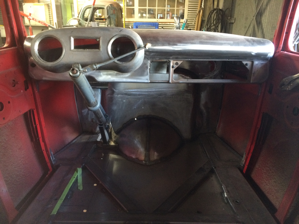

    49 Lincoln dash cut down to fit. Found a 50 ford column to thrown in the mix

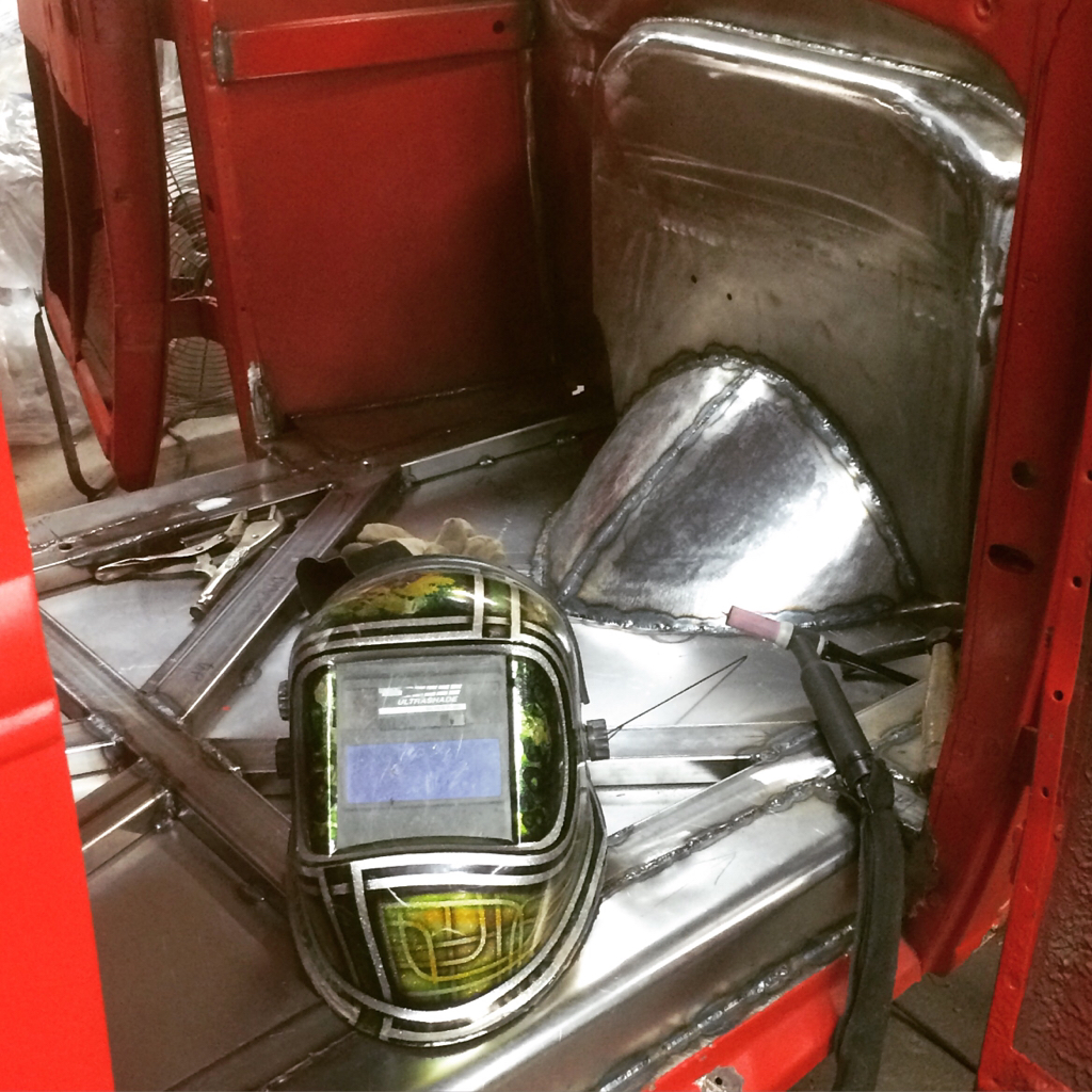

    That dash looks really good in there. Just curious, how heavy is the floor framing there - what thickness metal is it?

    It's box tubing the same pattern as the car frame with 11 gauge sandwiched and welded , between the car frame and the floor structure. It makes the body very stiff.

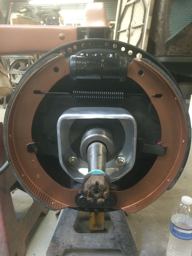

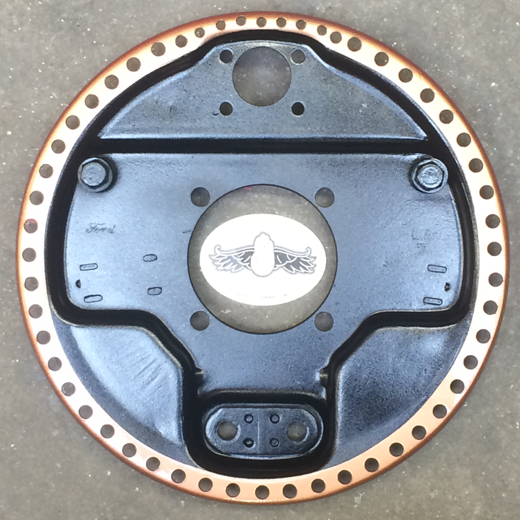

    Here's the new Rodsville quick change ( I had Logan Davis assemble for me ) with 36 bells and trailing arms , ford juice brakes.
    Looks great fully assembled and painted.

  22. Interesting build to follow; really like the details, especially the dash. Out of curiosity; I was wondering why you used front brakes (no E-brake) on the quick-change?

    Those were rears. I welded up the holes for looks of course.
    I'm running a B&M hydro no need for an e brake
