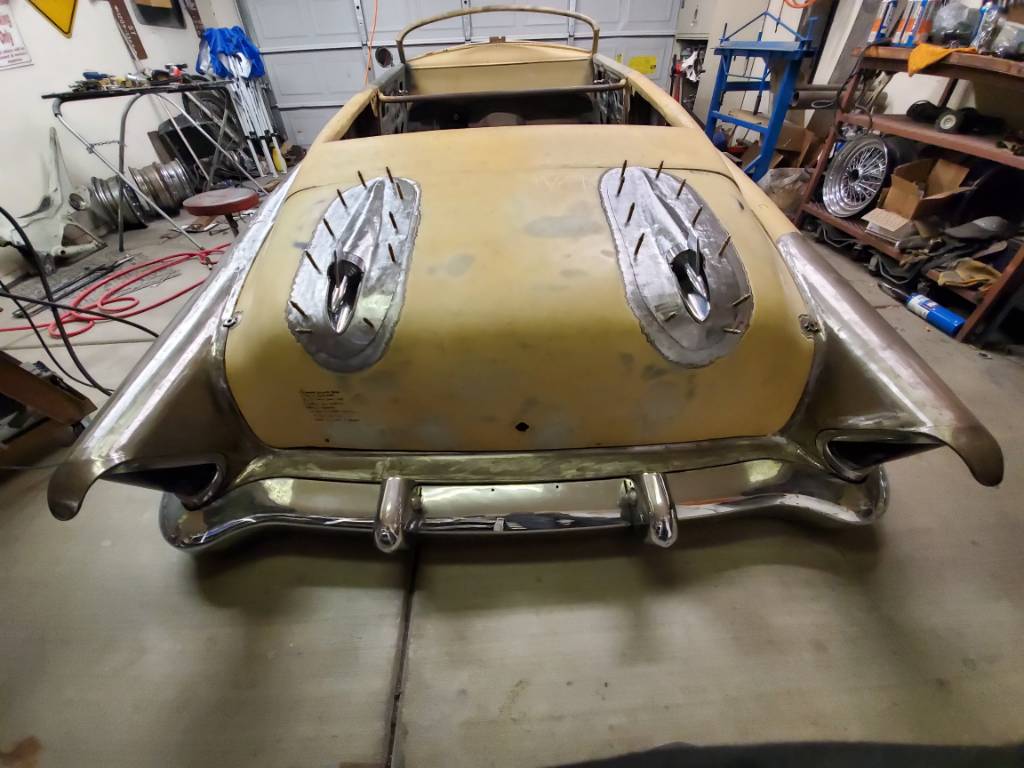

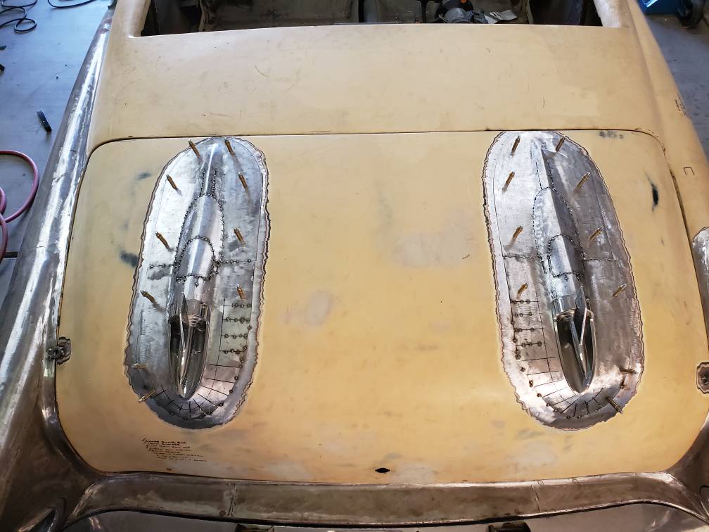

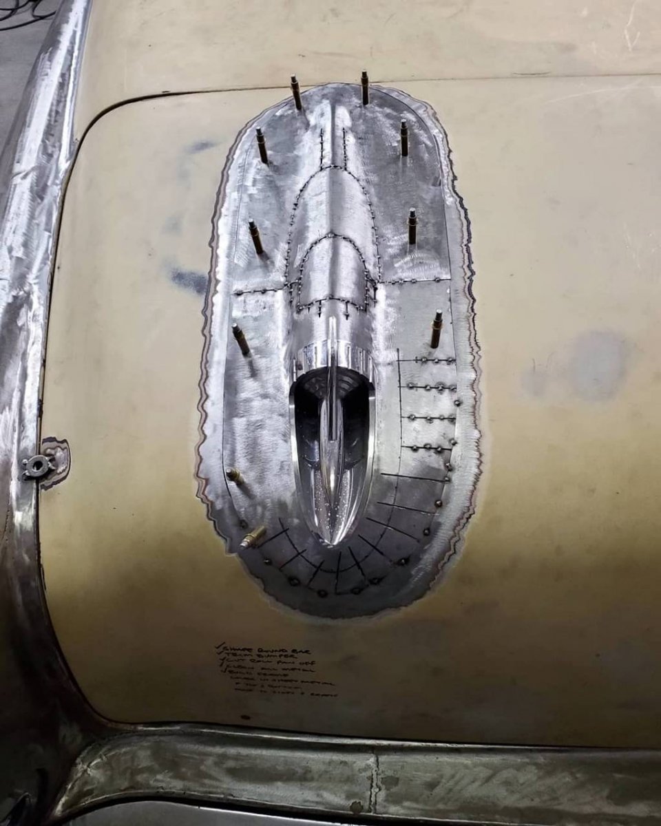

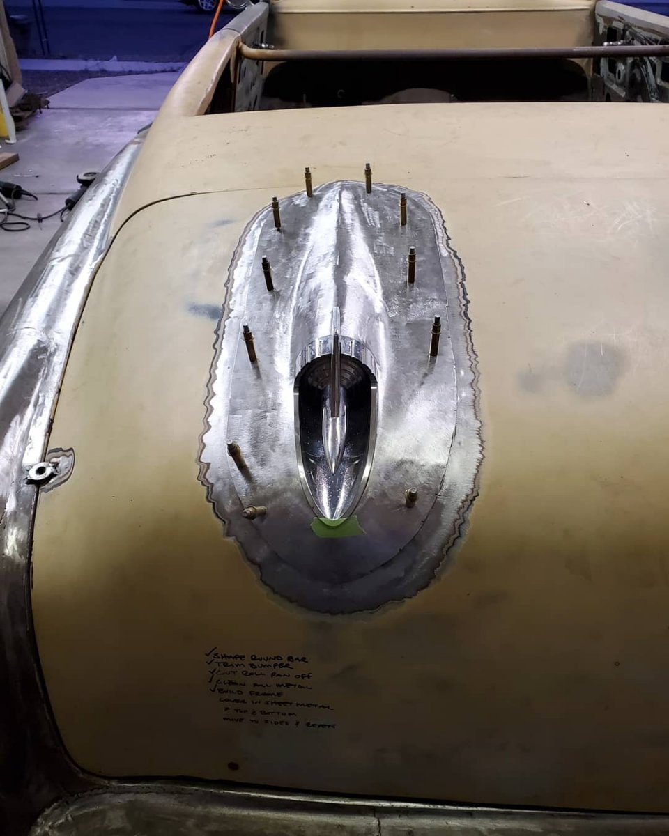

    57 Chevy hood rockets sectioned 20 inches. This took A LOT of work!! I had to completely reshape them. I used pieces that I cut out to reshape. 4 pieces of sheet metal on each side and a thousand pie cuts! It's definitely starting to look like a space age build! IMG_20191030_190816_176.jpeg 20191024_171728.jpeg IMG_20191030_190816_171.jpeg IMG_20191030_190816_173.jpeg 20191101_162026.jpeg
