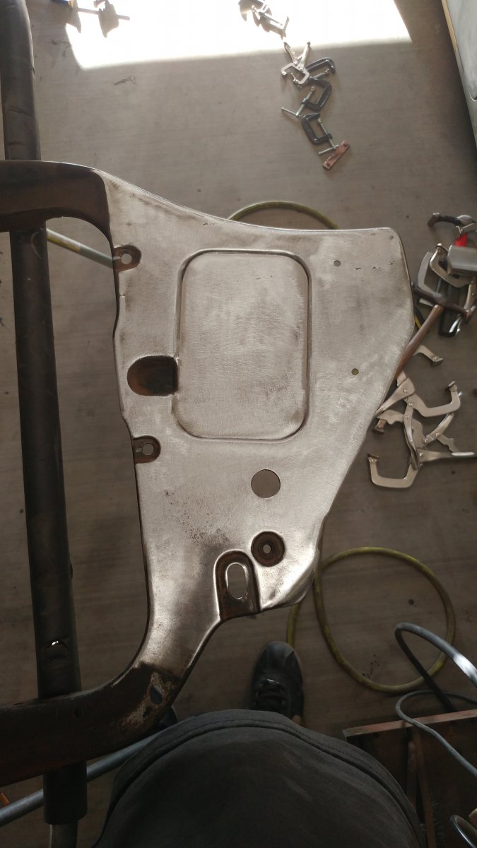

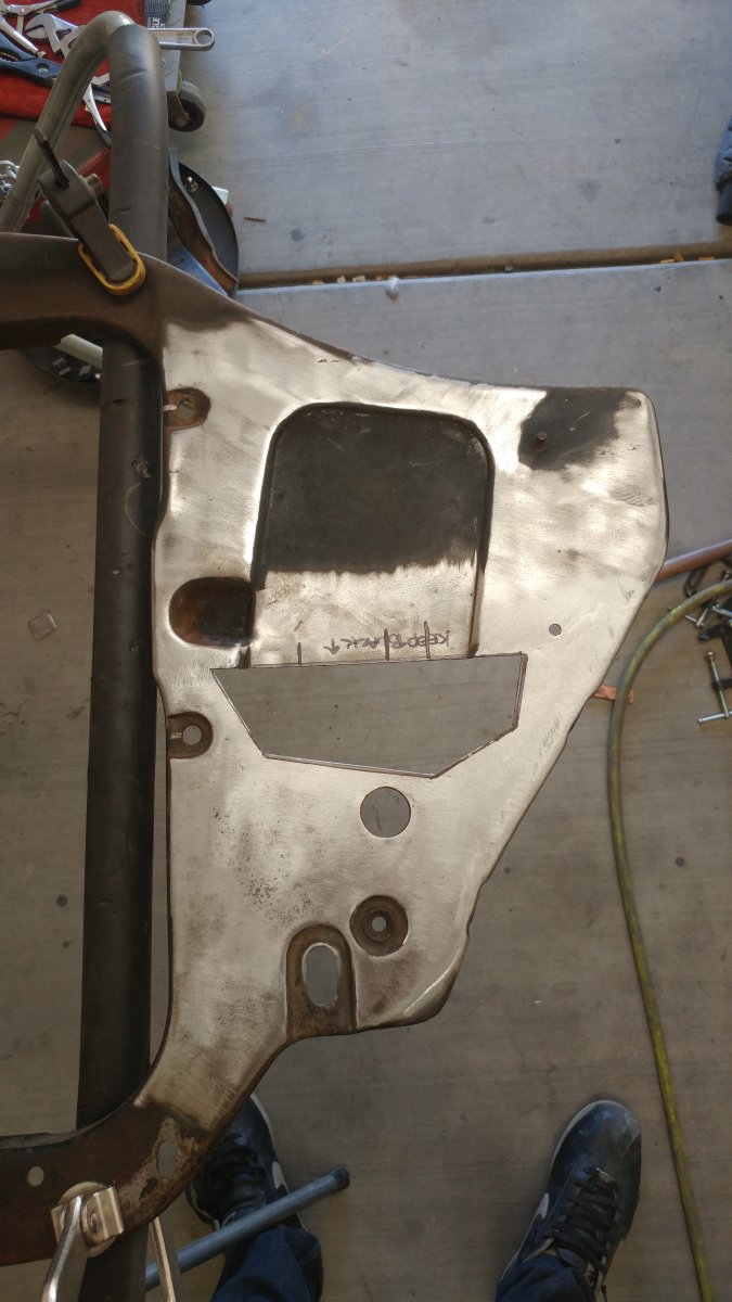

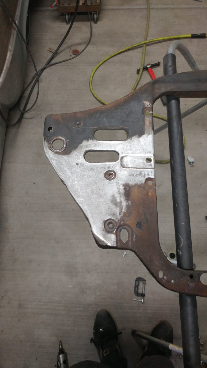

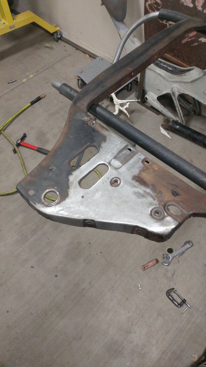

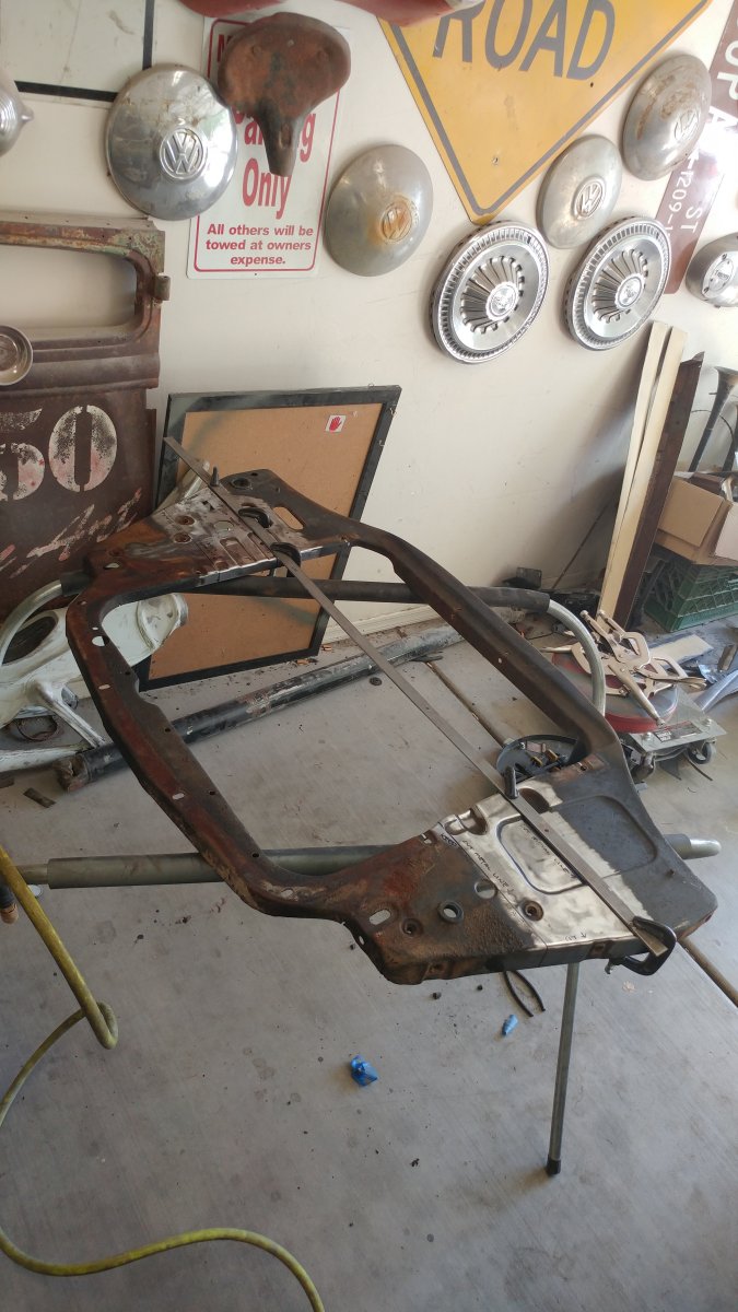

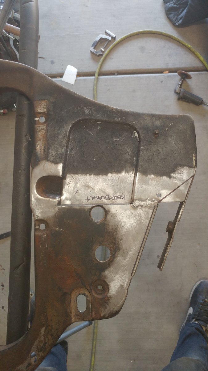

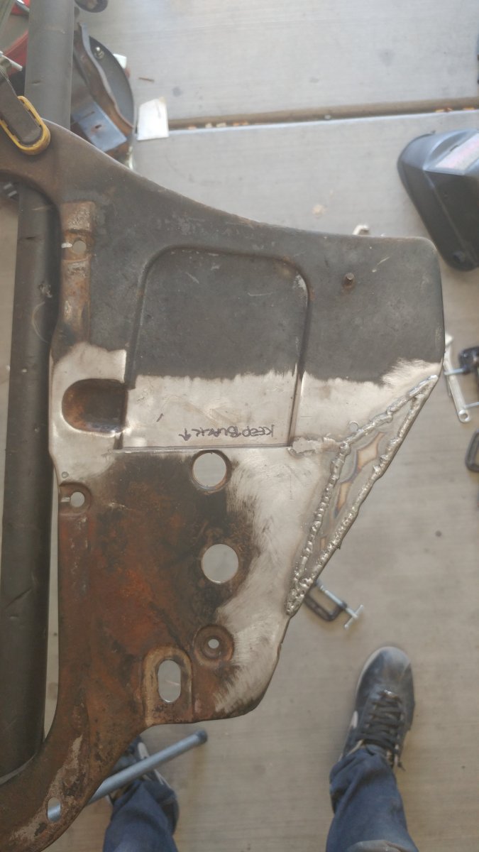

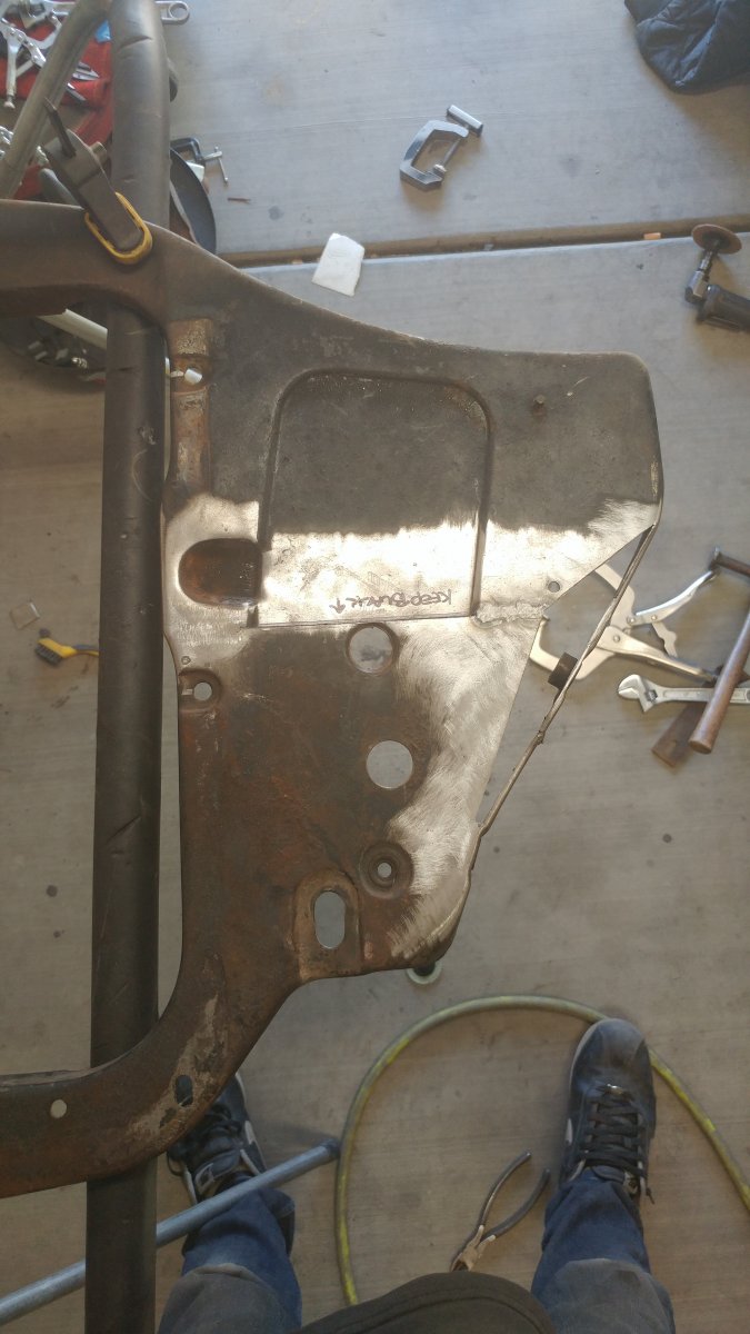

    Taking 4 inches from the core support 20180915_140633.jpg cuts made 20180915_152057.jpg section removed 20180915_152125.jpg outter core frame sectioned 4 inches 20180916_162216.jpg sectioned core support. 20180916_170913.jpg 20180916_170918.jpg 20180916_170947.jpg now to attack the sides. After taking 4 inches out, you can see nothing lined back up. 20180919_102146.jpg bringing sides together. This changed the angle as well. This bring me problems later, but it had to be done. 20180919_115146.jpg cutting out the shitty areas that didn't line up 20180919_142550.jpg and sectioning in new pieces, using old pieces 20180919_173604.jpg this half is done 20180919_173610.jpg 20180919_173618.jpg now for this half. Planning my cuts 20180920_102651.jpg bringing edges together 20180920_110951.jpg filler piece 20180920_113921.jpg welded 20180920_131034.jpg ground 20180922_111452.jpg filler piece welded 20180922_135923.jpg old cut out 20180922_121704.jpg old pieces sectioned back in and ground 20180922_165224.jpg done now Sandblast and primer. And move onto the next set of problems. 20180922_165309_HDR.jpg sorry for the delay everyone. I'll try to update more often and include a ton of pictures.
