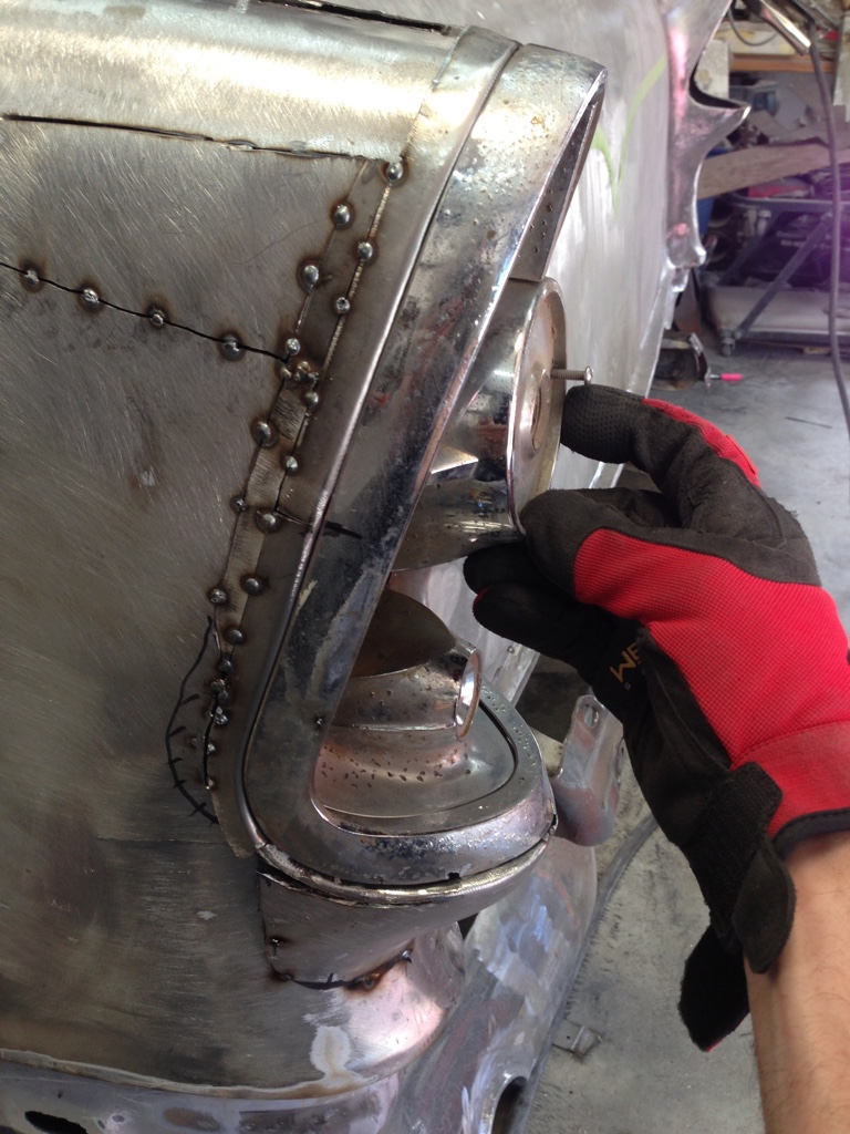

    Man just went thru this whole build, gotta tell ya your doing some killer work. It's funny I did a very similar treatment to the rear end of a 55 chevy convertible for the shop I work for. I did 56 tail lights with one piece lenses and tucked and frenched a wagon bumper. Even made a new body line just above the number to give it something to tuck into. I won't highjack your tread with a bunch of pics, I'll just show one. I only have one tail light done in the pic to show the difference. [​IMG]

    That's Awesome! What did you do with the old taillight sections? I wanted 55 tails on mine so bad. 56 was what I had.

    Well I used the lower half the old section or the stock 55 housing, did some reshaping and moved it lower. The rest of the tail light surround I had to make from scratch. I used to have a bunch of pics of the process but not sure were they are. I did a crap ton of custom work on that car. The left side tail light is motorized to swing out of the way for the gas filler neck. If I come across those pics I'll share them with you. Get back to work your making some killer progress!
