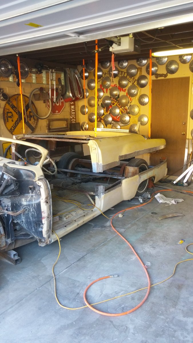

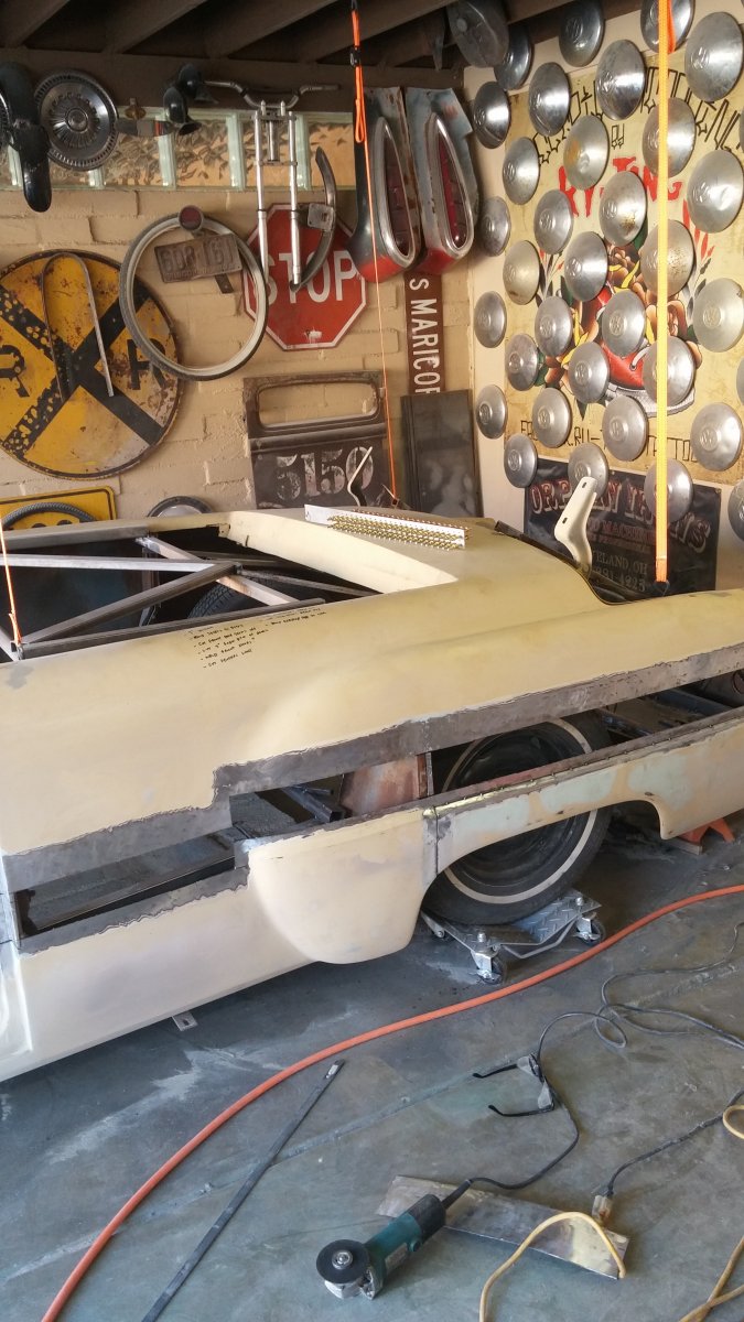

    The long cuts made

  24. rytang
    Joined: Jun 29, 2016
    Posts: 449
    rytang
    from Arizona
    Lifted in the air. Made final cuts and grinding easy.
