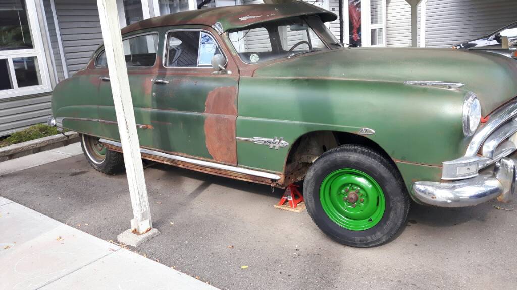

  5. OK so quick update......been having trouble getting the car to start well till I noticed that there was quiet a bit of gap between the top of the spark plug and the boot . so I loaded it up with dielectrical grease and she fired right up and ran pretty good.......except for all the smoke hahahah hopefully she will settle down once I can get her to run for a hour or so . now I'm back on the breaks and tires .. got 1 rim sanded and painted and some new to me radials put on with my 50 dollar tire changer!!! that's all for now :)

    I love those tire changers. Got mine for$34 on sale with a coupon. Saved myself a lot of money doing my own tires. I have the bubble balancer also. Sure can make you break a sweat though.
