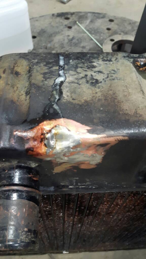

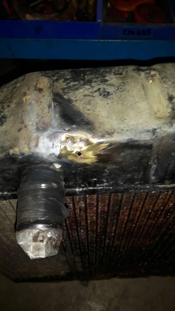

  4. Well I faked up lol took my rad to my shop to try and blow all the shit out . Also filled in with vinegar and water then drained and rinsed with water and baking soda ....got a lot of crud out but I noticed a small leak from a small crack. Well I thought a remember reading of fixing cracks with braise . And since I'm always braising wire rope at work on thought I would try but I failed . Had my oxy ace torch turned way down and still managed to melt a hole . Now I wondering if I should have soldered it .......any advice guys ???? What type of solder should I use

    Take an old man's advice. I've had friends in the radiator repair business for a long-long time, and the more you try to DIY the worse it's gonna get.
    Take it to a competent radiator shop, get it rodded out and repaired correctly. A good cooling system is important.

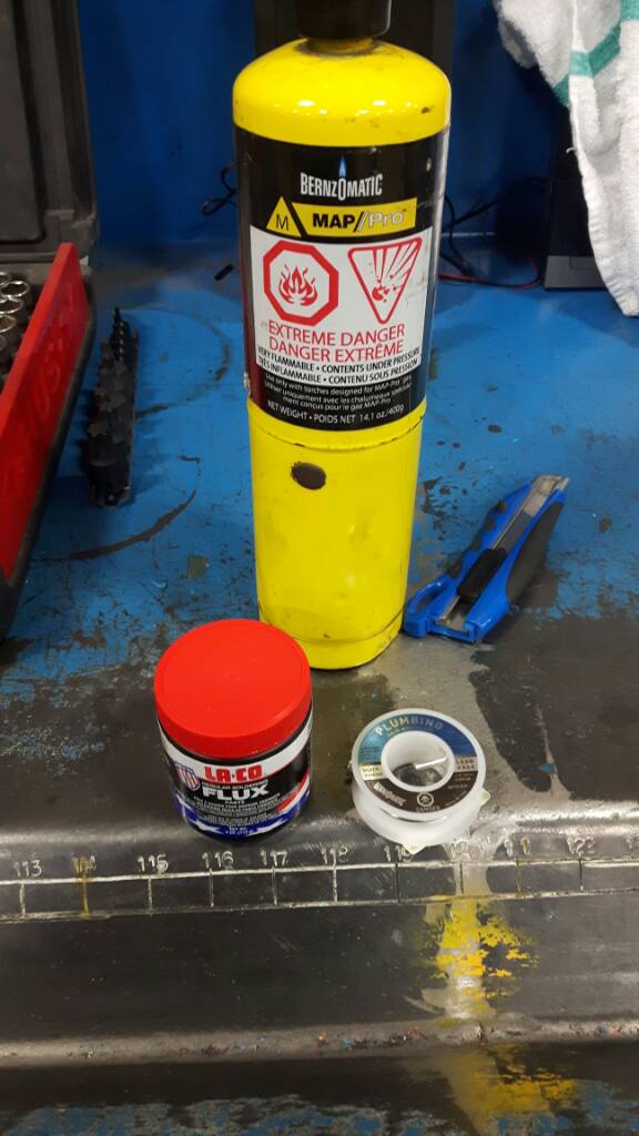

    Brass patch maybe? Use a small $10 propane torch and lots of pre-tinning flux. If you aren't well versed at soft soldering, do what D.O.M. says above.

    Well at least you're now talking about solder rather than brazing. Also forget about the suggestion to get a propane torch and use the OA torch with a slight "feather",or rich flame. In this case a propane torch is difficult to get the heat exactly where you want it, and since the flame is not as hot, it takes longer to get the spot you want to solder hot and heat is spreading to areas where you don't want it to go!
    If you can find an old scrap radiator and use it for practice you'll be better off than trying to learn on such a rare radiator as on that Hudson. I spent a lot of tome around that radiator shop for lots of years, and believe me it ain't as easy as the guy whose shoulder you're looking over makes it look.
    Good luck.

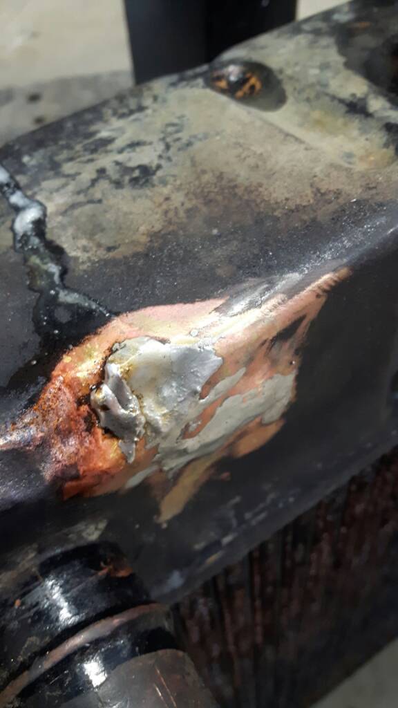

  10. OK got it !!! Not the prettiest but It's holding . Going to paint the whole thing tomorow

    If you have the hole stoppeed up that's all you need.:)
    Never tried MAPP gas, have heard it's hotter than propane. Does it require a different torch?

  17. No I think it's the same style for Mapp or propane . I had it at work so I thought I would try it. Propane I think would be easier to control . Mapp got hot quick like o/a . I was scared of burning another hole thru

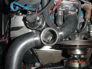

  20. I'm thinking maybe of a coolant filter like this on the return line of the heater hose . But how do I filter rad before it gets to the engine

    The one you posted will keep stuff from the engine out of the heater core. I think you want something to keep crap out of the radiator.
    I had one of these on my '64.5 Mustang with an inline six. I think they can be found at places like Summit Racing, Jegs, and probably Speedway Motors. You'll need to know your hose size. Most of these can be disassembled and cleaned out with solvent and compressed air.

  24. Awsome!!!! That what I want ...maybe both hoses...I think my rad has gunk I don't want in the engine and my engine has gunk I don't want back into the rad lol

    Great effort on the radiator repair. MAPP does burn hotter than propane and you could have gotten it done with propane. I have repaired several radiators using a good ol' benzomatic. Looks like ya done good! Knocking out the "opportunities " one at a time! Progress is progress no matter how fast or slow it's going forward. Carry on!
