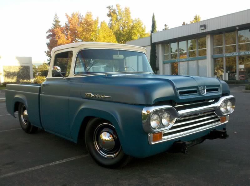

    Hey guys I'm new here.
    I just picked up a 1960 Ford f100 truck is running very clean body i picked up in Turlock Ca and drove her home. I was looking all over for a 59 Fleet side Chevy when i came up on a picture of a 1959 ford i fell in love with how it looked like a BOX
    I'm going to start a build thread on here some ware just don't know what i put under!
    I have a lot of plans for the truck i just orderd the Front end from FATMAN mustang 2 front im going to bag the truck and i want to put some white walls on it.
    I also orderd the rear from a shop called gambino kustoms called the Tail dragger
    I should start everything this weekend and hopping it will be done in 3 months

    Much better cab than the 59 Chevy, good choice. Looks like a nice straight old truck. Not too crazy about the smurf blue front end tho.
